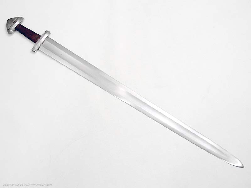

Weight:2 pounds, 10 ounces
Overall length:37 1/8 inches
Blade length:30 3/4 inches
Blade width:2 3/16 inches at base
Grip length:3 5/8 inches
Guard width:3 3/4 inches
Point of Balance:5 inches from guard
Center of Percussion:~20 inches from guard
Oakeshott typology:Type X blade

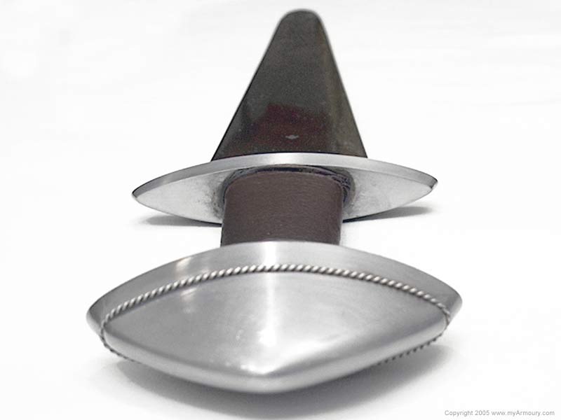

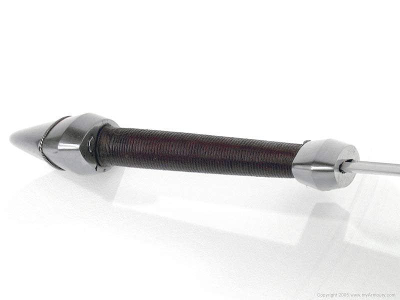

Viewing the sword from the pommel end
This sword was an absolute joy when used for cutting. As one should expect in a properly made Viking-style sword, it has a great deal of blade presence. The tip section is quite thin and is entirely appropriate for the type. Against light targets, it is the best sword I've ever used. Cuts were effortless, easy to control, and highly effective. The mass in the blade near the tip actually seemed to propel the sword during a swing. Once it was up to speed, the blade presence was barely noticeable. This sword would produce devastating cuts and slashes against historically outfitted warriors.

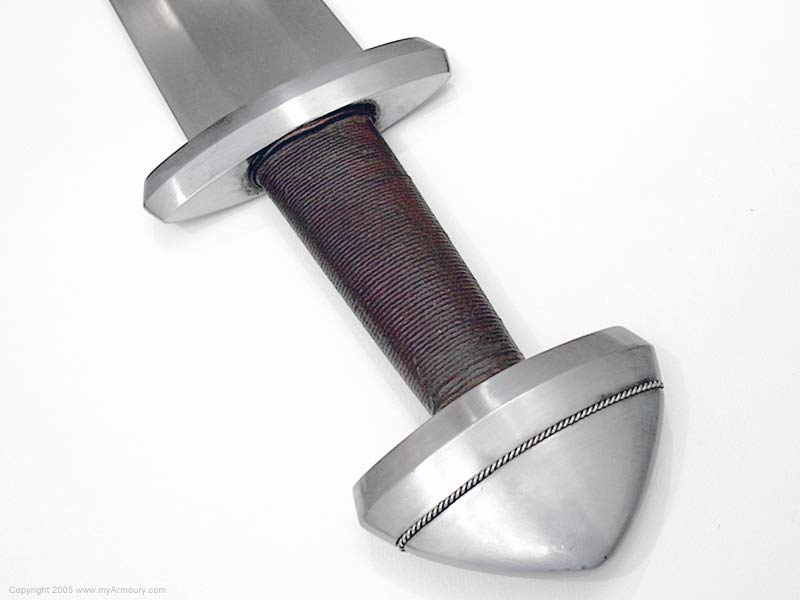

In the hand, it was comfortable when held in the handshake grip (where the hand is not at a 90-degree angle to the grip). This grip allows the pommel to slide by the heel of the hand as it should. Neither the pommel nor its wire wrap irritated my gloved hand at all. The 3 5/8" long grip is large enough for my big hands; it didn't feel cramped at all.

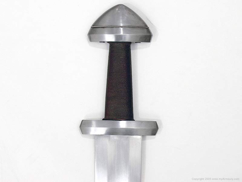

Detail photo of two-
piece pommel with
its decorative wire

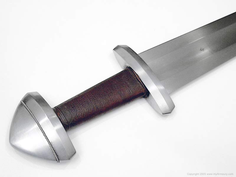

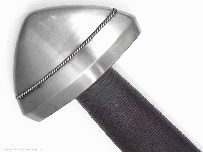

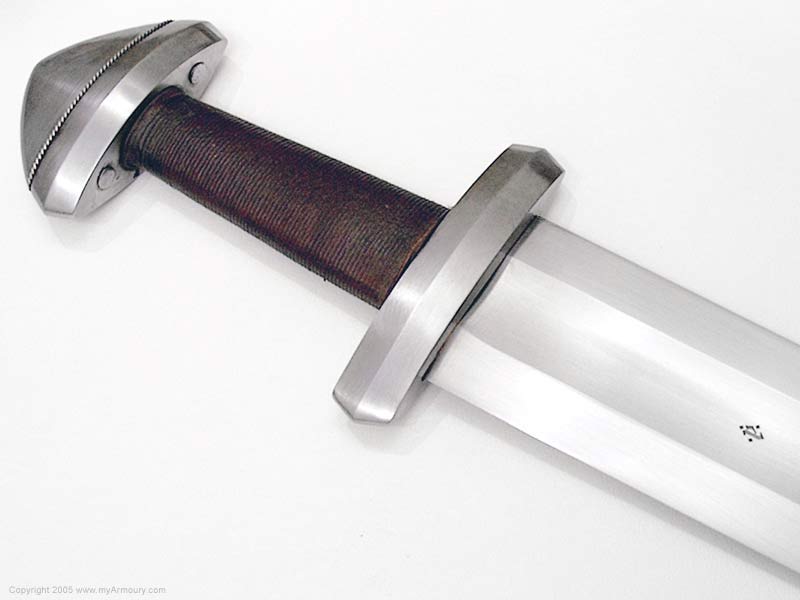

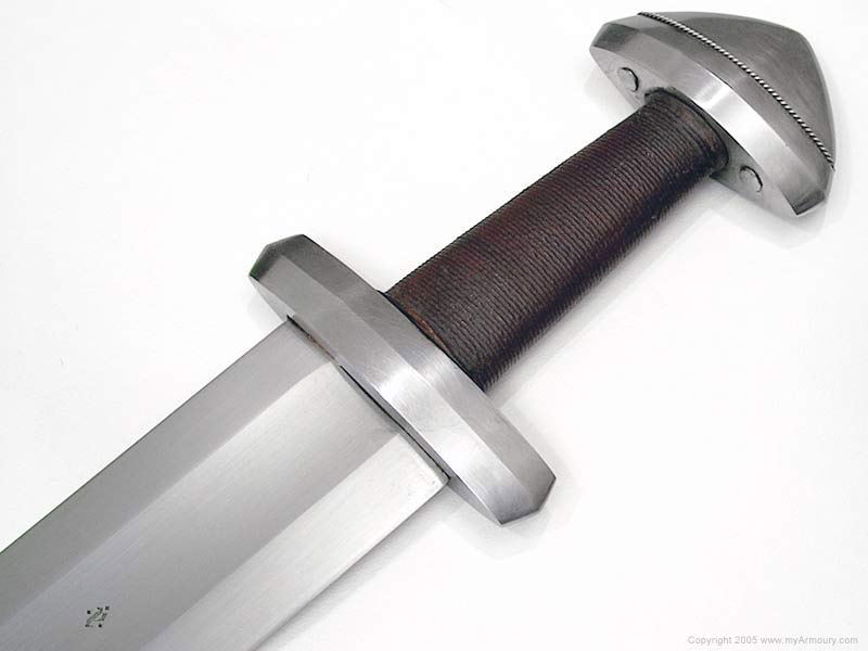

This sword has a classic look that is pleasing in its austerity. The finish on the sword is what I've come to expect from Albion. The hilt is well-finished to an attractive, yet easily maintainable, satin finish. The peaks in the upper and lower guards are straight and even and add visual interest to otherwise simple fittings. The two-piece pommel is held tightly together via two small rivets on the underside that show expected evidence of hammering. The wire that separates the upper guard from the pommel is tight and straight. I had to look very closely to see how it was held together (a very small amount of solder has been applied in one place). The grip, which finishes off the sword nicely, is Albion's latest version of what they call oxblood. Their oxblood color has undergone several transformations: early versions were a rich, darker red before a formula change made it much darker and more brown. In fact, their current Magenta color is very close to the original Oxblood formula. Until recently, there was a great deal of variation within the Oxblood color; a recent process change, though, has yielded more consistent results and a more red hue. There are no distinct cord risers on the grip, but none are necessary. As usual, the seam in the leather wrap is well-concealed.
The blade is also nicely finished and is a great example of the type. The fuller is wide and shallow, yet is well-defined. The fuller terminates very nicely on one side of the blade. The other side is a shade less even in its ending, but still better than what is commonly found in the production sword market.
Conclusion
Swords like the Hersir are why Albion is at the forefront of production-level Viking-style swords. Albion Armorers has really nailed down the cross-sectional subtleties on their blades which contribute to performance appropriate for each type they reproduce. Its performance in cutting was fantastic. While not my main period of interest, I found this sword to have an attractive classic look. The accurate pommel construction, secure hilt assembly, performance, and overall level of fit and finish make the Hersir a great option for those with an interest in historically accurate Viking swords.
