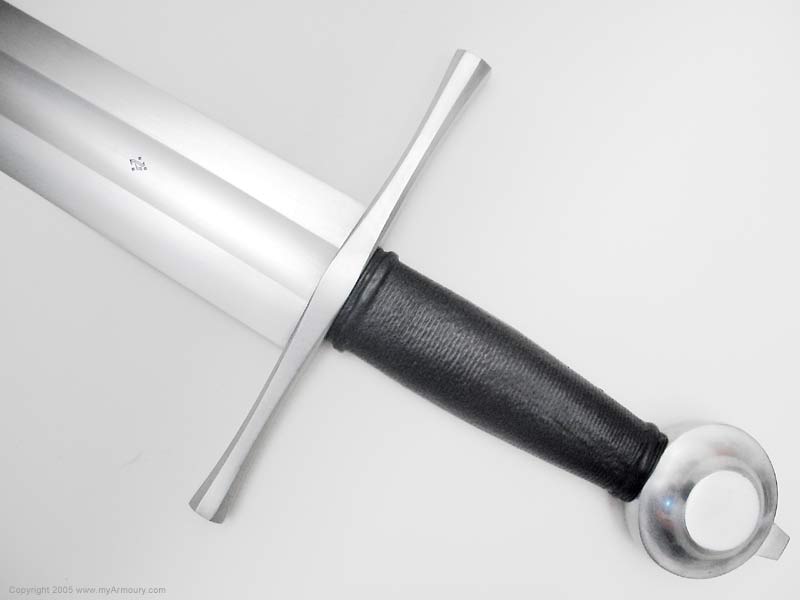

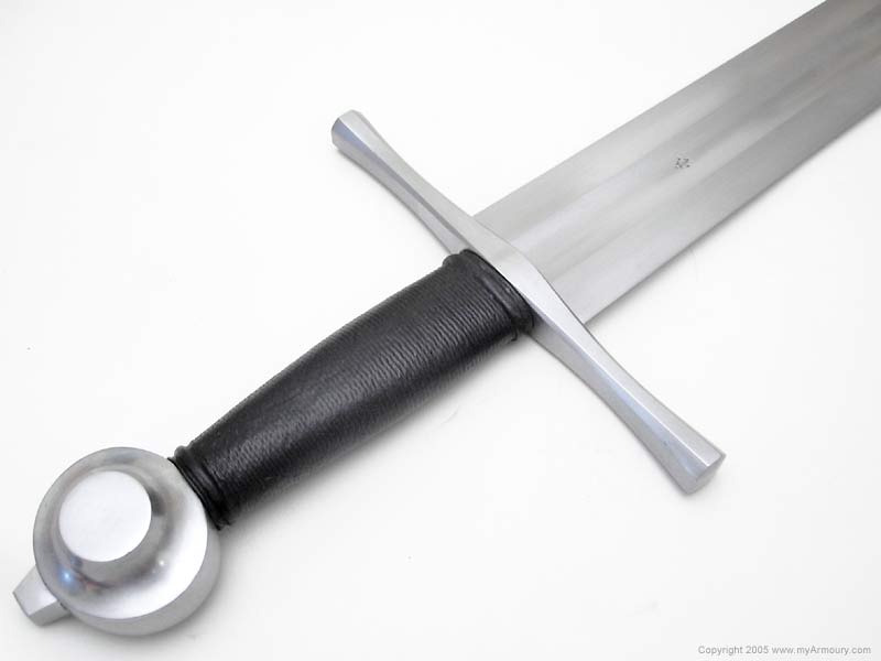

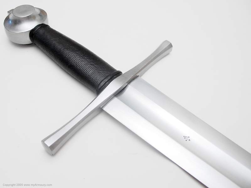

The fit and finish of the Knight carries on the high standard that sword lovers have come to expect from Albion products. The sword's blade features Albion's signature satin finish that is very attractive yet easily maintained. The blade's fuller runs for just over three-quarters of its length and is cleanly and evenly executed on both sides. Many replica companies fall short in the fit and finish department when it comes to fuller execution. Albion has always performed well in this aspect of production, and the Knight is no exception. The sword's blade features non-linear tapers, both distally and in profile. The blade maintains the same degree of profile taper until it reaches the end of its fuller. It then increases again, until it reaches the final curve to the point. The blade's distal taper increases its rate in three separate increments between the shoulder and the point. These features result in a distribution of mass that allows the sword to be both powerful and lively.

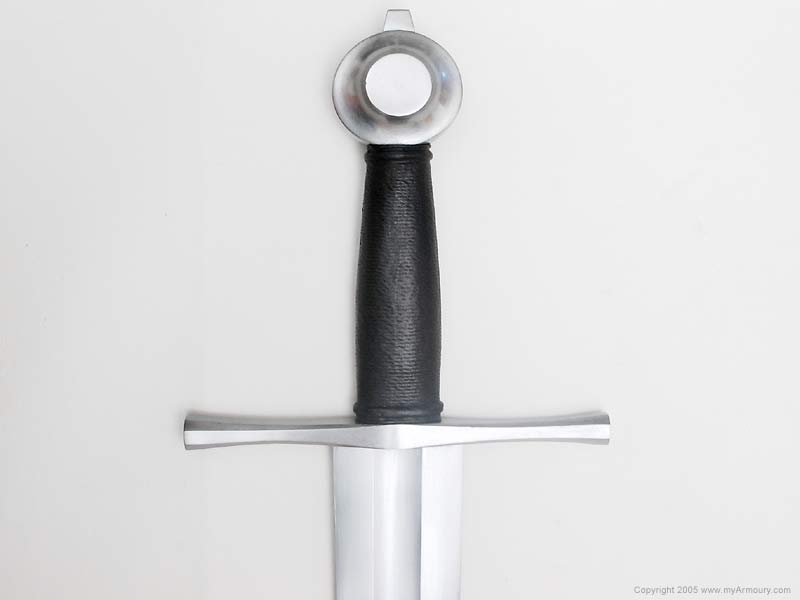

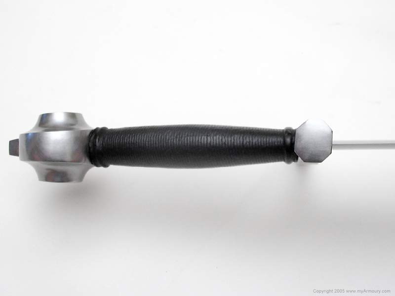

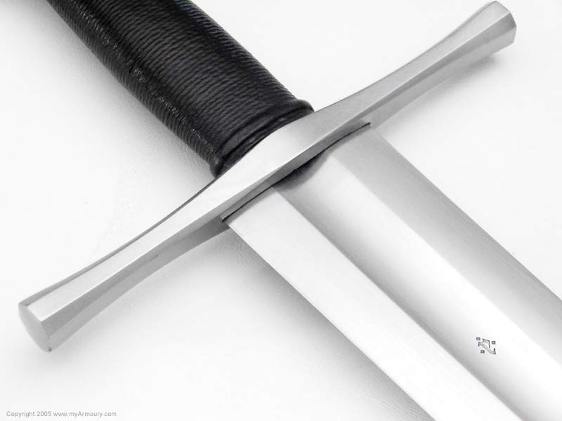

The Knight's guard is of Oakeshott's Style 2, a type that saw its highest popularity from 1200 to 1350 AD. The guard features an octagonal cross-section that can generally be dated to the later half of this period. The central portion of the guard is rectangular in cross-section. As the guard extends outward it narrows into an octagonal cross-section and then flares out to trumpeted ends that maintain the same octagonal shape. This design gives the guard a waisted appearance that is attractive both in its visual aspect and its proportion.

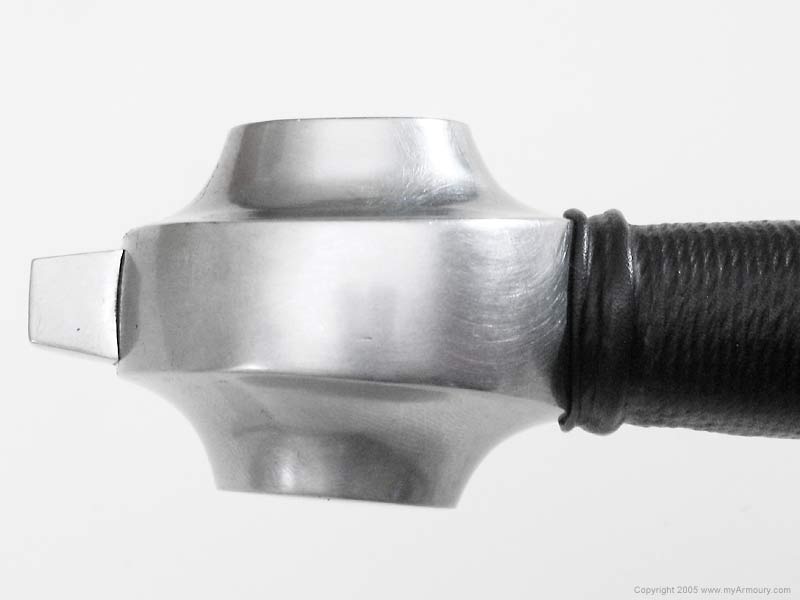

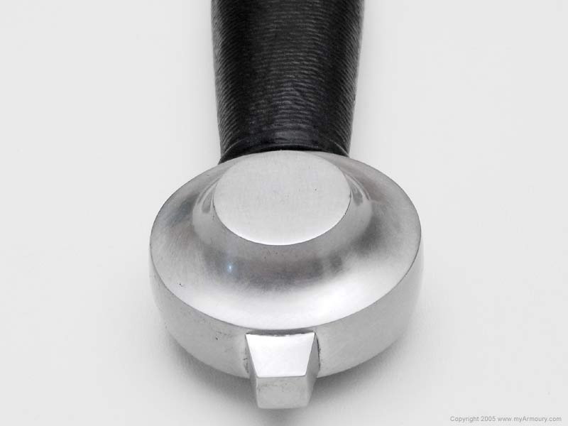

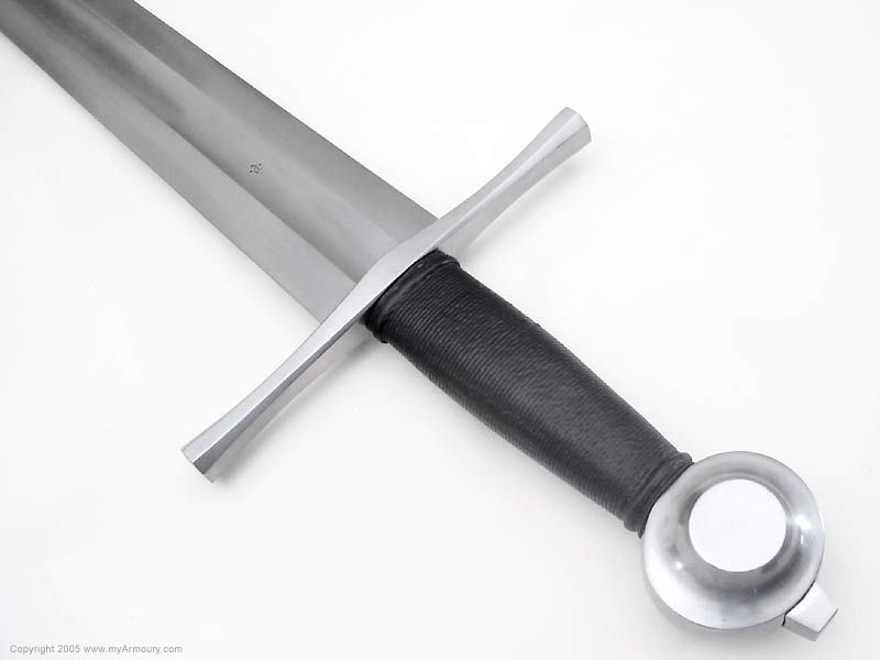

The pommel is of Oakeshott's Type J, a type that was most popular between 1250 and 1400 AD. After this period, the type saw occasional use up until 1450 AD. The pommel features beveled faces that have been strongly hollowed out. It is also of a slight oval shape in profile. These aspects of design provide a pommel that is clean in its execution and appealing to the eye. Both pommel and guard have been given the same satin finish that is used on the blade. These components are manufactured from mild steel using the investment casting process. Albion contracts this aspect of their manufacturing with a foundry based in California. The level of detail possible with quality investment casting has always impressed me. When finished by Albion's cutlers, these components are second to none in the production field.
The sword's grip has a leather covering that has become another Albion signature. The thin leather covering is glued over a core of stabilized birch. The grip features two cord risers underneath the covering; one at each end. After the leather is glued into place, it is bound with cord until dry. After completion, the covering's seam is burnished to near invisibility. The end result is a grip that provides an excellent gripping surface and is also aesthetically pleasing. The final feature of the sword's assembly consists of a rivet block of pyramidal shape. The end of the tang has been hot-peened into the rivet block and has also been finished so as to be nearly indistinguishable.
The final result is a sword that features a subtle dignity in its appearance as well as an excellent level of fit and finish throughout.

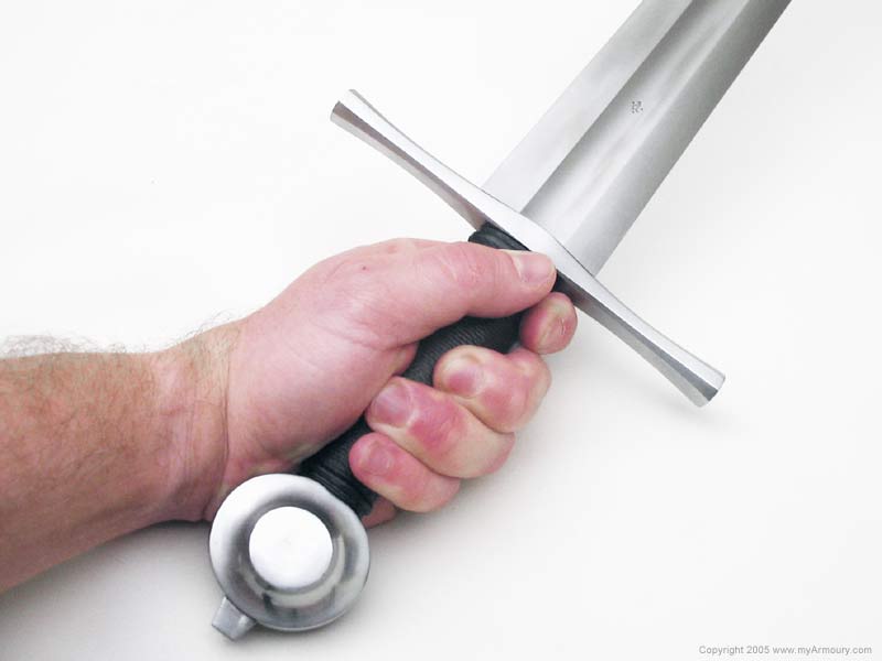

The Knight's handling qualities can be described with one word: outstanding. This is a sword that possesses a perfect balance of power and agility. During sword and shield drills, the sword moved effortlessly from ward to attack, and back again. As a comparison, I performed the same drills with another classic sword design: an Oakeshott Type X. This sword was not only designed by Peter Johnsson but was also personally made by him. As such, this sword features the same design philosophy and background as Albion's Knight. The Type X handled very well within the context of the exercise. In fact, it's better than any other sword of that type that I have previously owned. However, the Type X does not exhibit the responsive and agile character that is present in the Knight. The later type exhibits superior point control and recovery. When comparing the two side by side, it is obvious that the Type XII was a significant step forward in sword design.
Cutting exercises were performed using rolled Japanese tatami mats. This material has been widely used within Japanese martial practices for centuries. It has also become a very popular medium for cutting exercises within the western martial arts community. The Knight completed all cuts cleanly and effortlessly when used against this relatively soft cutting medium. The sword also exhibited excellent point control during thrusting maneuvers. The sword's mass followed the point well into a thrust, and at no time did I experience any trouble keeping the point on target.
The Knight's blade features the flat lenticular cross-section that is one of the defining characteristics of the type. Consequently, the sword's blade exhibits more flexibility than one would find in a more rigid design dedicated to the thrust. However, the Knight should still have given good service against many of the more lightly armoured combatants found on the medieval battlefield. It would also provide improved penetration against the improving mail armor of the period when compared to the earlier designs. The sword's excellent dynamic handling qualities would make it an outstanding candidate for use in the sword and buckler techniques outlined in one of the oldest medieval combat treatises: The Royal Armouries Manuscript I.33. Believed to date from the late 13th century, this manuscript outlines a complex system of combat with the single-handed sword and buckler. The Knight's responsive and agile character makes it an obvious choice for this style of combat.
