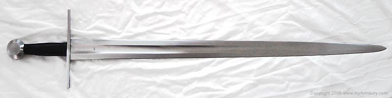

Albion Armorers of New Glarus, Wisconsin, is well known for the excellent quality of their Next Generation line of swords, but they also offer several swords at a lower price point. Known as the Squire Line, these swords are lower priced so that those on a budget can still enjoy owning a quality sword. The lower cost of these swords is accomplished largely by designing the Squire Line swords around an unsharpened edge and employing a lower level of finish on the swords' simplified fittings. Also, Albion does not offer a choice of grip colors on these swords. Despite these differences from the Next Generation line of swords, the Squire Line still shares the same solid, historical construction described in our review of the Baron. For those who like the advantages of a lower priced sword, but still want to cut with it, Albion will sharpen a Squire Line sword prior to shipping if the customer so requests. This service costs $25, which still keeps the sword's price very attractive. The piece reviewed here is a sharpened Albion Squire Line 13th Century Knightly sword.
It should be noted that, while these swords normally do not have a sharpened edge, they are still thin enough that they should not be used for historical fencing. There are other tools available on the market that are specifically designed for such activity.
Click to enlarge

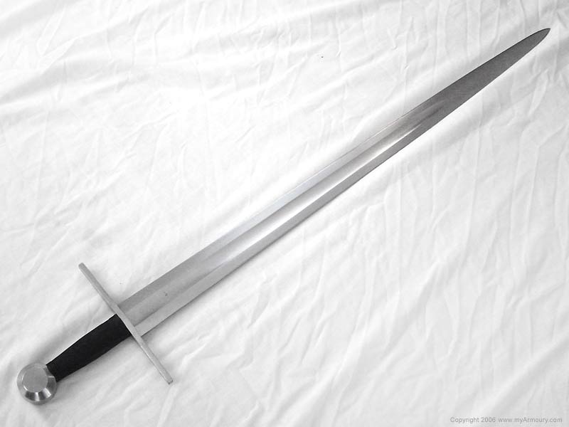

Weight:2 pounds, 8.2 ounces
Overall length:37 3/8 inches
Blade length:31 1/4 inches
Blade width:2 1/16 inches at base, tapering to 7/8 inch
Grip length:4 1/4 inches
Guard width:7 3/4 inches
Point of Balance:4 inches from guard
Center of Percussion:~19 1/4 inches from guard
Oakeshott typology:Type XII blade, Type I pommel, Style 1a guard
Handling Characteristics

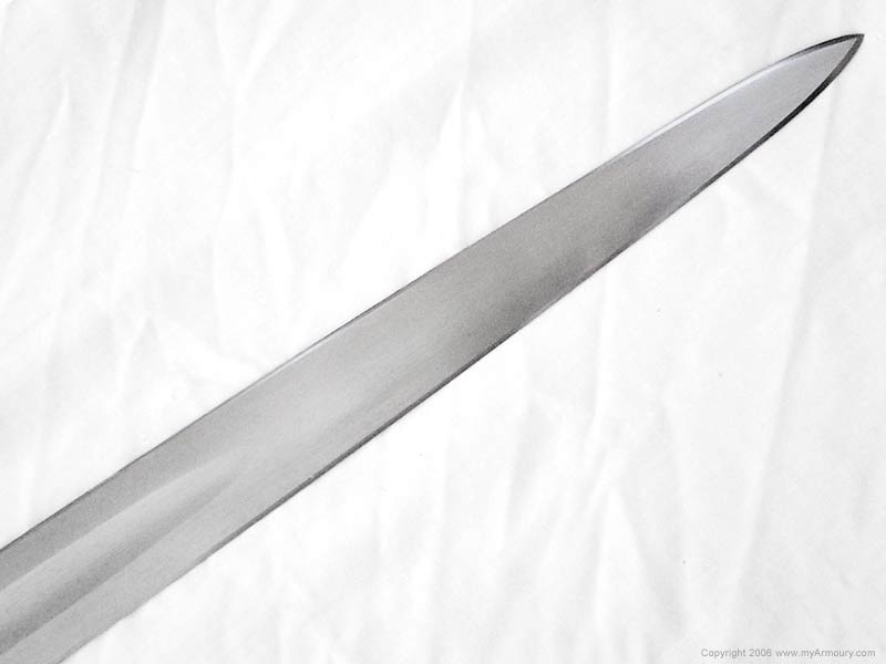

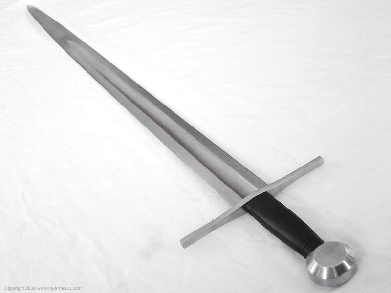

This is a comfortable sword to handle. One of the things that surprised me about it was how thin it seems when handled. The blade is nice and flat as befits a cutting sword, but the non-linear distal taper and lenticular cross-section of the point help to make it seem even slimmer. It is very easy to imagine a blade built like this slicing easily through soft or even lightly armoured targets. Likewise, the grip is formed to a thin oval section at the guard. In my opinion, this helps to promote use of the handshake grip, which in turn improves the handling of the sword.
Click to enlarge

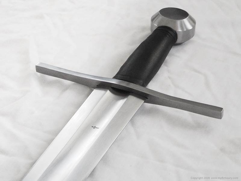

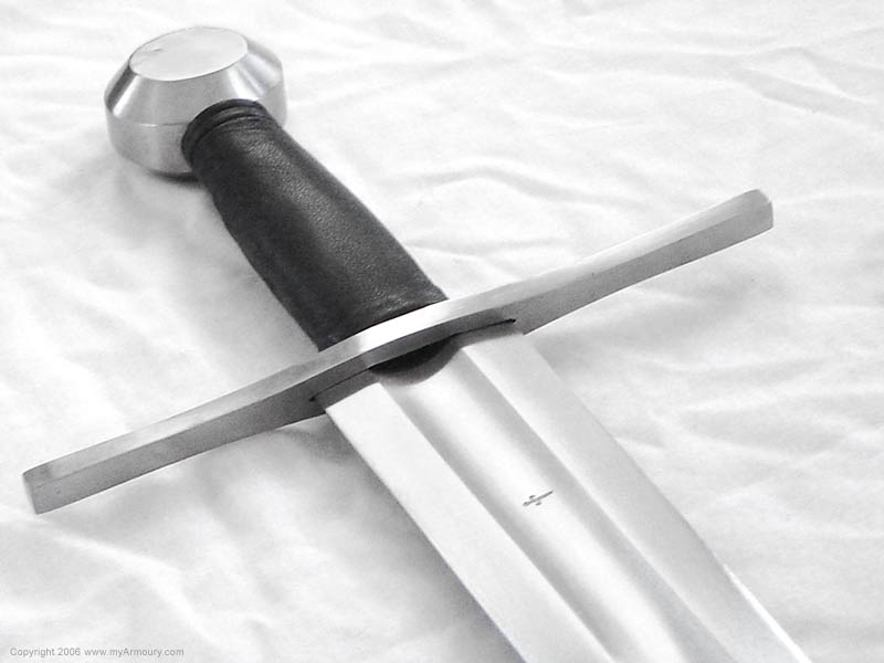

Blade Detail
This is the first sharp sword that I ever tried to use for cutting. My initial cut was unsuccessful due to some hesitation on my part, but I quickly learned that this sword would perform well as long as I did my job by using enough force and follow-through (and hitting the target, of course). It is hard to say whether the secondary bevels on the sword's edge affect the way it cuts, as I did not have another Type XII sword for comparison. I did do some comparative cutting with my Type XVI Albion Next Generation Squire and felt that it proved to be slightly faster, but that the Squire Line Knightly sword had just a touch more authority in the cut. In the end it is hard to say how much these perceived differences are the result of the construction differences between the two Albion lines and how much of it is because they are two different sword types.
Obviously, if this sword is supposed to represent one of the early cut and thrust types, it should be able to thrust well. This sword lives up to that expectation. It is not a rapier or Oakeshott Type XV or any other sword specifically designed for thrusting, but I believe that it would be a great improvement over the wider points of Type X and Type XI swords. The point does wander slightly when thrusting, but not very much. I didn't really notice it until I started to compare it with swords like the Albion Next Generation Poitiers, which is not a fair comparison at all. The Squire Line Knightly sword's thrusting ability is certainly satisfactory given that it was designed to provide improved thrusting performance while still being capable of strong cuts.

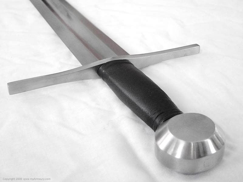

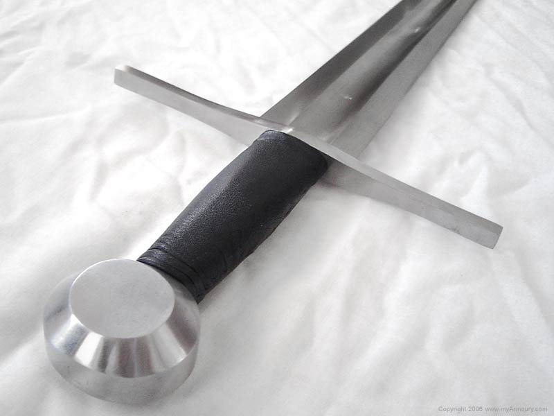

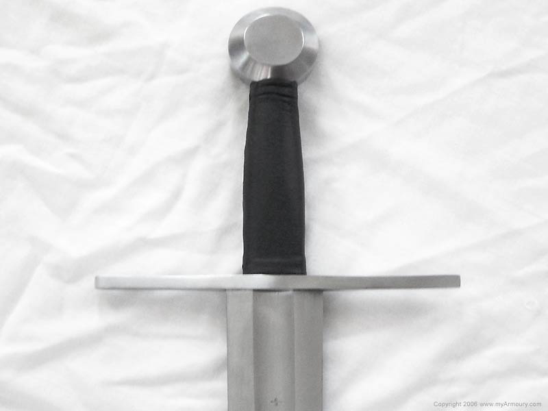

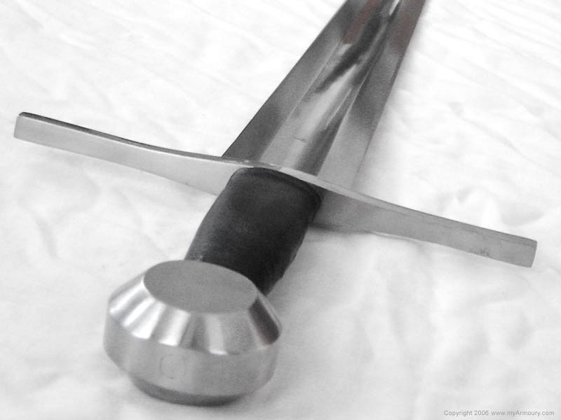

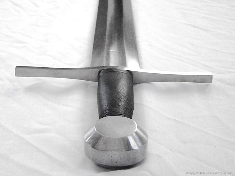

The Albion Squire Line swords have a slightly more matte finish than their more expensive Next Generation cousins, but I did not find the difference noticeable. Even the secondary bevels from the sharpening process are not very obvious to me. The biggest visible difference was the simple shape of the guard, and the lack of cord risers on the grip.
The guard on the sword reviewed is quite simple, with no beveled edges or decorative lines. It is still functional and historically correct, but simply does not have any fancy extras that would increase the cost of the sword.
Click to enlarge

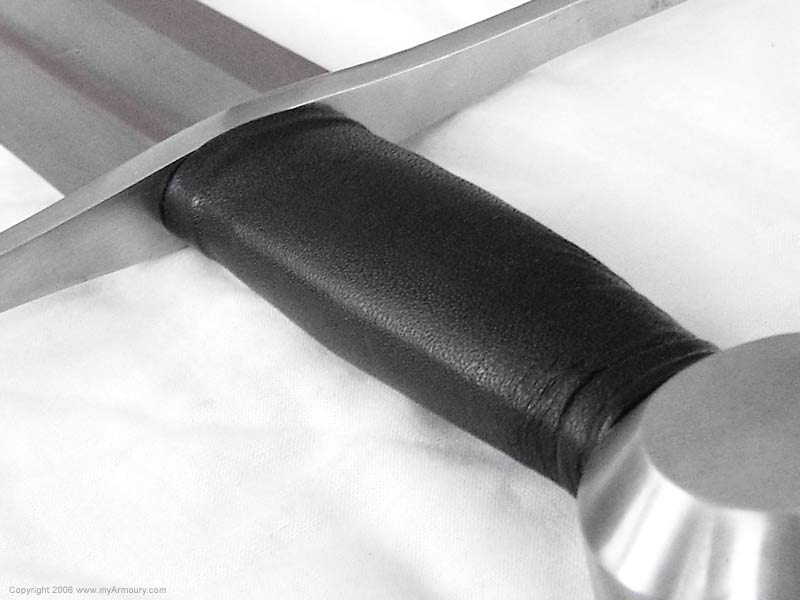

Grip Detail

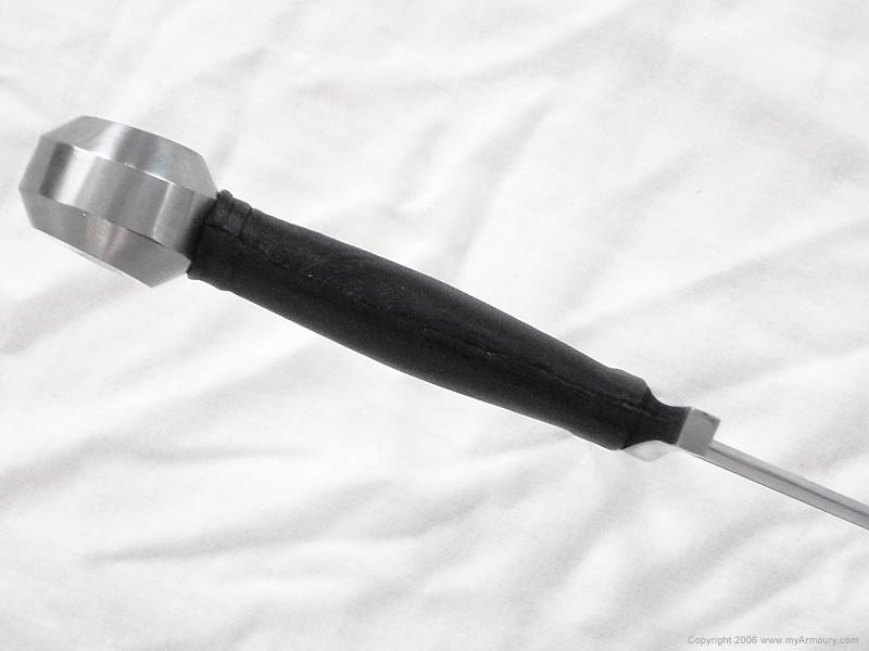

Another simplification that Albion uses to keep down the price of this line of swords is to use a simple black leather grip covering with no cord risers. I had originally intended to re-wrap this grip using the process described in Sean A. Flynt's The Instant Antique: A Practical Guide feature. I asked Albion's customer service representative about the ramifications of doing so, and he informed me that they would still cover the blade, but could obviously not guarantee the hilt after I had modified it. When I finally got the sword in hand, I liked the grip well enough that I have not bothered to change anything. It fits well in my hand, and provides a solid grip. There is a slight bulge in the leather where it is slightly longer that the grip itself, and the seam is visible, but neither of these imperfections is noticeable when holding or using the sword.
Despite these simplifications, the Squire Line still features Albion's wedged and peened hilt construction that is not available on other swords of this same price.
