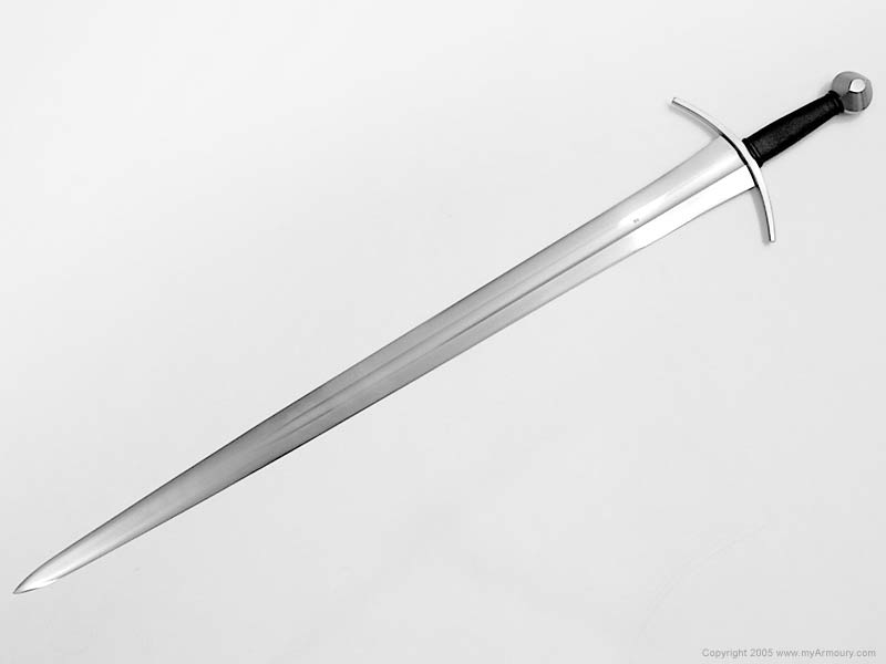

Weight:2 pounds, 8 ounces
Overall length:38 1/2 inches
Blade length:32 inches
Blade width:2 3/16 inches at base, tapering to 7/8 inches
Grip length:4 1/2 inches
Guard width:7 inches
Point of Balance:5 inches from guard
Center of Percussion:~21 inches from guard
Oakeshott typology:Type XII / Type XIV blade, Type W pommel, Style 7 guard

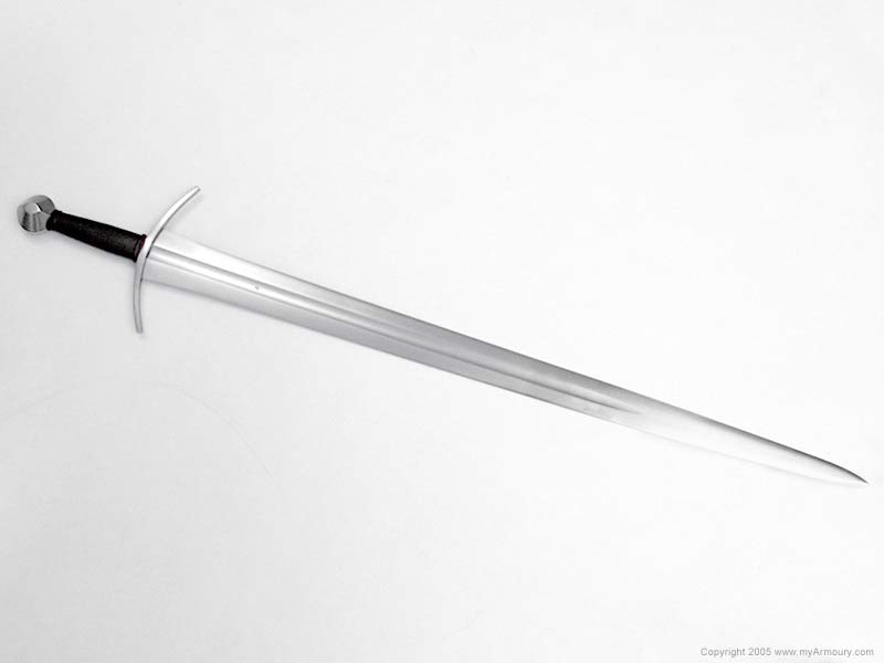

The Solingen's form belies it function. Broad and flat with a lenticular cross-section throughout, this sword is definitely a cut-oriented weapon, though its pronounced taper allows for reasonably quick transitions to thrusts and back when desired.
The weapon is very comfortable and easily controlled during guard transitions and slow-to-intermediate cutting exercises and flourishes, but it absolutely shines when used with speed and intent. It makes follow-through instinctive, with easy and natural transitions from full-arm blows to wrist cuts.
The dynamic balance of this very fast and agile weapon, with its pivot point close the Center of Percussion (CoP), allows for powerful sweeping cuts without being cumbersome in recovery or thrusting. It seems equally capable of brutal shearing blows as well as more intricate swordplay such as quickly changing the angle of attack either before or after binding the opponent's weapon.

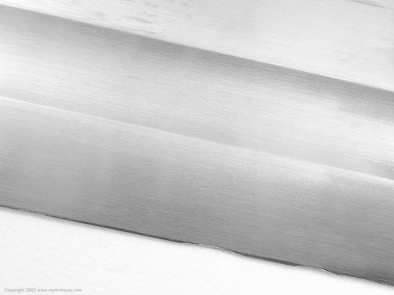

My test cutting with the Solingen included strikes against other swords, a steel buckler, and a hood of imported Indian mail stuffed with a soccer ball wrapped in shirts and suspended from a rope. Strikes with Solingen's edge against the flat of another sword resulted in denting at the contact area of the Solingen and minor folds in the blade edge that needed to be filed off. Strikes of the other sword against the Solingen's flat yielded no damage to the Solingen. Strikes against the buckler yielded no damage to the Solingen except once when the sword accidentally struck the lip of the buckler, resulting in a minor twisting of the edge at the contact area. Strikes against the mail dummy resulted in multiple but very minor nicks along the blade edge. The only damage visible after these tests is from the strikes against the other sword, and these appear only as minor distortions along the edge. The damage sustained was acceptable for what a sword could reasonably expect to encounter.

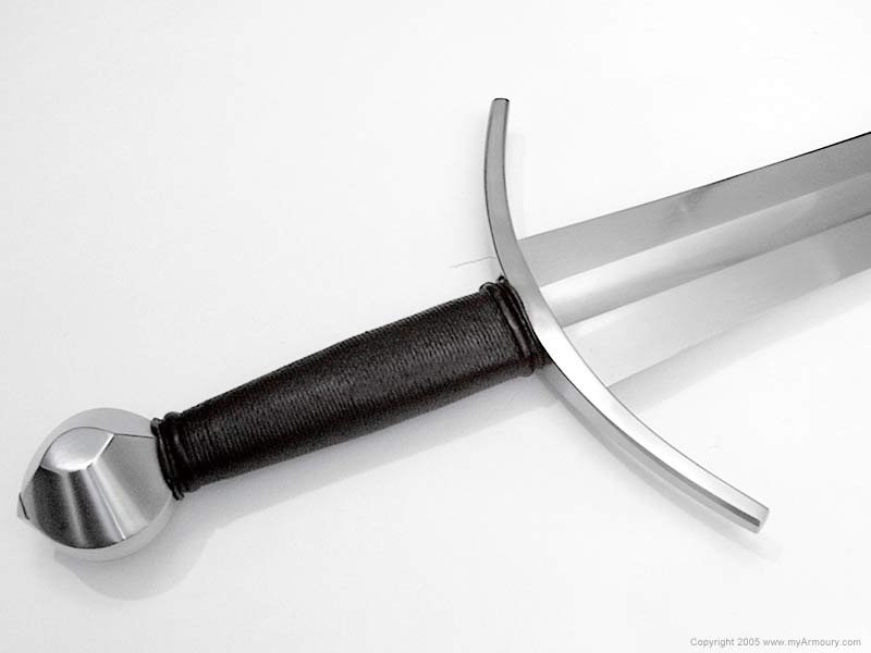

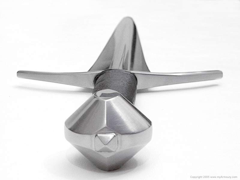

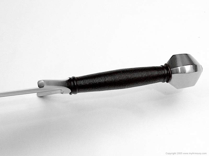

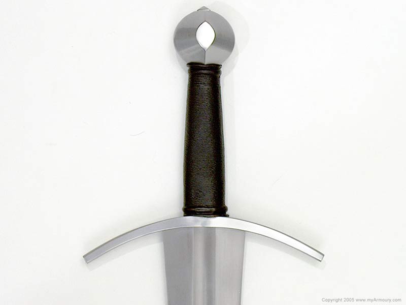

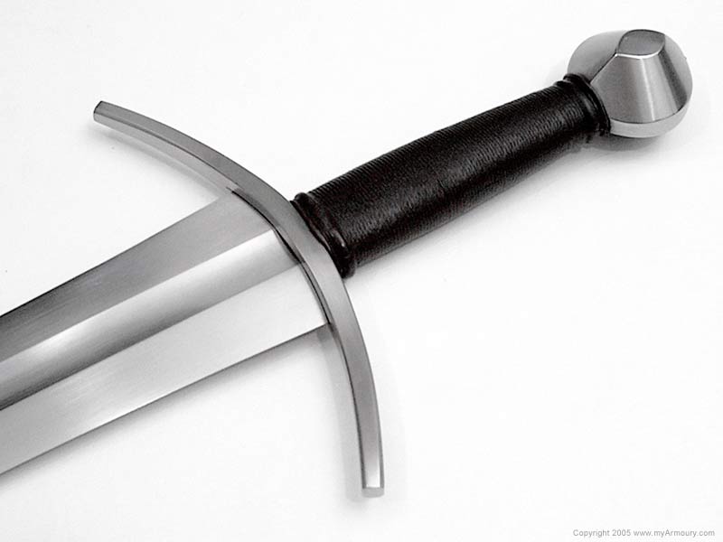

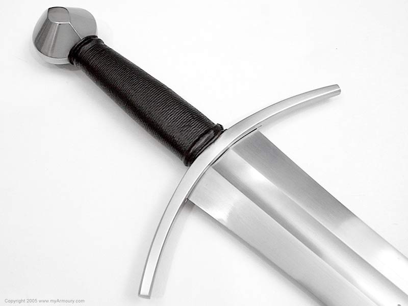

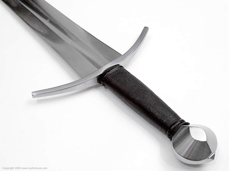

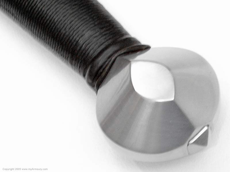

The hilt is very cleanly and solidly assembled, with no play in any of the furniture or flaws in the polish. The pommel is a faceted or "phased" spherical shape that is comfortable in the hand or against the wrist while flourishing. The tang forms into a rivet block shaped into a low pyramid, sitting atop the pommel. The cross is a down-turned arc, which transitions from a rectangular shape at the grip to octagonal at the terminals. The grip is bound with two cord risers, one at each end, and is then wrapped in soft black leather which should age nicely over years of use.

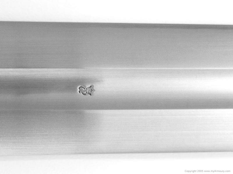

The blade itself is equally well polished and shaped, with a well-executed fuller that blends into the blade at its terminus. The blade also has a subtle flare near the hilt. I find this last detail one of the most aesthetically pleasing parts of the weapon. The point of the weapon is also well formed.
