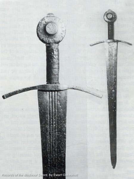

Ewart Oakeshott, an authority on medieval arms in Europe, created a typology developed to attempt to categorize the various types of swords seen throughout the history of arms. Collectors and scholars alike often refer back to his typology when referencing swords, attempting to create a common ground of understanding for a given example.
A favorite sword in the personal collection of the late, great Ewart Oakeshott was a medieval sword of Type XIV, circa 1300, which he dubbed "Moonbrand", aka "The Household God". Mr. Oakeshott described this sword as "the very model of a Type XIV", with its broad blade, cross, and pommel, having "extremely good balance", and moving "very quickly and lightly".

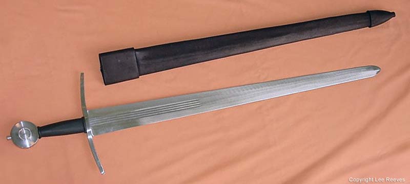

Weight:2 pounds, 12 ounces
Overall length:36 5/16 inches
Blade length:30 5/16 inches
Blade width:2 5/16 inches at base
Grip length:4 1/2 inches
Guard width:9 inches
Pommel diameter:2 1/4 inches
Point of Balance:4 1/2 inches from guard
Center of Percussion:~22 1/2 inches from guard
Replica created by Angus Trim Swords of The Pacific Northwest.

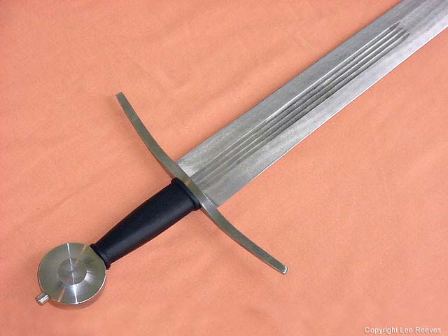

As my taste in reproduction swords leans heavily towards historically inspired pieces, I was quite pleased to receive this sword. It is styled very much along the classic lines of the original "Moonbrand".

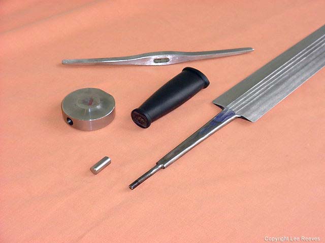

Gus's models are typically crafted more in the general typology of historical swords as opposed to reproducing any particular authentic example. It was rather cool to see him make one much closer in this case. The main compromise for this piece is its takedown hilt construction, with threaded tang and nut assembly; the original's tang having been secured through peening.
Being a test piece, the level of polish was quite acceptable; all its lines, fullers, etc., being well done, straight and true. The only real blemish is a few lines down the center of the blade from where the fullers end to the tip, which I'd imagine are a result of the machining process.
Click to enlarge
The Sword Hilt
All the hilt's components were very secure, and fit well together. The leather wrapped grip felt wonderful in hand, and features raised wooden collars carved at either end.

Ken's DD1404 arrived with furniture identical to that pictured on The Armoury, Wasilla Alaska site. The guard is a long curved bar shape. The four fullers are not blued. Overall appearance is very similar to Oakeshott's sword in Records of the Medieval Sword. The blade profile is symmetrical and the grind lines are well done. The fullers are nearly identical in length. The blade width, four short fullers, long guard, and large pommel make for a striking appearance. The leather-covered grip is very well done. Overall, Ken finds it very pleasing to the eye.

The Sword, Shown Disassembled

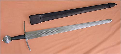

Ken's impression upon first seeing the DD1404 was that it was bigger than he had expected. Hefting the sword is misleading. The weight is nearly three pounds, but the balance makes it feel much lighter. He has two-pound swords that feel more cumbersome. The DD1404 is easy to manipulate and seems to track very naturally. The blade is wide but thin as befits a cutting sword. The weight is only really noticed when trying to accelerate the sword in the cut or in quick changes in direction. It's not clumsy at all but substantial and "authoritative".
Like Ken, I too was surprised at how big this piece actually is. I had envisioned an all-around shorter, thicker, piece: something along the lines of an over-developed Cinquedea. Not so! Despite its formidable size, and its big honking pommel, I found it a breeze to swing. Its big kite-shaped blade is thinner and more flexible than I would have predicted; getting up to speed very fast.
Gus has really trimmed the fat with this blade, keeping it nice and thin where it should be, and giving it that "quick and light" feel Mr. Oakeshott talked about. It retains all the size and power a big medieval cutting blade should have. I liked it a lot!
I did a series of cutting tests with small trees and branches around my yard. Several of them were up to 2" inches in diameter. The blade blew thru them quite easily. No nicks or damage occurred: at worst a little bit of scuffing! I also did the usual lighter target: water filled pop bottles, rolled newspaper, and rope. It did a fine job effortlessly slicing thru all these mediums.
Since most of my personal collection has become rather high-end custom pieces, I do so enjoy the carefree abandon of punishing one of Gus's swords and pushing it several steps beyond what I'd normally do to my one of my own these days.
I've never had one of Angus's blades fail me when cutting targets of reasonable, and not so reasonable, materials. His reputation for having tough, high performance, dependable, swords is 100% on the money. Given the price point, they are a very good value for the dollars spent.
Ken felt that the "proof is in the pudding", so trudged out the cutting stand and a collection of pool noodles. His primary concern was getting the DD1404 up to velocity. He's used to lighter swords and the three-pound blade is just slower, so was surprised when he began whacking the noodles. It's certainly slower, but is a cutting monster. Mass and blade geometry seem to work together as the blade cut through the 3" and 4" noodles with ease. The cut could be heard, but virtually no resistance was felt. Backhanded cuts seemed as easy as the forehanded ones. Without a doubt, this is the best single-handed cutting sword Ken owns, beating even his Atrim Type X.
The DD1404 isn't really designed as a thrusting sword but seemed willing as the point cuts its way through a target of ganged-together 4" pool noodles.
