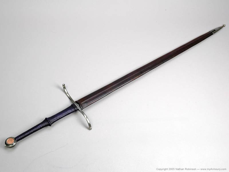

Angus "Gus" Trim is a maker of high performance swords that are in most cases based off of European designs (though he has branched out to Japanese blades as well). Gus has long focused on creating swords based on their functionality first, followed by their aesthetic look. Rounding this out is Christian Fletcher, a cutler who has become well-known in the sword world for both retailing Angus Trim swords and modifying them with new grip wraps, scabbards, and even custom hilt components. The Angus Trim/Christian Fletcher combination works well to produce quality swords that focus on both function and aesthetics.

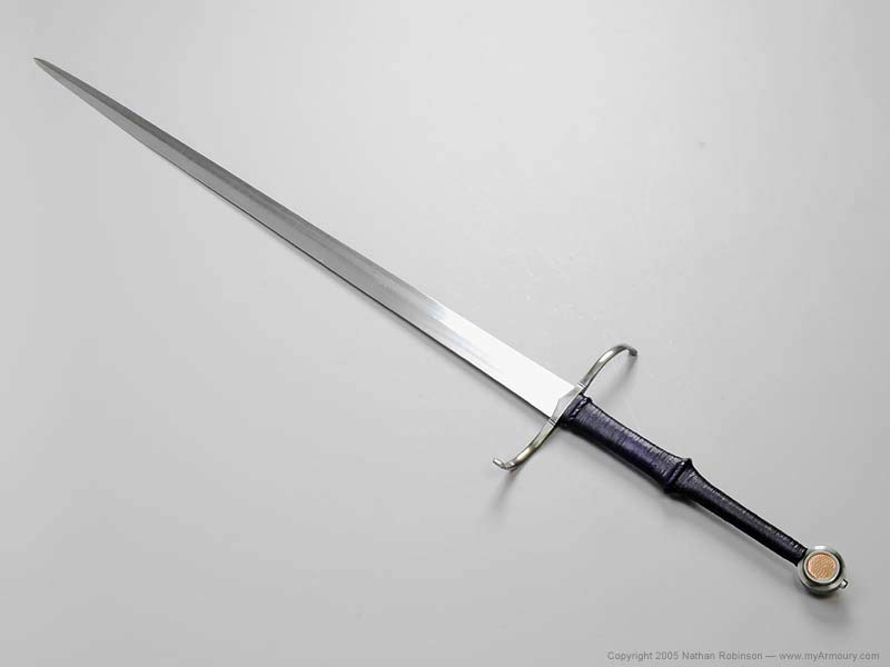

This sword is created with the blade of the AT1593 with a full custom upgrade by Christian Fletcher, including replacement hilt components and a leather-covered wooden scabbard. This sword is very loosely based off of the two-handed sword in the Bayerisches Nationalmuseum. It was not intended to be a direct copy, but rather to capture the aesthetic feel of the original.
Click to enlarge
Weight:2 pounds, 8 ounces
Overall length:49 inches
Blade length:36 inches
Blade width:1 5/8 inches, tapering to 5/8 inch
Grip length:11 inches
Guard width:8 1/2 inches
Point of Balance:4 inches from guard
Center of Percussion:~20 inches from guard
Oakeshott typology:Type XVIIIb blade, Type J1 pommel, Style 12 guard
Replica created by Angus "Gus" Trim and Christian Fletcher.
Handling Characteristics
The AT1593 is a fairly large longsword, but it is lightweight and easily maneuvered. Part of this is owes to its thin cross-section and steady distal taper, keeping the weight down. Another aspect is the long grip, which allows for a great amount of leverage.

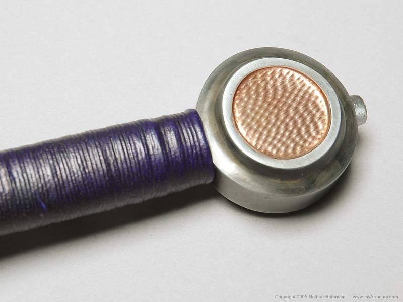

Pommel Detail

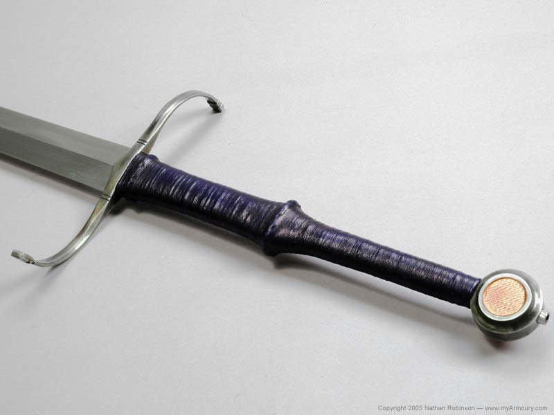

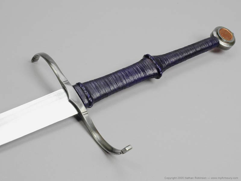

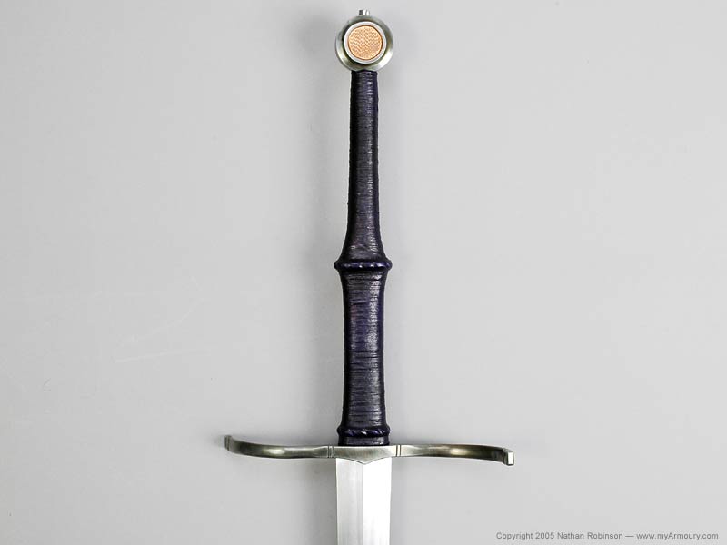

Grip, Guard, and
Blade Detail
The long grip takes some time with which to get acquainted. I am generally a person who likes to grip the pommel of the sword with the off-hand, but with this sword I do not. Doing so makes some actions slightly awkward for me, but holding just the grip with the hands spaced far apart is ideal to me. The long grip makes it easy to use this sword for quick snapping cuts, and cuts that change direction from the true to false edge are easily made. Such cuts are often seen in the German Liechtenauer tradition of fencing, with cuts such as the zwerchau, or "cross strike", where the sword makes a horizontal cut with the hands held above the head. The blade would make a circular motion over the head, like a halo, cutting from one side or the other. In the case of the opponent setting your sword aside, a quick reversal to the other side might be necessary using the opposite edge. Having the leverage of a long grip, while not necessary to perform the action, does make the AT1593 feel very natural and very fast for its size.

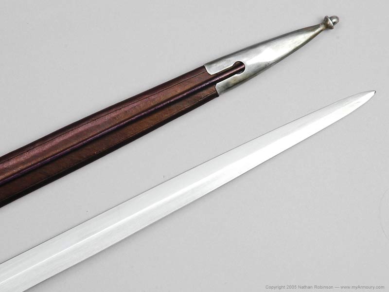

Click to enlarge
Scabbard and
Blade Tips

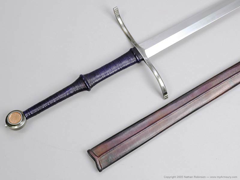

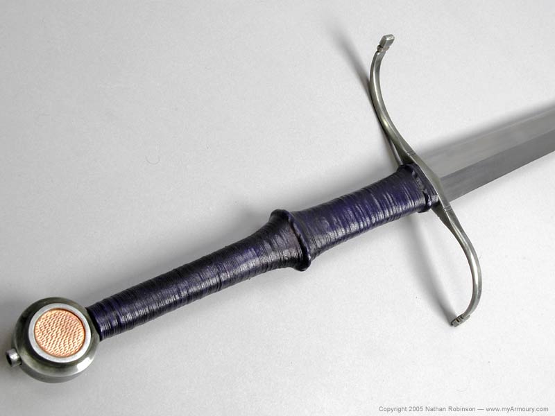

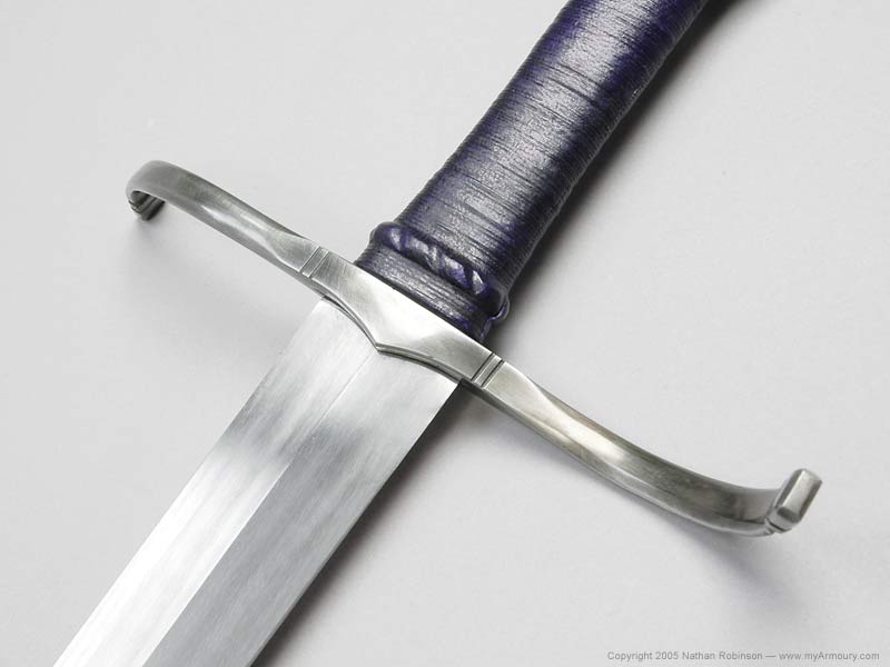

Christian Fletcher's cutlery work is really top-notch on this piece. The fittings were antiqued to give a slightly worn but still elegant appearance, and the hand-forged guard has notches near the ends to give a tasteful bit of flair to it. The waisted hilt is cord-wrapped and covered in a deep violet leather; it looks quite beautiful. The sword that provided the loose aesthetic inspiration has a very ornate pommel, and Christian compensated for this by inlaying textured copper into the face of the pommel.
The blade looks slightly odd on this hilt, as the polish is slightly uneven, with some visual evidence of grinding still left on it. On the ordinary fittings of a typical Angus Trim sword, this would not look so out of place, but on the very regal fittings Christian Fletcher added, it would have really looked nice to finish the blade a little bit more. This, however, would have increased the price of the sword, as polishing is time-consuming.

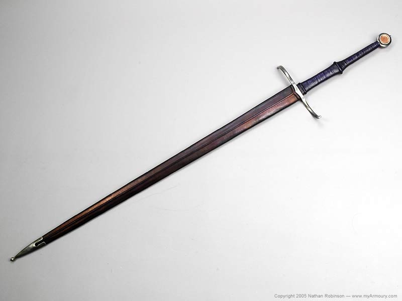

The scabbard is fantastic. Christian did a fantastic job of sculpting the wood with a center ridge and subtle shaping that follows the lines of the sword blade itself. The chape is hand-forged with a decorative finial at the end.
