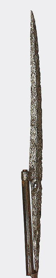

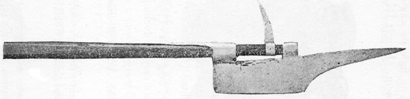

Howdy folks,
I have spent the last few days trying to find information and pictures of actual poles weapons from the xiii and xiv century. For the purposes of this post I want to neglect spears and lances, and concentrate on weapons that can both cut/chop and thrust (halberds). Oakeshott mentions that in the battles of Flanders (1302) and Morgarten (1315) in Switzerland Halberds were used with great success. What did these weapons look like?
Oakeshott has an illustration of a halberds looking like the first picture bellow were used early in the xiv century (this particular specimen was dated to XVc)
The only other picture found was to a XIVc "glaive?". There are plenty of examples of XVc and later halberds but I am not interested in those .
Where there any other varieties during this time period? Who used them? Could they be considered knightly weapons as well or not? Knights in the Maciejowski bible were pictures with similar weapons were they not?
My last question might be the hardest to answer. When fighting on foot, what was the preferred knightly weapon apart from the sword? I am mostly interested in two handed weapons. This question still has the XIII-XIVc period in mind.

 Attachment: 49.02 KB, Downloaded: 958 times
Halberd from Czerny's. Dated XVc [ Download ]
 Attachment: 23.5 KB, Downloaded: 879 times
Czerny's XIVc halberd (glaive?) [ Download ]

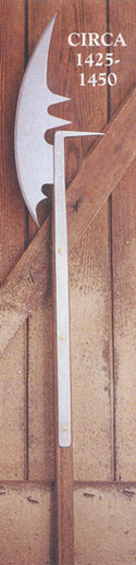

Are you looking for a replica, or just historical examples? If the former, a Kern axe (see Albion's below) or a Lochaber axe (the two below are from the Mad Piper) might technically be later than your interest, but are more easily found than a true early polearm replica, and might at least approximate plainer early weapons. The Kern axe HEAD is only $75! The Lochabers are $100 from the Mad Piper. I've been sorely tempted to get one of these and haft it myself.... For all I know, these basic designs would be appropriate much earlier than the cultures we generally associate them with. The Kern axe, especially, doesn't seem like a huge technological leap from the large Norman/Saxon axes. All this is far outside my own limited field of knowledge, though.

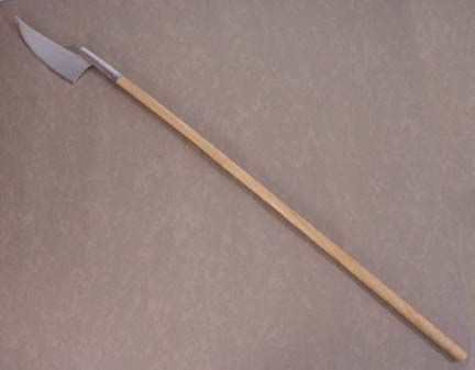

This seems like it would be a helpful reference for you: http://www.geocities.com/wolfram_von_taus/Research_Voulge.htm
Have you seen the Windlass Voulge (below)? Again, this may be just a bit late for your interests. I handled one of these and was very impressed by its construction, weight and handling (plus, I just love the design). They're relatively inexpensive-around $140-but I don't know if the dates shown below are accurate. Windlass/MRL sometimes get dates wrong. The Windlass Swiss Axe is probably closer to the period of your interest, and I've handled it, too. I actually felt like the Swiss Axe was the more impressive of the two weapons, if not the most fierce-looking. It's cheaper, too-around $120.

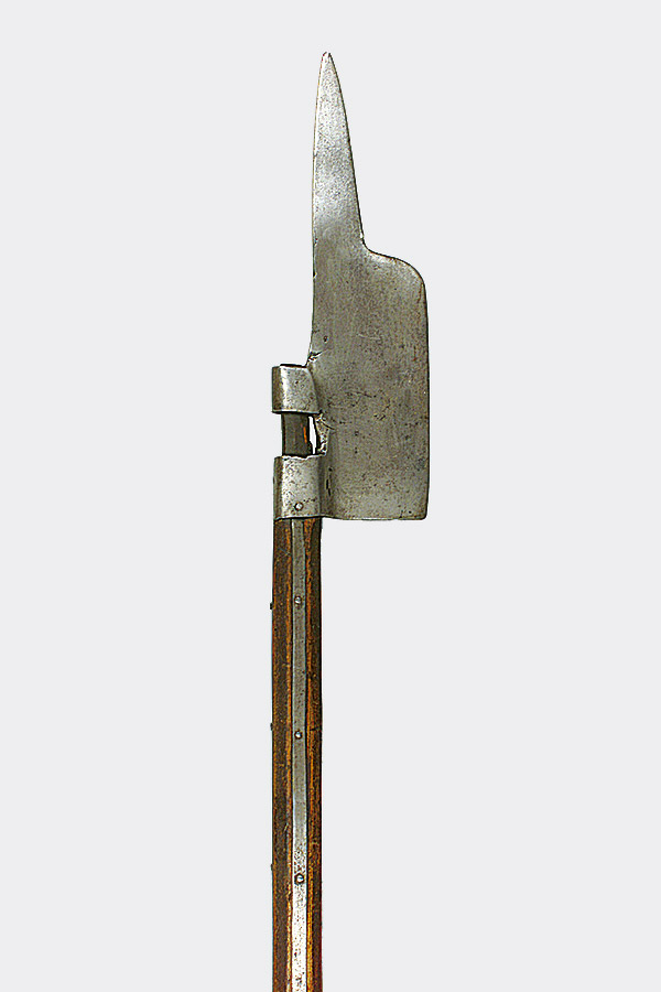

Have you seen the Windlass voulge (below)? Again, this may be just a bit late for your interests. I handled one of these and was very impressed by its construction, weight and handling (plus, I just love the design). They're relatively inexpensive-around $160-but I don't know if the dates shown below are accurate. Windlass/MRL sometimes get dates wrong. Have you checked out Lutel's offerings (lutel.cz)? I think they have an early halberd.

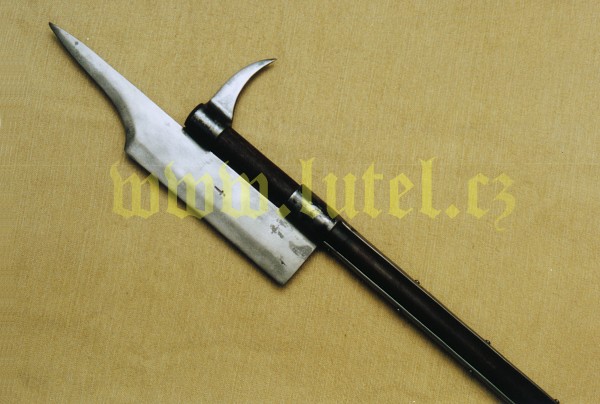

Thanks Sean,
The voulge reference was pretty neat and provided a picture of the XIVc swiss weapon. I did look into Lutel's weapons, and the only ones falling in to the time period of interest were few battle axes, but no halberds. One is listed as early XVc halberd and looks almost exactly as the XIVc voulge. Might be an alternative. There are also several nice illustrations (by grahm turner) in the Osperey's "English medieval knight" (either 1300-1400 or 1200-1300) book showing a glaive like weapon used against mounted knights.
The Albion Kern pole axe looks astonishingly simple and deadly and I would buy it in a heart beat if I knew that a very similar weapons had been used before XV c.
Thanks to anyone who responded so far,
Alexi
XIVc swiss voulge
Lutel early XVc halberd

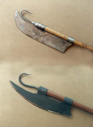

That lower one of the Mad Piper versions looks ever so much like a Hanwei GT 1076 (attached) with a hook welded on.

PostPosted: Fri 09 Apr, 2004 2:05 pm    Post subject: Reply with quote
This Hanwei or Mad Piper peice looks nice. No date though. Any opinion about the quallity of the Hanwei pole arms?

PostPosted: Fri 09 Apr, 2004 2:08 pm    Post subject: Reply with quote
Well, if you like that Kern axe, I bet you'd really get a kick out of that Windlass Swiss Axe (see my edited post). Same general idea as the Kern axe, but it's just inside the period of your interest, and is slightly more sophisticated (back spike, langets and butt spike). That butt spike is not to overlooked, by the way. It is substantial and solid, and dramatically expands the capability of the weapon. I loved the way this weapon handled. Very quick, and with a nasty bite at both ends. It was enlightening and a bit nervewracking to see two of my ARMA colleagues VERY gingerly sparring with this weapon and the voulge. Those back spikes are very effective at trapping, pulling, hooking, tripping, etc. Certainly made me think that I'd choose one of these over any sword. If you're interested in either of these Windlass weapons, I have photos of them in action. That would give you a better sense of scale than the catalog photos can provide. Just holler if you want to see them and I'll post them here.

Of the reproduction designs posted so far, the Hanwei GT 1076 looks the most like a very early halberd. A blade similar to that one was recovered from the field of Mortgarten - which was fought in 1315. The two-part socket is a distinctive part of early halberds, as it helps to keep the head from breaking off the shaft. The design of the kern axe is less sturdy in this feature.
The Lutel design and the K+K one I mentioned above are the next stage in halberd evolution, and date from the late 1300's.

PostPosted: Sat 10 Apr, 2004 3:07 am    Post subject: Reply with quote
Alexi Goranov wrote:
Alexi
Alexi
The GT pieces are generally solidly made, if a bit on the heavy side. I've not got this one, but I recall suggestions to that effect from previous Netsword discussions. I've got a shorter axe from them that I like a lot, but again it might be bit 'overmade'.
Geoff
