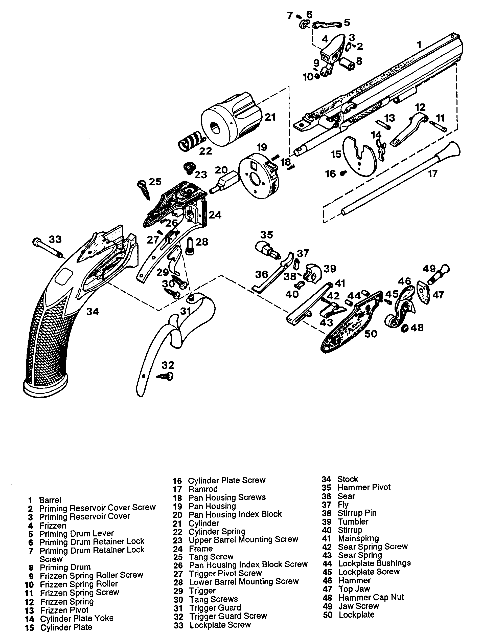

After doing some more research on the Elisha revolver, I figured it did feature single action (see blueprint). This seems to have been really Samuel Colt's invention. The tuned down verison the British government ordered for their officers in india did not include the repriming container, which makes one doubt its reliability.
The Elisha revolver afterall does not look that innovative. I found some similar creations from far earlier periods even though I cannot say how workable they were (considering the sealing issue).

Single action simply refers to having to manually cock the hammer each time you fire, as opposed to double action where pulling the trigger actually rotates the cylinder into positon before the hammer falls onto the cap or firing pin. The gun would have had to be a single action.
Fifty parts showing on the diagram, which speaks volumes about complexity of manufacture and maintenance.

I had a closer look on the priming mechanism in the exploding diagramm. It looks the powder was inside the "priming drum" (no. 8) which will rotate when the whole priming reservoir moves downward. By this some powder will rinse through an opening onto the pan. A spring mechanism will let it roll back again and sealing it by this.
What do you think? Would this really be workable after some fouling occured? What about the danger of blowing up the whole priming reservoir? Is the distance where it rests towards the pan sufficient to prevent this?
Also the priming drum looks pretty small to me. Will it be enough powder to prime the pan for 5-6 shots?
