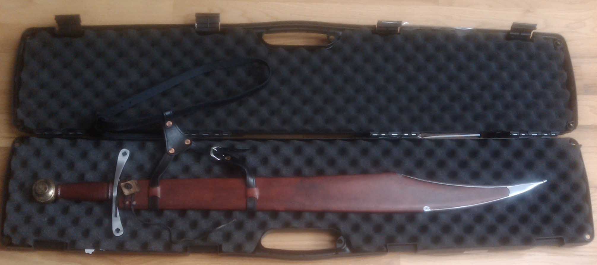

PostPosted: Sat 28 Feb, 2009 11:56 pm    Post subject:         Reply with quote
Hi All,
I have a lot to post but have been very busy. I have to post this though. Here is the final completed THORPE FALCHION:
http://gallery.me.com/christianfletcher1#101266
PostPosted: Sun 01 Mar, 2009 1:05 am    Post subject:         Reply with quote
That came out real nice. Big Grin Cool The pommel engraving, the scabbard furniture and the blade/guard themselves all work together to make a very attractive piece. Cool
PostPosted: Sun 01 Mar, 2009 6:42 am    Post subject:         Reply with quote
Very nice and the closest repro I've ever seen of this one. There are a few differences from the original still, but they're small. Very, very nice. Is the blade by Ollin?

PostPosted: Sun 01 Mar, 2009 1:48 pm    Post subject:         Reply with quote
Hey All,
The Blade is by Ollin, yes. Christian Fletcher and Ollin both did a wonderful job from what I have seen in the pictures. Hopefully I will get the blade and scabbard soon. I need to make sure there is a suspension and belt to go with it as well...
Christian is working on a saber for me next... he received the blade from Ollin, but decided to work on the Thorpe Falchion first...

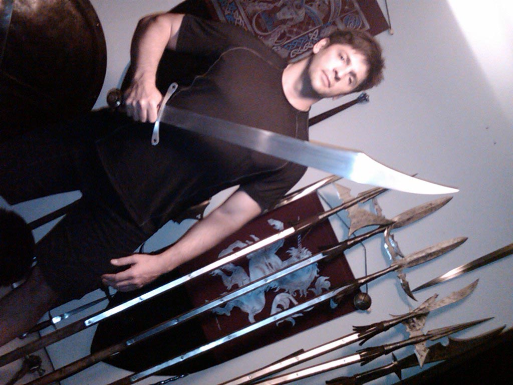

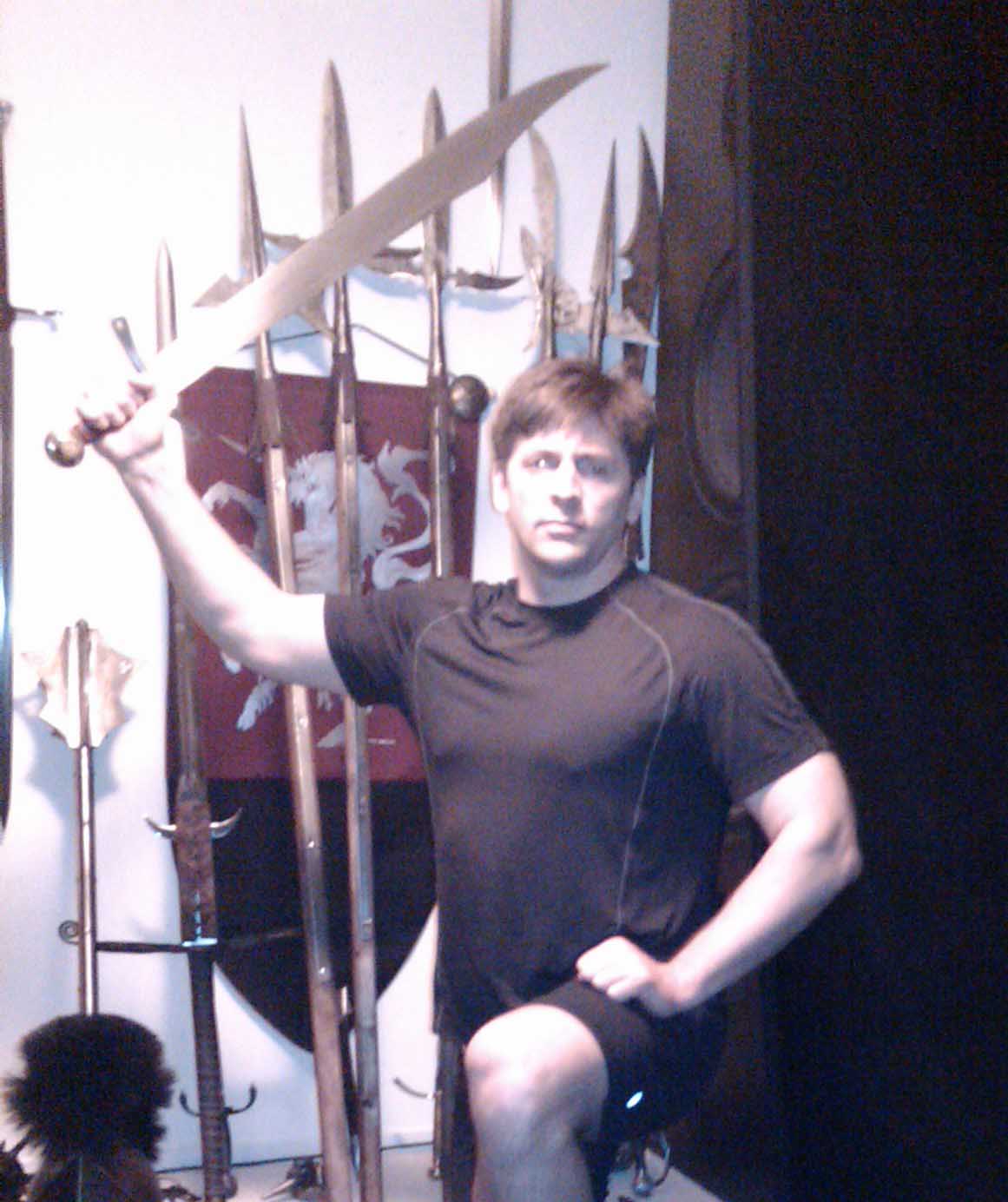

PostPosted: Sun 22 Mar, 2009 10:37 pm    Post subject:         Reply with quote
I still haven't heard from Alan West... he never responded to a couple emails.
In any case, SEE ATTACHMENTS for pictures of the final product in hand:
