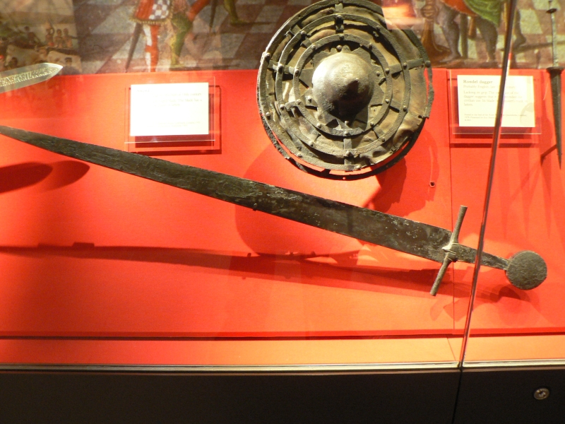

PostPosted: Wed 06 Aug, 2008 3:13 am    Post subject:         Reply with quote
Here is a photo of the sword from the Royal Armouries, Leeds. I believe Eric McHugh took it.

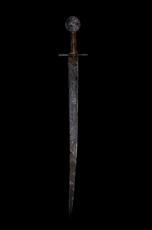

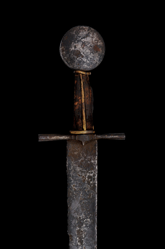

PostPosted: Mon 01 Dec, 2008 12:04 am    Post subject:         Reply with quote
See link, to my untrained eye this looks like another medieval single edged sword:
http://www.czernys.com/auctions_lot.php?oggetto=31706&asta=22
Lot no. 429 A sword
provenence: Central Europe
dating: 14th Century
description: Interessante lama larga, ad un filo, leggermente curva; elso dritto, in ferro, con bracci cilindrici e massello a punta, grande pomo tondo a facce leggermente convesse, resti di impugnatura in legno, con ghiere e liste in bronzo.
condition: poor
dimensions: 85,5 cm.
Using some of the free translation websites:
Interesting wide blade, to a thread, slightly curve; straight elso, in iron, with cylindrical arm and ingot to point, large round apple to slightly convex faces, restive of grip in wood, with ring nuts and bronze strips.
Interesting wide blade, to a thread, slightly curve; elso straight, in iron, with cylindrical arms and massello to tip, great round knob to slightly convex faces, rests of grip in wood, with metal rings and lists in bronze.
These translations don't mention it is single edged, so perhaps I'm wrong.
Thoughts?
Danny

Danny Grigg
Usergroups: None
Posts: 301
PostPosted: Sat 06 Dec, 2008 7:09 pm    Post subject:         Reply with quote
Anders I have no idea. Are there any Italian speakers out there who can translate??
I found another single edged sword, posted by Peter Johnsson:
http://www.myArmoury.com/talk/viewtopic.php?p=49763#49763
It looks very similar to the first sword Chad posted. It might even be the same sword, I'm not sure???
Danny

PostPosted: Sun 07 Dec, 2008 3:27 pm    Post subject:         Reply with quote
from Czerny's http://www.czernys.com/auctions_lot.php?oggetto=31706&asta=22
