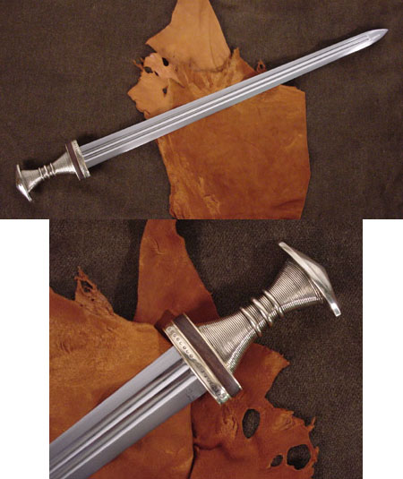

Does anybody have measurements for Albion's old Kragehul Bog Sword? I would like to know how long the crossguard is. Any photos would be great too (of Albion's model or the original) Laughing Out Loud

Here are some measurements from old notes of mine, back when I was shopping for a sword and was racking and stacking a few together (ended up with the A&A GBS, but the Kragehul was a close contender). Anyway:
Price: $520
Weight: 3lbs 3oz
Overall Length: 35”
Blade Length: 29”
POB: 3.5”
I've also attached a pic of the Albion sword. Hope this helps!
 Attachment: 78.55 KB

Thank you all! This helps a lot. I still need measurements for that crossguard, though. It looks like it's shorter than crossguards of later migration era swords. Anyway. Big Grin Thanks again for the input.
P.S: In case you're wondering (not like you are but I'll tell you anyways) I'm taking an old wall hanger and making a hilt for it in this style. The blade is about the right length, but I need to make some modifications to it before I could really call it a Migration Era blade. I have a few salvaged brass pieces to use, but it's still going to have to be an "economy" model... In other words, lots of organic bits. That's why I need the measurements, but I'll probably guess at a few things, so don't break your neck looking for the details. I'll post pics hopefully in a couple of weeks when I finish it. Cheers.

Four inches is perfect! The best piece of brass I've got is right at four inches long I think. I'll have to check when I get back home. It's a curved crossguard from a junker viking sword. I straightened it out and it has the right shape to it, so it's ready to go on. Laughing Out Loud Still, some more detailed pics of this sword would be a great help.

How is the sandwiched guard made on this sword? I can see 5 layers to the crossguard: 1 big brass piece, 1 wood piece, and 3 thin brass pieces. But I can't see any rivets. Glued, perhaps?
