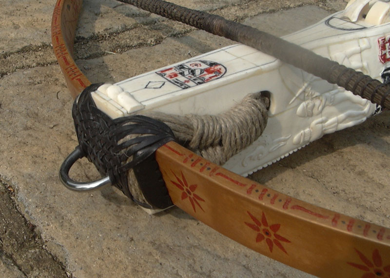

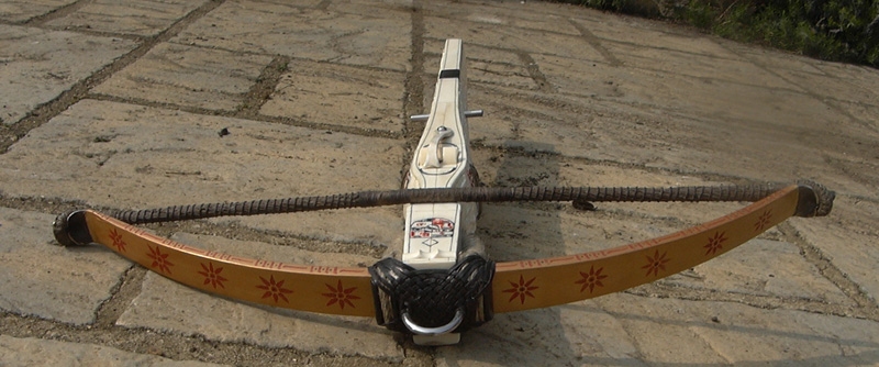

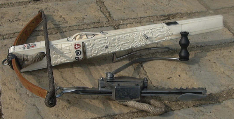

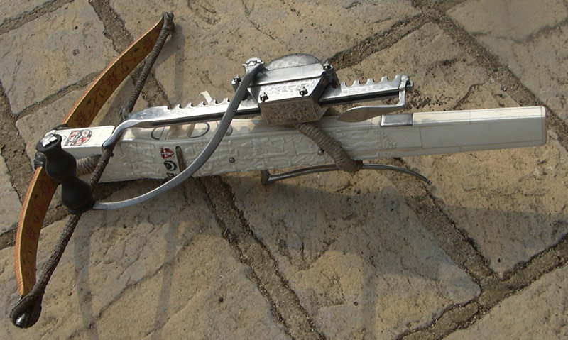

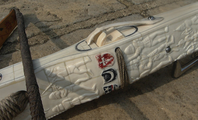

I have just finished the bow - hurrah.
Last time I showed it, it was missing the bolt clip and the bolt rest and rather importantly the cranequin.
I did not make the cranequin, though the next one will be made by me but all work has to cease until that was in place. I received it a while back, but it was a bit rough, so it was stripped down and cleaned up and the etching was applied. Once it was ready I could finish the bow and actually shoot it.
It shoots well.
The new owner will take receipt in two weeks and then I will have somewhere to put my windlass bow so my daughter can stop knocking it over.
Tod

That is one fantastic looking crossbow Tod, can you tell me the dimensions and weight of the crossbow and the cranequin?
How close a replica is this to the original in regards to the dimensions, the materials used, the shape of the crossbow and the artistic design?
Is anyone else out there making excellent replica crossbows like this?
Danny
Leo Todeschini
Location: Oxford, UK
Joined: 12 Nov 2006
Posts: 1,725
(3 total ▮ 100% positive)
PostPosted: Thu 16 Apr, 2009 10:48 am    Post subject:         Reply with quote
The bow weighs in at nearly 5kg, about 12lbs and is about 65cm tip to tip and about 70cm long and the cranequin is about another 2.5-3kg, about 6lbs.
The dimensions are about right as is the weight, but there are some differences. The bow is made by making a wooden stock and this is then clad in bone; this was the first bow of this type I have made and I messed up the internal wooden profile and was too far into fitting the bone to go back and rework it, so the result is that the top flat section of stock towards the back is too wide.
The bone was likely to have originally been whale bone and so was thicker than the bone I was using, or at least they were able to be more selective about the bone pieces they could source and so around the front cut outs just in front of the nut, the scoops could not be quite as deep and they had to be made up from more bone sections than were originally used.
The last difference is in the order the bone was applied to the stock, originally it was the top plate first and then the sides but by doing it in the reverse I could save a great deal of time and that was finacially required, but there are slight form alterations as a consequence.
The design itself is a very faitful copy to the original, though of course the slight form changes means that there were inevitably some slight layout changes.
The design of the painting on the prodd is also a little different.
The result is not an exact copy, but a reasonably faitful one, but really it is more in the spirit of the original and I like to think that despite this it would fit in perfectly as a late 15thC German hunting bow of the time; certainly none of the forms or proportions are anachronistic.
The problem with a comission of this kind is both the funds available and the time it takes up; I would have loved to have reworked the stock to get everything the way it should have been and I wish I had had a load more time and money available to select the bone but my other commitments and the budget means that I had to live with the differences.
I suspect that to rework the stock and reapply the bone again would have been 3 days, changing the bone glueing order would have added another 2 days had I chosen to do this and being very selective over the bone would have added another 3-4 days including the trip to the merchant and onto all this the additional monetary spend. Altogether too much to warrant it.
That all being said I think I may have another order for one coming up.
Tod
