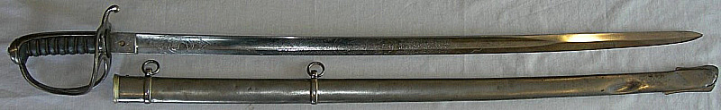

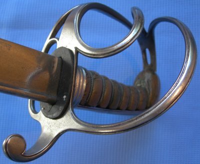

Through the posts and pictures provided by Jonathon Hopkins, I have become interested in the British Pattern 1821 saber, specifically the light cavalry version. This design, introduced in 1821 (accepted in 1822, which is why it is often called the Pattern 1822) lasted more that 80 years into the early 20th century. There are a number of variations, depending on what kind of soldier was using it, and some evolution during its life. It had some critics who said, of certain of those variations at least, that it was badly made and not functional.
There are differing versions for light cavalry, heavy cavalry, infantry officers, artillery officers, maybe more. Oddly, trooper’s swords are worth more now than fancier officer’s swords, because there are more surviving versions of the latter. Around 1845 Wilkinson did a redesign which pretty much carried the Pattern 1821 for the rest of its life.
I know I have to do some more reading, but will write down what I have found out so far. I hope other forumites will lend their expertise and also correct any errors that I make.
Below are photographs of a very early officer’s light cavalry version dating from the reign of George IV, the former Prince of “Whales.” One of the distinctive features of the pre-Wilkinson saber is the “Pipe back” or “Reed back” tube that runs along the back of the blade all the way to the sharp false edge. Also, there is no fuller. This photo shows a very attractive saber, one of the most beautiful I have come across. It has a 34.5 inch blade with a clipped point.

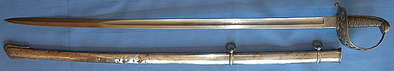

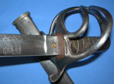

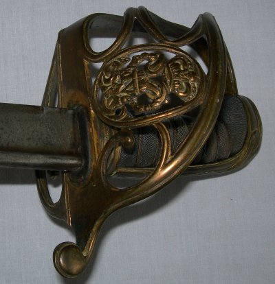

Pictured below is another early version from the time of George IV, the infantry officer version, sometimes called a Gothic hilt because the brass hilt bars looked like gothic arches. It has a 32 inch blade. Note the Pipe back and lack of a fuller. It also has a flap on the inboard side so that it could ride closer to the hip.
This version at least, received some criticism. It is likely that this is the type that John Latham of Wilkinson was deriding when he wrote that it was,
…the worst possible arrangement of hilt, blade and shape that could possibly be contrived. It is crooked but has no regular curve: it is wrongly mounted for thrusting and wrongly shaped for cutting. The hilt is so flimsy as to be no protection to the hand and is made of bad metal poorly tempered.
It is ironic that Wilkinson redesigned this saber shortly after. They did make some changes, but it stayed pretty much the same sword.
There are other critics of the pattern 1821. I ran across a footnote that said that Brian Robson called it a mediocre sword in his Swords of the British Army. George Macdonald Fraser said through his Flashman character that the current cavalry saber was hated by the troopers because it had a greasy metal grip that would turn in your hand. I believe he was referring to the pattern 1821.
So what do you folks think? Are all pre-Wilkinson pattern 1821’s (and maybe later versions too) pretty, but badly functional swords? If it was so mediocre, why did it last so long?
 Attachment: 31.82 KB
 Attachment: 30.88 KB

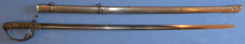

Here is a Wilkinson-made light cavalry saber dating from 1879. Note that the pipe is gone from the back of the blade and that it now has a fuller. The blade is 34.75 inches long.

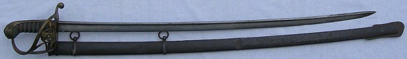

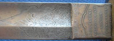

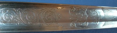

Here is an officer's heavy cavalry pattern 1821, made by a company called Johnstones somewhere between 1861 and 1897. It has a 36 inch blade. Another really beautiful sword
 Attachment: 59.07 KB
 Attachment: 36.29 KB
 Attachment: 15.11 KB
