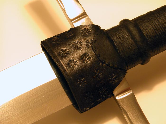

I've finished my own rain guard / chappe project! This isn't a very good photo. In person, the stitching is almost invisible. The flap of grip wrap sewn to the chappe look a bit too plain to me. Maybe I'll add something to that--a slim border? It's very thin leather, so I doubt it would take the "star treatment".
See more info about the whole project here: http://www.myArmoury.com/talk/viewtopic.php?p=137293#137293
Thanks for the help, folks!
