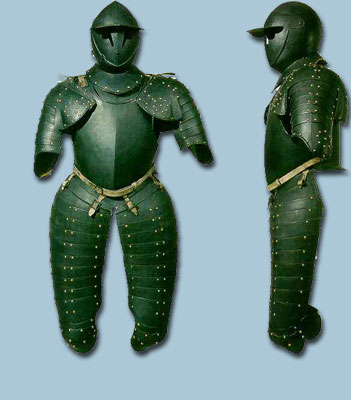

PostPosted: Tue 13 Oct, 2009 9:31 am    Post subject: Colored armor Reply with quote
Hi there!
I know, in the past centuries, people were able to craft blackened armor, just wondering,on this picture, is this colour for amours authentic? If yes, how could they made it? And what other colours were pervading (for example in the 15th century)? Thanks for every answer you post Happy

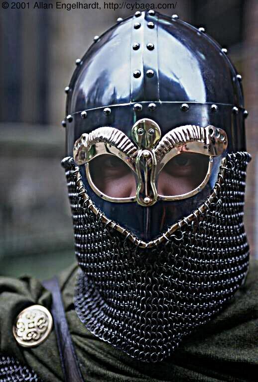

PostPosted: Tue 13 Oct, 2009 10:12 am    Post subject: Reply with quote
Thanks,
Well, I know, how to blacken armor with oil, my problem is with other colours Happy If I warm up the armor naturally, I can make a blue-purple like colour, and some other ,depending on the temperature. But the green is not the natural colour of the steel, so that's why I am a bit confused. And for example, blackening, my favourite is the "shiny"-black(attached picture). Dont know, how can it be made (blackening with oil gives a dark surface), if somebody knows the way to do it, please share it with me, because, I would like to make my own armor into that colour.

PostPosted: Tue 13 Oct, 2009 10:58 am    Post subject: Reply with quote
I believe that armour is actually black, but the photograph makes it seem green.

PostPosted: Tue 13 Oct, 2009 1:21 pm    Post subject: Reply with quote
To get the nice shiny black, first do a high polish then heat it like you would for blue but just take it up to black.

PostPosted: Tue 13 Oct, 2009 2:11 pm    Post subject: Reply with quote
The armour in the original post is black. The greenish tint is due to lighting, printing or digital processing. The only olive green armour is on the modern battlefield. Big Grin

PostPosted: Wed 14 Oct, 2009 1:07 am    Post subject: Reply with quote
Here's a quick Photoshop colour balance adjustment that I think might be a bit closer to reality.
