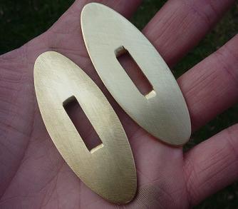

Posted: Sat 14 Nov, 2009 1:11 pm Post subject: |
I have once again change my mind about the wood. The piece of hornbeam that I have is not cured yet. I underestimated how long this would take. The piece is about 2 feet long and about 5in in diameter. It was only cut about a year and a half ago, which in the language of super hard Hornbeam equals too high of a moisture content as of yet I cut off the end of the piece past where it had split, and by the next morning the end was splitting. Any advice on wood and curing would be appreciated. I went ahead and ordered a block (8X8X3) of Walnut online. I know Walnut has never been documented historically, but I hear it is "a nice wood to work" (Matthew Amt Legio XX Website. Very helpful site by the way). The wood should be here by Tuesday! Also I should be able to get enough wood out of that block to do three or four more gladii.

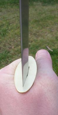

The second thing is that i finished the brass cross guard ( the second one I had made for this project), and it fits very well without any side to side movement. I discovered part of the problem which was that the tang was actually thicker somewhere in the middle. In order to get past it you would have to make the hole larger then where it will finally rest. I tapered the tang and took it very slow with material removal until the blade sat nicely against the cross. GO SLOW LUKE!!!! I get too excited sometimes.
Here are some pictures of crosses. Also a picture of the fit on the tang.
The new cross is closer to my fingers.

Ken Speed
Posted: Sat 14 Nov, 2009 2:13 pm Post subject: |
Luke,
Nice fit on the tang, good job. You might want to consider wearing a dust mask when you're working the walnut, some people have pretty violent allergic reactions to walnut wood dust.
Ken

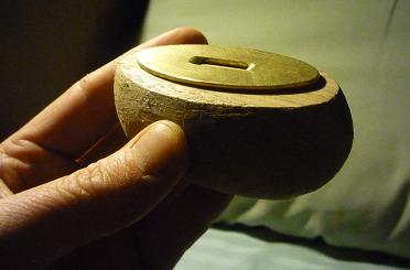

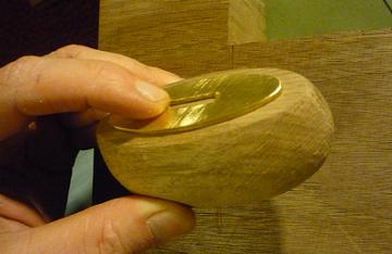

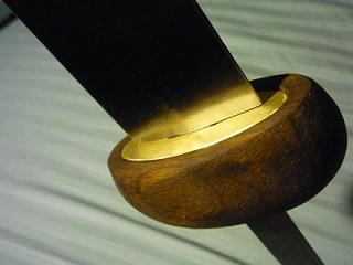

Ok here is a quick mock up of the wooden portion of the cross. The block of Walnut I received is beautiful, and i cut a rectangular chunk off of the corner of it for the cross. A sureform made quick work of it, and yet it feels plenty hard. After a good soaking in my linseed tank it should get even harder and obviously much darker. The brass piece will be countersunk into the face I am very pleased with the overall shape of this part and can only see minor things that have to be tweaked. Now I just need to be very careful when cutting out for the brass, and try not to blemish the rim. Maybe I should have cut out for the brass piece before I shaped the body of the cross. I have a feeling it will be a lot harder shape the pommel to be close to my original plan
Just added the picture of the fitted cross guard. I took a chance and hand drilled the hole out for the tang. I can't believe how dark the walnut got after sitting in linseed oil overnight. I think I will place some shims in between the wood and the tang to make things even more secure when fully assembled.

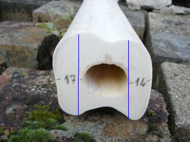

A tip: for the grip, bone of cow tends to be fragile for combat can be a problem.
Bone giraffe is very tough and elastic. Perhaps less historic, but very functional.
The difference is not seen, the color is equal. I hope this helps.

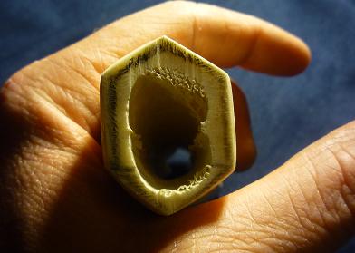

Posted: Mon 23 Nov, 2009 3:37 pm Post subject: |
Fellow Forumites,
I stopped by the local pet store today on a whim, with the hopes of finding a suitable bone for the grip. This was the same store I had check several months ago for bones of the right size without any luck. I found a very suitable bone for this project and have been neglecting my microbiology homework for the past three hours to shape it! I have stuck to my original hexagonal cross section. This is the first time I have tried my hand at carving bone, and I will admit the smell will take some getting used to. Also my dog will not stop giving me the stinky eyeball from across the room... he is very confused as to what I am doing, and must be wondering why I have not relinquished this stinky bone.
Other developments include the crafting of a completely different wooden cross. I had gotten impatient again and ended up taking a huge chunk off the rim around inset brass part. I was very mad! The new cross is more refined, less clunky and has a more elegant look and feel. it is soking in the linseed oil tank right now and have very beautiful grain and color. (I really like that walnut I bought) In addition to the new improved shape, the inset portion has been done much better this time around. The brass piece actually sits down in the wood and is about 1mm from the top plain.
In all this project is a delight. I am learning so much. Thanks for all the comments.
Maurizio,

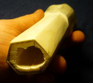

Thanks for the advice on the giraffe bone. The only problem is that I don't know where to get giraffe bone and was a little reluctant to in the first place as giraffes are not as common as cows. After working this material for three hours I cannot imagine it will be to fragile in any way. It makes sense that a giraffe has denser bone being that they are so adapted for outstanding height. and a heavier animal in general. Also i can imagine that giraffe bone might be accurate since the Romans had a lust for exotic animals. That picture of your son is very cute!
Ken thanks for the nice comment. I have worked on potters wheels and that take a lot of rock solid steadiness. Perhaps that is where I get it from.
Anyways here are some pic of the grip in progress.
Attachment: 32.08 KB
Attachment: 22.67 KB
Ken Speed
Posted: Mon 23 Nov, 2009 3:48 pm Post subject: |
From Luke's comments about working bone and a friend's comments about the horrific stink involved in making a horn knife handle I think I'll stick with wood. I am, however, curious; what does one use to fill the cavity in the bone where the marrow used to be?
Ken
Luke Zechman
Location: Lock Haven Pennsylvania Joined: 18 Jan 2009
Posts: 278
Posted: Mon 23 Nov, 2009 4:07 pm Post subject: |
As of right now the tang does not fit inside the bone. Also you will notice that the hole is a little offset. when I get in there and work the inside with a round double cut file I will remove material from the thick side. I will do this slowly and with care until the fit is tight. When i do the final assembly I will wedge the grip into place with either wood or scrap pieces of brass left over from the hinge I cut the cross from. I was also thinking of cutting a small recess into the cross and pommel to secure the grip where I want it but I want to find out if this is historical first. I feel that with some wedges and the tang being peened that the grip won't be going anywhere. If anyone has any advice as to how to do this securely then let me know... Thanks all!
Hadrian Coffin
Location: Oxford, England Joined: 03 Apr 2008
Posts: 404
Posted: Mon 23 Nov, 2009 4:50 pm Post subject: |
I would advise getting a decent respirator, bone dust can do nasty things to your lungs!
