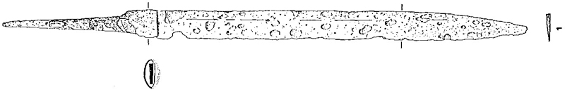

Here is the largest I have seen which gives dimensions...
It is a Type 1/3 from Beigaben Germany.
Total length is 84cm, maximum blade width is 46mm and maximum blade thickness is 7mm
Image is from "Die Alamannen im Zollernalbkreis" by Georg Schmitt, Dissertation 2005

Thanks G Ezell and Kirk .
those are great the broken back seax is quite a nasty (in a good way) kind of beast ,it is quite interesting how just subtle changes in the form of broken back seax can completely change the whole look of the blade ,they are some of the most ugly and also compelling blades around . I found them very blocky when I first started making them but the more I see and the more I make, the more I like them .It is amazing how the way you view something is so completely influenced by your relationship with it.....The observer influences the observed...............
seeing the seaxes along side swords does bring up questions about there role along side or instead of a sword .
Kirk that is just what I am looking for thanks .
