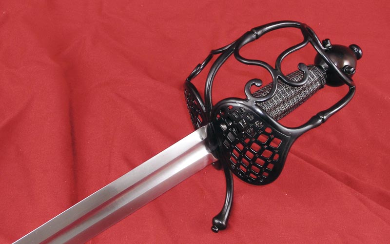

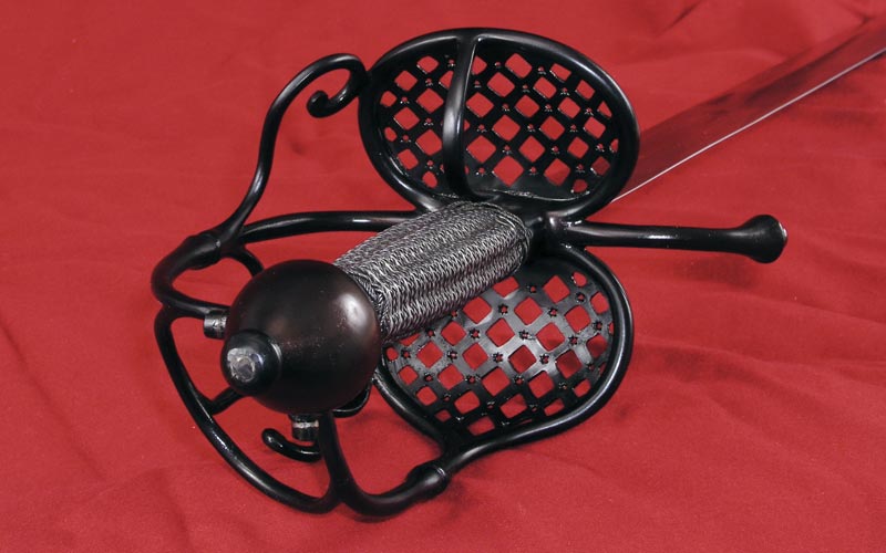

PostPosted: Fri 16 Oct, 2009 9:15 pm    Post subject:         Reply with quote
I’ve had the sword for more than a week. Here are some thoughts.
First, some dimensions: (in inches)
Blade length – 32
Overall Length – 38.75
Blade Width at hilt – 1.375
Blade Width at 3.75 from tip – 1.250 – not much profile taper – then it curves in to the point.
Blade thickness at hilt - .185
Just below ricasso - .160 (The ricasso is about ½ inch long)
– 5 inches down blade - .145
- 10 inches down blade - .145
– 15 inches down blade - .145
– 20 inches down blade - .130
– 25 inches down blade - .110
- 30 inches down blade - .100
COG – 3.5
COP - 22
Weight – 2.8 lbs
It’s interesting, that from 5 to 15 inches the blade stays at the same thickness. Overall distal taper is 54%.
Handling: The sword feels like it weighs more that 2.8 lbs. This is probably caused by the fact that there is almost no profile, and a rather unusual (to me) distal taper. At first I was unhappy that it didn’t feel as handy as a Tinker or ATrim blade, but after a few days, my arm, wrist, and fingertips have adjusted to it, and it has started to feel pretty good. It is definitely more cut than thrust. I have a midsized hand, and it just brushes up against the outboard hilt-branch. It’s lucky that the loops on that branch are so subtle – the lobes on many 17th century hilts resemble abacus beads, and would have scraped the back of my hand.
Appearance: This sword is, of course, extravagantly beautiful. Whoever designed the original 17th century hilt was a real artist. One would think that with so much hilt work on the outboard side, and only one scroll on the inboard side, that the sword would look unbalanced, but it just looks incredibly interesting. Unfortunately, most of the photos I have show the outboard side where most of the scrolls and branches are prominent. If I ever get a digital camera, I will post some photographs of other angles. This sword looks great from every viewpoint..
I think that bluing the hilt may have been a mistake. It still looks great, but some features, especially on the pierced plates are somewhat obscured. If anyone wants to get this sword from A&A, you may want to leave the hilt unblued, or put a subtler finish on it. I also haven’t made up my mind about whether the thumb ring/loop is a help or if it gets in the way. The original doesn’t have one, but I am a thumb ring nut and asked A&A to put one on the hilt.
The scabbard: I got the $95.00 scabbard which is OK. I always think that any new sword that I buy will fit one of the scabbards that I already have, but it never works out. This case was no exception – it didn’t fit one of my better looking scabbards. Mad
In closing I’d like to thank some people for their help and/or encouragement in the creation of this sword – forumites Nathan Robinson and Justin King – also Stuart Ivinson of the Royal Armouries Museum at Leeds, and of course Craig Johnson and everyone else at Arms and Armor for going the extra mile in making this sword a functional work of art.
 Attachment: 87.05 KB
From 1678 - The kind of soldier who might have had the original

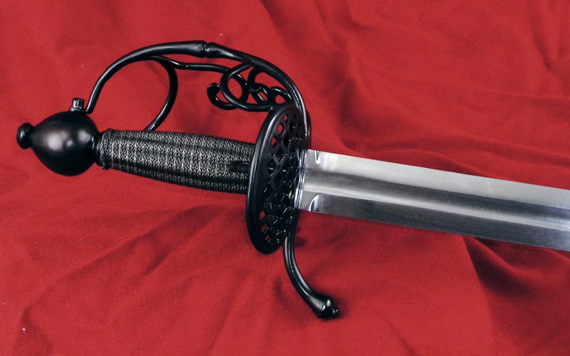

PostPosted: Fri 16 Oct, 2009 9:34 pm    Post subject:         Reply with quote
Roger,
Thanks for posting your thoughts about the sword! I absolutely love this piece. The handling sounds like something that I'd really like. I don't personally care for the overly agile sword replicas that are often created. They wouldn't really correctly represent this type of sword so I'm happy to hear that it handles as it does.
I agree with you about the blackening. I think that a cold blue would have been my choice. I'd have then polished it back to gray again, leaving some darkening in the recesses and emphasizing the shaping rather than making it more subtle. Having said that, it still looks fantastic blackened and likely similar to many pieces of the period of the antique that inspired your sword. In fact, I think the aesthetics are very much in line with that era and type of weapon.
Attached are some additional photos of your piece that Craig took.

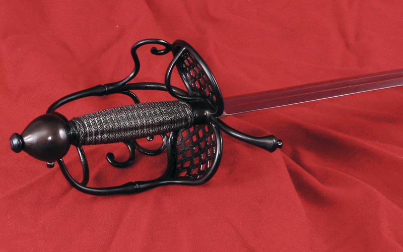

I took a look at the sword. Too bad you can't save photos from Hermann Historica anymore (at least I don't know how to do it)
It's definitely in the same sword genus, though perhaps a different species. There are a number of these types of swords around, though none seem to be exactly like another. Each his its unique combination of features. As I mentioned in the first post on this thread , Cyril Mazansky has a chapter of his book, British Basket-Hilted Swords, devoted to this type. He calls them Hilts Based on Side Rings with Pierced Plates, a rather ungainly name. They were prevalent around the second half of the 17th century, all rather beautiful. I think the one mine is based on is the best of them all.
 Attachment: 99.48 KB
Just for fun, another photo of my A&A version

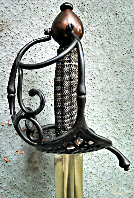

PostPosted: Mon 24 Nov, 2014 4:29 am    Post subject:         Reply with quote
Finally a picture of the sword from Herman Historica.
