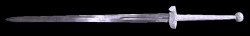

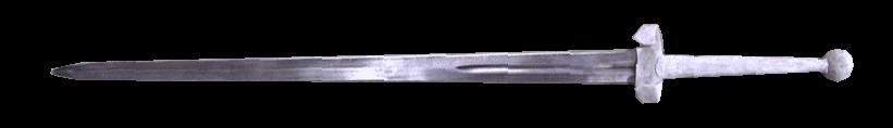

I took the liberty to quickly adjust the griplength on Sean's claysketch photo just to give an idea on what it might look like with longer grip. I think it works just fine. I just added about 4" to the grip but it's offcourse possible to add even more.

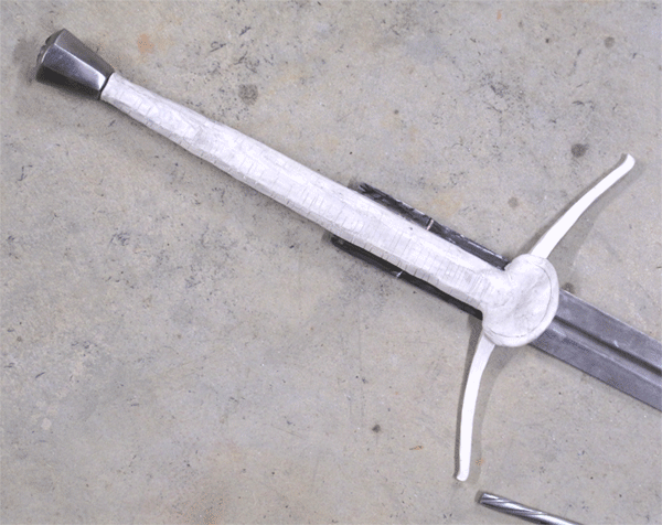

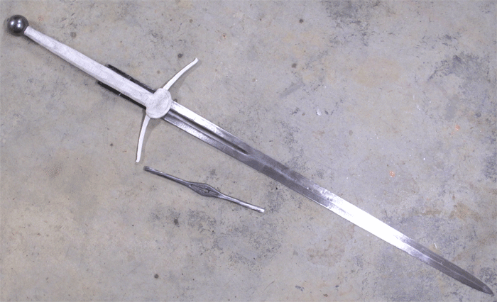

Here's where I am as of today, with a new clay model. There are two options for the pommel. The globular option would have to be flattened a bit. I think it's too perfectly round as it is.
Ideally, the cross would be longer but I'm using the longest one I have. The cross will probably need to be thinner than in my rough model, and I'm not sure about the upturned ends of the cross. I saw that on one of the swords in Bruhn-Hoffmeyer and just wanted to see how it looks.
I might make the grip even longer than it is. In this model, the grip, cross and pommel are a little less than 1/3 the total length of the weapon. The grip could be, perhaps, 5 cm longer.
The clay is much heavier than the finished grip core will be, and there's still all of that thick ricasso to remove, but my initial guess is that the POB will be 3-5 cm below the cross. I have a feeling this is going to feel more and more like a short polearm as it comes together. With the long, downturned cross and two-hand grip I can see that this sword would have a very strong defense. I'm guessing that the leverage it could apply against an opposing sword in the bind would be impressive (and deadly for the opponent). Also, since you would be able to easily use this sword with the back hand below the pommel and the front hand at the middle of the grip, the opposing blade could be kept well away from the hands.
It's a fascinating project. Not even close to my main period of interest, and I know I'm not doing the type justice, but it is fascinating, illuminating. Happy

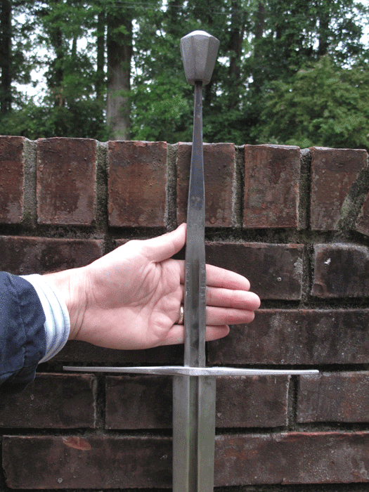

Just a small bit of progress. I've decided to go with the faceted pommel, which seems to be common up to 1450. I now have the very rough pommel and cross. Next step is to curve the cross. I'm worried that it's a bit too narrow in section but, judging from the various photos, I think it might just be within historical parameters. As shown here, the piece balances at 57mm below the cross. The grip core will be poplar, which is relatively light, so I'm expecting a final POB of around 50mm, maybe slightly less.
