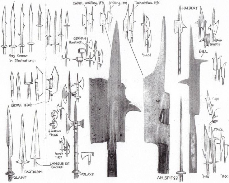

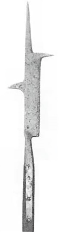

PostPosted: Mon 04 Nov, 2024 1:37 pm    Post subject:         Reply with quote
A bit of necromancy.
An individual posted a picture from an Osprey book seeking to figure out how to classify a certain polearm in hopes of finding more about it. A reverse image search using just that item brought me to this thread, as it also has the original picture showing it and two items clearly qualifying as "halberds".
Thought it was in Waldman, but is not, and I can't find any other illustration of it, though it looked familiar and I thought I had seen it before. I concluded it would likely be classified as a form of "bill", and my search for the object this morning turned up a copy of the same picture with drawings and annotations that called it a bill as well,
With all of the expertise running around here, what say you? I've included an extract of the item in question, as well as the "enhanced" version of the picture/illustration.
 Attachment: 17.79 KB
"Bill" or otherwise?
 Attachment: 82.15 KB
A bit of an agglomeration where someone has labeled it a "bill".

PostPosted: Fri 08 Nov, 2024 11:33 am    Post subject:         Reply with quote
I think that polearms are very hard to classify, and there is a tendency to treat different terminology as representing a typology. I would probably call that a bill, although it might be called a glaive with spikes.

PostPosted: Fri 08 Nov, 2024 1:09 pm    Post subject:         Reply with quote
I'd never consider it a glaive: no belly to the cutting edge, and the spike on the cutting edge side is something that disqualifies it entirely in my mind. You see examples with a guard spiked on either side, but any examples with some type of spike or other protrusion from the blade shows such protrusions coming from the spine of the blade, not the other side.

Some might call that a roncone. But then some would call a roncone an Italian bill Confused
I think we can attempt to be more precise about typology than the people who actually used the things were.
Anthony Clipsom
Victor R.
Location: Klein, Texas
Joined: 28 Jan 2008
Reading list: 4 books
Posts: 372
PostPosted: Sat 09 Nov, 2024 4:19 pm    Post subject:         Reply with quote
Based on the examples in Waldman and things I've seen in other places, the roncone/Italian bill/scorpion all seem to be variations with a common ancestry, probably shared with the earliest halberds - a blade with a spike, and then a beak protruding to catch a horseman and pull him down. Probably an orchard tool or other farm implement, from which so many pole weapons seem to have been derived.
And I'm sure we're all much more "precise" (or anal) - I doubt typologies existed in the Middle Ages and Renaissance, at least in the ways we do it.
