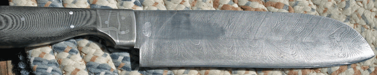

This is coarse (80 layer) pattern welded blade I forged Easter weekend. I had Bob Levine finish grind it and make the holster. The sheath is patterned after the style Texas rangers carried. Sharpened blade section is about 5" (13 cm) long.
 Attachment: 83.49 KB
 Attachment: 110.49 KB

The Texan knife was an experiment to see what would happen if one minimizes grinding. It was actually twisted about 10 times during intermediate stages of the folding. Simply forging the twists flat back into the billet "smudges" the layers, and does not achieve the legendary "serpent in the sword" effect to the same degree as grinding after twisting. Some evidence of the twisting operations are better seen on the reverse side that I did not post before.
In comparison, the 9" twist knife with wood handles was twisted about 16 times and had material ground away evenly from both sides. Although it is only one simple experiment, the historical implications to me are that pattern welded swords of Migration era most likely had some stock removal involved to elicit the sort of surviving written comments that they did.

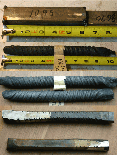

first simple composite
I had some surprises and fun yesterday at the blacksmithy. I have been working on the most simple possible composite, two billets of opposed twist. I wanted to try welding two billets together, with a long term goal of replicating the classic center section of migration era pattern welded sword cores. I should have realized that it was going to grow into a 20" long by 2" wide by 1/4" thick piece of blade stock since it started out near 2 lbs mass. But, I did not think of that and got into quite a bit of new territory such as welding in sections, and handling a very large floppy blade sized piece of metal near the end of flattening it out. Anyhow, attached are some pictures of the stages of billets, and a preliminary rough ground etch of the blade which should be heat treated by the end of today.
 Attachment: 87.64 KB
 Attachment: 82.69 KB
 Attachment: 186.52 KB
