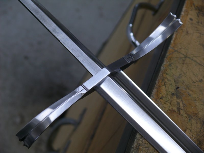

One of the progress pictures I got from Peter at regular points while he was working on the sword. This is one of the better pictures I have available of the quillions

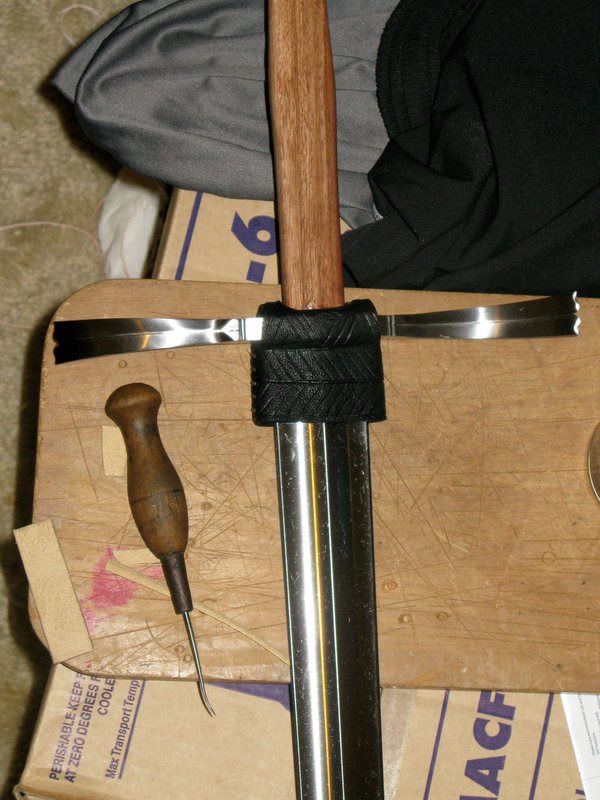

This is the temporary experimental chappe / rain guard I made based on one of the finds from Dordrecht. When I've built the scabbard and can properly form the chappe to it I'll make a more ornate one. The leather is a heavy pit tanned goat, from Pergamena

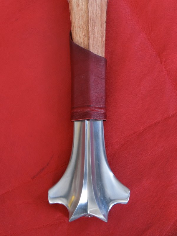

A good shot of the pommel. The bit of leather wrapped around it was a brief test of what I plan to cover the grip with. It's pit tanned goat bookbinding leather from Pergamena and it's about as good a leather for this job as you'll get for any money.

I fancy the guard details so much that I almost think it's a pity to partially cover it with a rainguard shape Happy

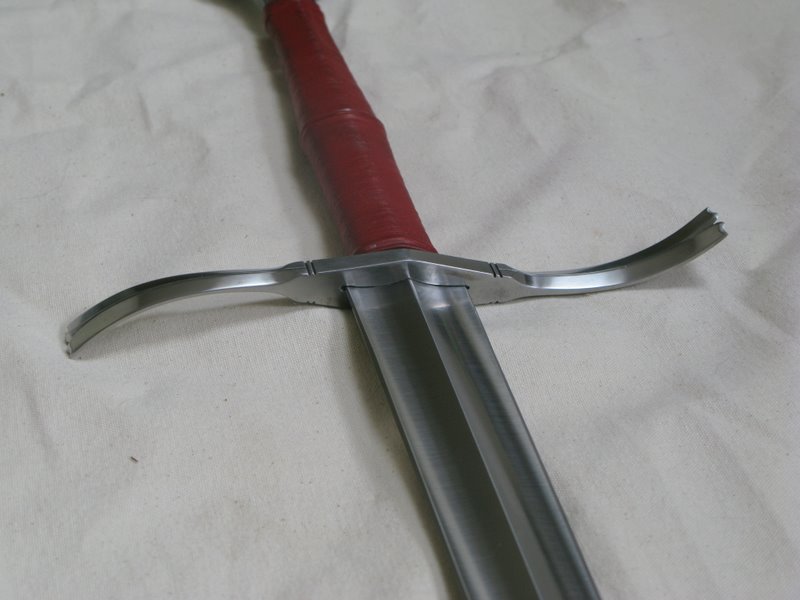

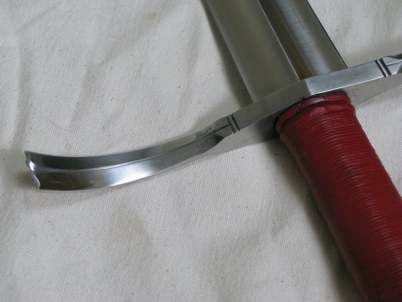

This sword is gorgeous! I am curious about the ends of the quillons, are there any historical examples that have the fishtail shape like this one or is it a bit of creative license? Make sure to post up some finished pics as soon as you have them Al!

The Albion Burgundian quillons are shaped in a similar way...here is a quote from the Albion's website: [The guard shares some elements of design with the pommel, in the cutouts and ridges that define the shape. This is unusual in Medieval swords where the guard is normally quite distinct from the pommel in character. Sometimes there are exceptions...]
So I guess there must be some historical ground to this (though I have no pictural examples at hand)...if anyone as a pict of museum/period art example, I'd love to see that.

Julien, now that you mention it you're right, I think the Burgundian quillons were one of the things we looked at so my original statement about them probably isn't correct. The design discussions for this one were well over a year ago so I don't fully recall all the things we looked at. I originally brought Peter pictures of that sword as an example of a style of fishtail I'm not particularly fond of. Neither of us have actually handled a Burgundian though, so I don't know what if any similarity in execution there is between the two swords.

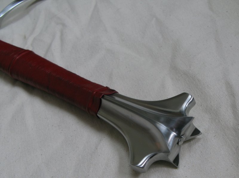

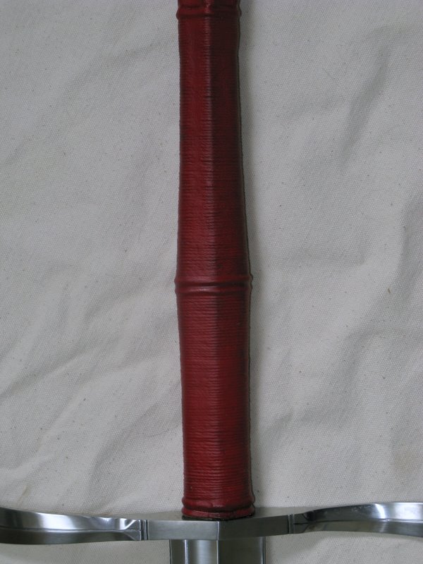

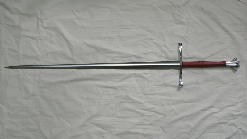

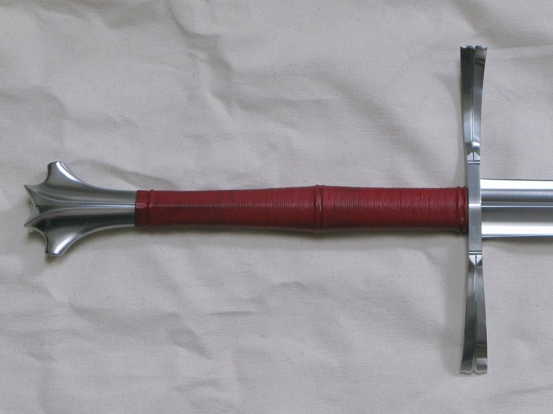

We're having a rare day of sunshine today so I put the sword under the skylight and took some more pictures. Sorry about the wrinkly background, it's all I had lying around.
I did a leather over cord grip wrap last night. I'm not happy with it but it'll do for now until I've got the scabbard done and I pull it off to do the chappe. It's all done with hide glue so it's trivially, if messily, reversible.

That's a beautiful sword and I think the red color of the grip was a great choice. I'm curious why you aren't happy with your grip? It looks quite good in the photos.

Thanks. The red just happens to be the colour of the leather sample Pergamena sent me . It works well though and I'll be ordering more for other projects. It was a much brighter red before but darkens up well when wetted and glued. I may leave it red but my original plan was to make the grip black or brown. I think red was quite a difficult colour to do with medieval leathers and I'm unconvinced it was terribly common, but we'll see.
That's because I didn't post any pictures of where it went wrong Big Grin Really though it mostly came out well, I'm pleased with the texture and the crispness of the risers, but it comes much too far up the pommel and the overlap at the pommel end is badly skewed. That might be fixable by wetting it off again and rearranging the fold over but the whole grip cover is about 5mm too far up the grip. I also had trouble forming both the underlying cord wrap and the leather to the concave faces of the upper portion of the grip so there's no cord texture there. I have a Cunning Plan to fix this but it'll need a new bit of leather (which I have and am carefully saving). I got the hide glue consistency and quantity better this time than on the test pieces I did where the glue gelled and built up in a blob behind the overwrap really badly but there's still a bit of a bump up at the top of the grip where surplus glue ended up.

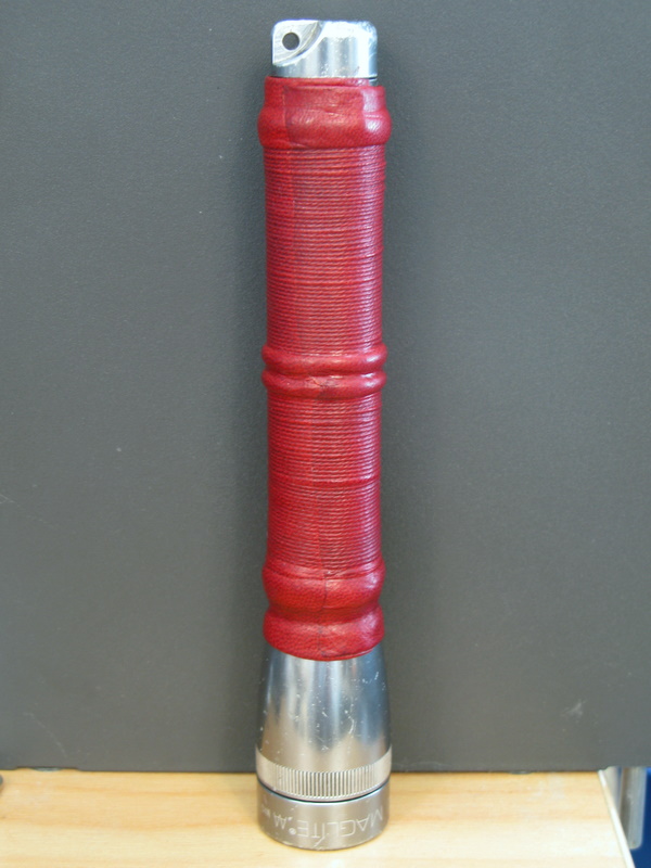

Here's my test piece. The overwrap cord is much finer than I used on the sword but the riser cords are the same. They're really blobby here but came out much sharper on the sword. I now have a nice unique maglite though.

Love the red color of the grip! Maybe you can tap a new market with custom maglite grip wraps! Laughing Out Loud
It did however make me look at my own dull, boring flashlight with inspiration. Well done!

It's in a great deal of period art. Further, it was not a difficult color to achieve in fabric. The dye was readily available.
Please allow me to tell you that you're being much too harsh on your skills... a trait we all probably share!

Absolutely stunning. The red leather sets off the anodized aluminium very well.

Really, that sword is unbelievable. I know a rain chappe is a very interesting bit of detail, but the pure gothic severity of the sword as it stands is, well, earthly perfection. Congratulations to both craftsmen!!!
Al, thanks for sharing that "in progress" photo showing the tang. I don't recall ever seeing a sword where the spine (and general section) of the blade continued through the grip like that. Can either you or Peter speak to any historical precedence for that?
