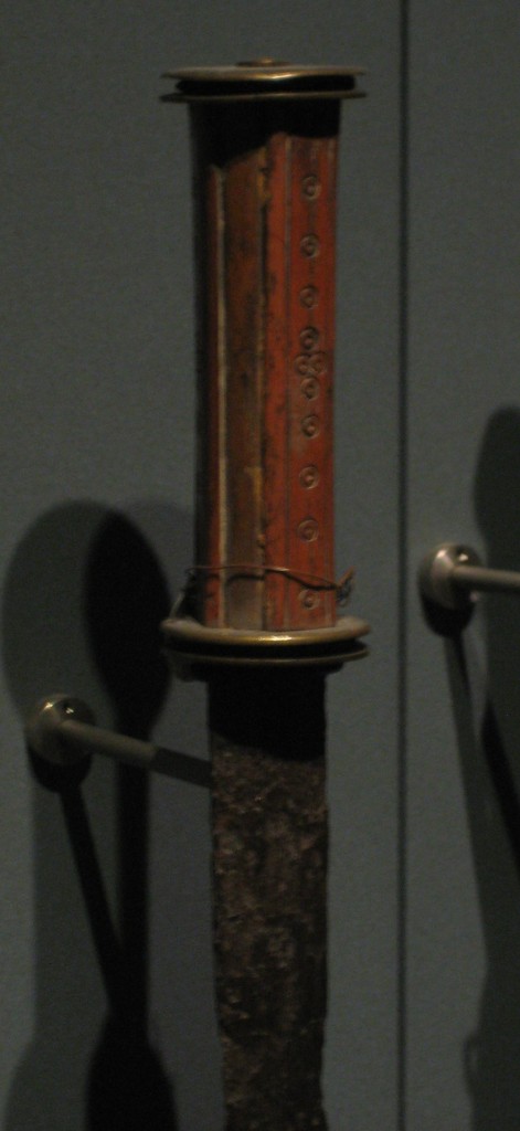

PostPosted: Sat 31 Dec, 2011 11:27 pm    Post subject:         Reply with quote
Here's two of the second type you asked for...

Todd Hawkins
PostPosted: Sun 01 Jan, 2012 9:10 pm    Post subject:         Reply with quote
Excellent pictures, thanks Tim.
Do you happen to know what "material" the rondels on the first dagger are made of?
On the second (red handled) dagger; do you know where it's located, and it's date?

Tim Lison
PostPosted: Mon 20 Feb, 2012 7:44 pm    Post subject:         Reply with quote
Sorry, I must have missed it when you asked the first time. The red handled dagger is in Paris, I believe. The Musee d' Armee if I'm not mistaken. As for the date I don't know. Maybe someone else will know... Here's a full length shot.
