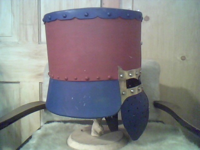

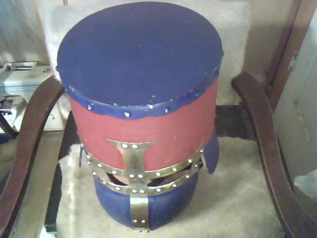

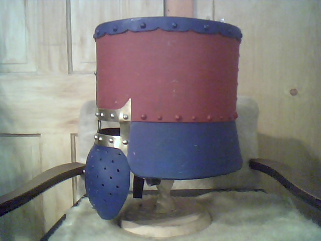

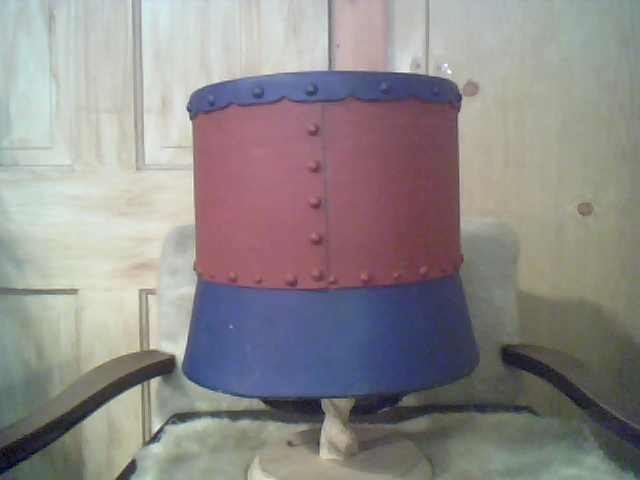

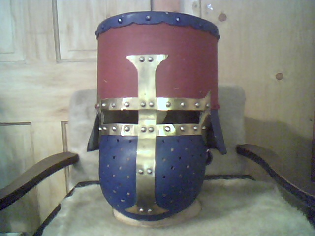

I have a great helm that I just could not keep the rust off of so I decided to paint it. I used the bead blast to remove the rust. I then used oil free compressed air to remove any dust left over from the bead blast. I then washed the helm with a mild detergent to remove any left over oil from the surface, towel dried the helm very thoroughly and then placed the helm in our cold oven range over night. This is an excellent place to remove moisture from something if you need it very dry.
For paint I went with a modern approach and used Rust-oleum primer for the base paint, putting on three thin coats over a period of three days. I then used a permanent, water based, all purpose acrylic paint that I purchased from our local hobby store. My finished colors were Maroon and True Navy Blue and both colors were in a flat finish.
I used a white primer for the base color for two reasons. First it allowed me to put on thing even coats of the acrylic paint because it would show through the coat and this enabled me to see if I had any thin or heavy areas of paint. It took four coats of acrylic to completely cover the white primer which I applied over a four day period.
The second reason for using a white base is it will actually brighten up the darker color you put on top and since I was using a flat finish with my colors I wanted that little extra brightness to my finish.
This combination has stood up very well so far and I have gotten some very good comments on how the helm looks.

PostPosted: Tue 31 Jan, 2012 1:19 pm    Post subject: Rust         Reply with quote
I have some pictures of the helm I described in my previous post. I hope that they come out OK. I am not exactly a computer person.
As you can see there is some scratches on the helm but overall it has held up quite well.
Regardless what method or paint you choose to use, Good Luck and I look forward to seeing pictures of the completed project here in the future.

Just some clarification.
As for the primer showing through: When I had primer showing through my top colors it was for just the first two coats of paint and helped me get the early coats even and thin. By the end of the third coat you could see no primer and after the fourth coat the color was even across the entire helm.
For chip repair I use the same primer for any bare metal that is showing. I apply it by spraying some paint into a small container and applying the paint to the chipped area with a brush. This allows me to get the paint only where it is needed and eliminates over spray. After the paint has dried and cured I then cover it with the top color. Repairing chips in this way has worked very well for me.
Also, I have not needed to oil my helm since I have painted it and I am not sure if oil would work for me since I used a water based paint for my top coats. However, if you use paint that would not be adversely affected by oils then it would be worth a try.
