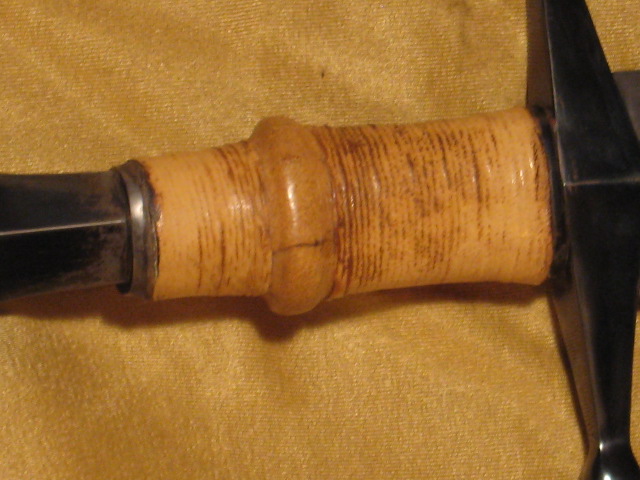

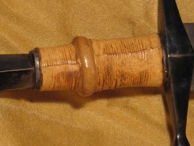

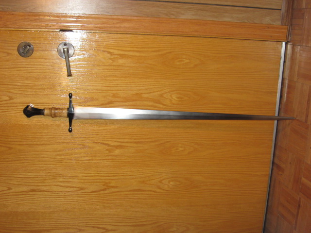

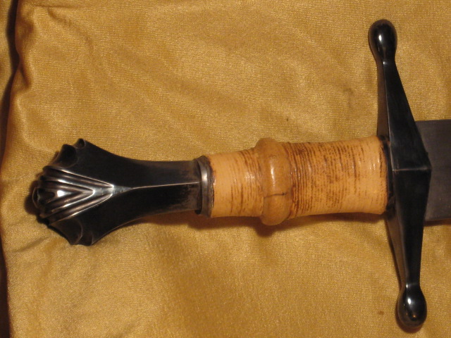

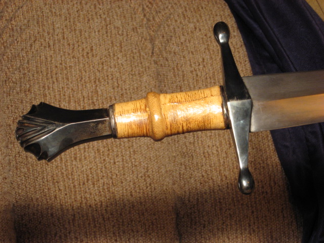

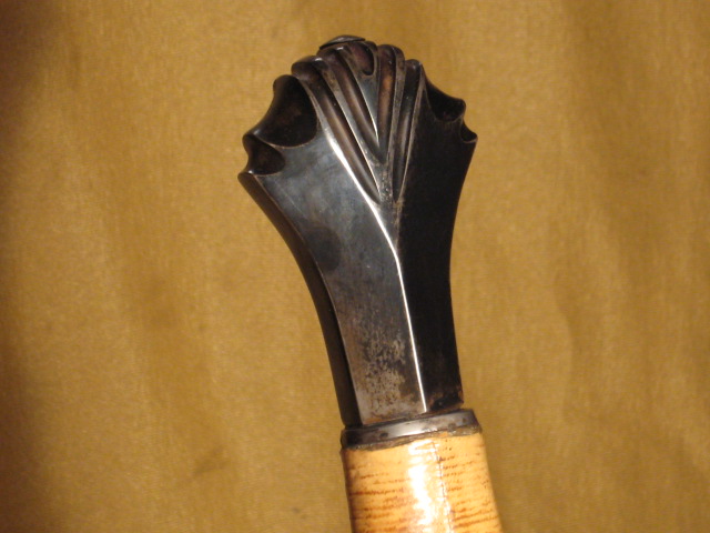

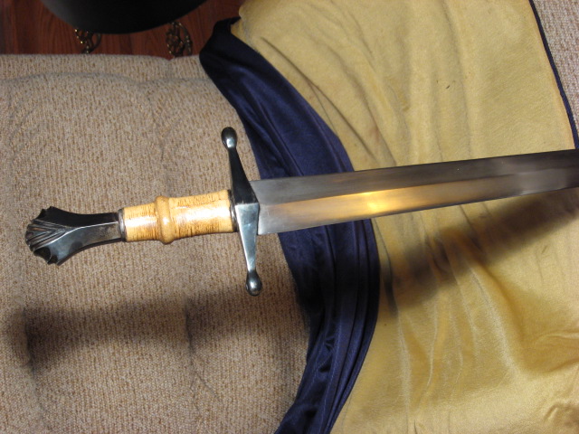

Hmmmmm: Took about 5 years for me to take the camera for a spin earlier this year, but finally I have been taking pics for a while now and better late than never.
Here are pics of the Dordogne " Upgrade ": Old suede grip replaced by chammy leather, natural color with some campaign staining. ( My first attempt at wrapping a handle in leather, so the seams are sort of visible but I like the new shape of the grip. ).
Two layers of leather with the riser covered and seam on one side and the next layer in two sections with the seam on the other side. The riser is a thicker piece of leather if I remember correctly as I did this in 2007.

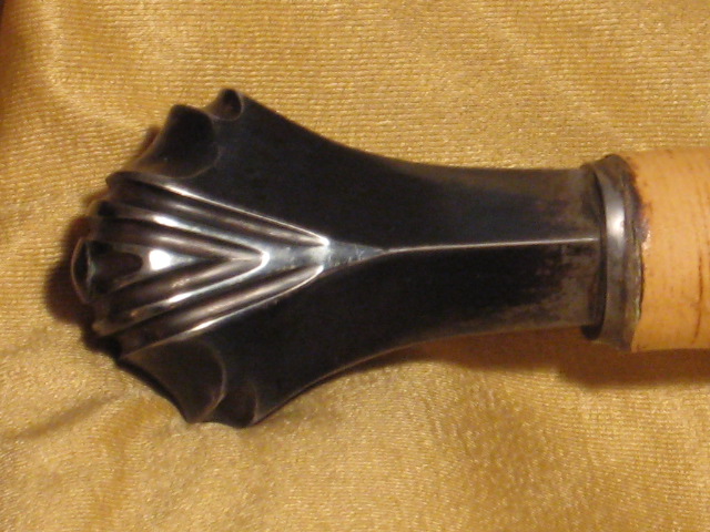

Also blued the guard and pommel and knocked down the mirror finish on the blade to a satin finish similar to an Albion finish.
I like this sword in spite of the remaining issue of the guard being too chunky.
The steel and heat treat is very good and I can't even find the nicks in the blade now after a couple of light sharpening.

Seam on riser.
Attachment: 128.76 KB
Other side of wrap and seam.
