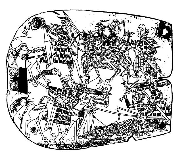

I'm rather late joining this discussion but a few points stood out.
Gary Teuscher wrote:
But if lamellar does not cost much more, why not just make a coat of it?
Because you cannot make one flexible enough to offer protection for the entire body including arms/legs/head
Not quite. Rigid lamellar, made with 7 or 8 holes and no slack in the vertical lacing, is extremely stiff, but introduce even a centimetre or so of slack / hanging vertically and the structure becomes extremely flexible. In fact, I have made my lamellar like this. It fits better and is vastly more flexible. To help stabilise it a little, I wear a tight belt / sash around it at my waist.
And this is without delving into 13-hole true hanging lamellar (such as the Tibetan coats) which are very very flexible, and more "outlandish" lacing styles such as the Terracotta Army lamellar, which included full-length sleeves. Judging by a depiction of this lamellar on Central Asian cavalry, the sleeves were flexible enough to allow an archer to draw a bow fully back (to the ear). Quite flexible - but the lacing is totally exposed. I plan on starting work on a suit of Terracotta Army lamellar at some point.
I will agree that it is impossible to protect the insides of a joint with lamellar though.
Matt J. wrote:
So... would you say lamellar is harder to penetrate than mail?
I have seen thicknesses ranging from 0.5 mm for Roman "locking scale" all the way up to 2 mm for lamellae from Central Asia (IIRC). Obviously there is a lot of variation. No idea what the average is, but I would guess that lamellar (on its own) would be on the thicker end.
I'm assuming we're discussing steel / iron lamellar here, not hardened leather, bronze / brass, bone, horn, hooves, etc ... the material adds even more variability in!
 Attachment: 126.59 KB
