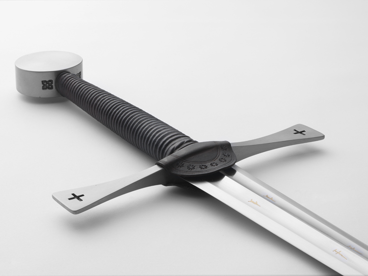

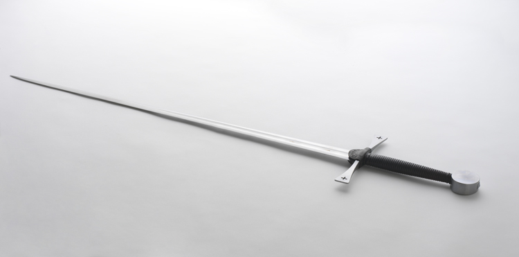

PostPosted: Mon 10 Dec, 2012 12:23 pm    Post subject: Museum Line Ljubljana pictures         Reply with quote
The first Museum Line Ljubljana has visited my photographer - and has travelled on to the museum. Here are a couple of the photos. More photos (high res) can be found on albion europe's flickr page:
http://www.flickr.com/photos/albioneurope/sets/72157632214313808/
 Attachment: 142.09 KB
 Attachment: 66.66 KB

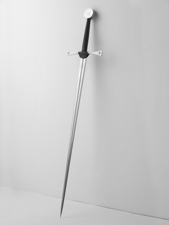

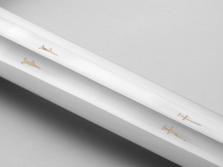

PostPosted: Mon 10 Dec, 2012 12:26 pm    Post subject:         Reply with quote
Just two more - to see some of the amazing details on the leather work and the blade....
 Attachment: 157.95 KB
 Attachment: 135.58 KB

PostPosted: Thu 13 Dec, 2012 6:23 am    Post subject:         Reply with quote
Hi Robin,
The inlay is made by first etching and then gilding.
On close inspection you may detect difference to the look of solid wire inlay: the gilding is not exposed on the surface level of the blade, but put ever so slightly sunken below.
This is a difference to wire inlay that is flush with the surface, but this also protects the gilding.
The benefit with this method is that it is possible to get very close to the precise form of the original markings *every time* and that it can be done on blades manufactured by milling and grinding.
I have made drawings of the markings on the original blade and taken care to reproduce them in detail and exact scale.
I think this method of etching and gilding it is a very good substitute to wire inlay. Having the marks of the original in the blade like this elevates the whole weapon. A touch of color and that deeper meaning that signs and symbols bring.
-It is something w shall explore further in coming projects.
