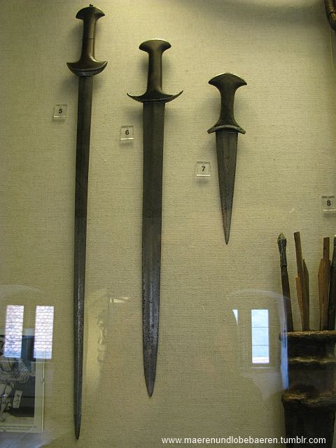

maybe this photo is useful to you? It shows the various length of swiss daggers. I took it a couple of years ago at the Rothenburger Reichsstadtmuseum. I am looking forward to see you project finished!
Regards,
Thomas

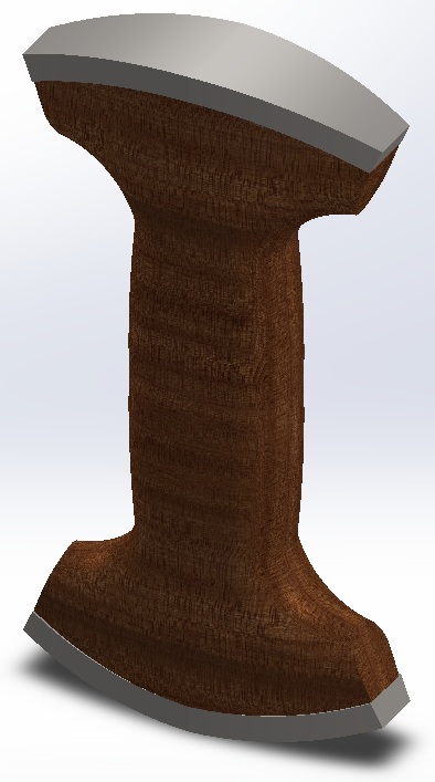

Basic idea for the hilt. grip would be made out of two pieces with the pathway for the tang milled out of the center. The guard and pommel plate would be made out of 1/4in mild steel plate, bent to shape (radius of 8in) with the blade inset and hole for the tang cut out. Water jet CNC or a CNC plasma cutter would probably work best for the guard and pommel, with the grip made on a standard CNC machine. If i can't get into a shop, i could build it with a sander, router, and jig saw.
