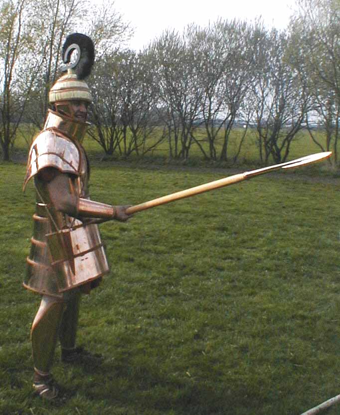

Andrews reconstruction.
 Attachment: 54.42 KB
Here is Dan wearing Andrew's reconstruction a few days after it arrived.
 Attachment: 71.67 KB
Here is Andrew wearing his reconstruction [ Download ]

Great photos. Do you have any comments about the panoply in terms of weight, balance, freedom of movement, etc.?

Yes! Pleas tell me too how mobile you can be in this armour?Because I've heard many dofferent opinions...Is it good for foot combat or maybe for chariot rider?(forgive me my ignorance-I have not much experience in arms before middle ages... Worried )

Dan, owning and wearing an accurate reconstruction of this armour I wonder if you could share your expirience with its mobility. The reason I ask is that in some of the reading i've done its been positied that this suit must have been for ceremony or the like as it couldn't have been very mobil and since you've actually worn it or rather a good recreation of it i'd be curious to hear what you think. I'm not as up on this period as I should be so i'm looking forward to yoru response.

Thanks especially for sharing the large size pictures of you in your reproduction. It's easier to make out some of the subtle details.
I, too, would like to know about your mobility while wearing the panoply. I've heard it might have been more suited for a chariot driver. Your thoughts?

Regarding movement. The entire panoply including helmet, greaves and gorget weighs just over 25 kg. Even though it seems to fit me quite well, a lot of the weight is still carried on the shoulders. It is possible to run, lay down, jump up, etc. I even played cricket in it after Andrew said that he did it. It is hard to lift up one's arms above the head and it is fairly hard to throw a javelin but one can fire a bow while wearing it. It is definitely not too encumbering to wear if fighting on foot. However the gorget simply sits over the shoulders with no means of fastening it in place. It jumps around a lot if one is attempting to fight on foot. Personally I think that the armour was worn by a charioteer and I'm currently exploring the possibility that it was actually worn by the driver (the guy holding the reins) and not the passenger (the guy with the weapons).
Since I assume you did some very careful research on it before having it made, the reason there is no means of fastening the gorget is that there was no evidence of any form of attachments or even holes that would permit attachment.
I'm just wondering if some form of attachment could have existed that would leave no trace on the gorget ? A lining with attachments glued on or physically attached in a way that didn't need any holes.
Maybe a bulky leather or padded fabric collar on some sort of arming coat that the gorget would fit tightly on so as to not move around.
