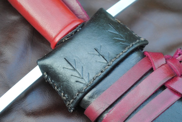

Greetings,
thanks to the wonderful information and the traced-through originals in this thread i finally did my first attempt in leatherworking.
The sword is recognizably an Albion Talhoffer, and the design is very roughly based on Talhoffer's drawings:
As you can see the cross leathers are quite short in the drawings, and i freely interpreted the hatching on the right piece as decorative lines.
Here it's still drying and unfinished. The leather is veg tanned swedish cowhide, approximately 2,5 mm thick.
I soaked and hardened it with water & baking soda for about 20 minutes, then tooled and sewed it.
Unfortunately due to the bending as i sewed it the tooling kept disappearing again and again, the imprint was very unwilling to last.
As it is my first attempt i don't know if i didn't punch it hard enough, or soaked it too much...or if the leather itself is the reason.
However, the repeated tooling and somewhat coarse stitching lead to this rugged and almost used look which is not unpleasant to me since i bought this sword to be a user for test cutting and verifying fencing techniques. So the used look is quite fitting.
And while drying, the too bright leather darkened and adapted itself almost perfectly to the Talhoffer's grip
and developed a wonderful irregular colouring.
The last thing i had to make was stuffing the thread endings inside it, since it is sewn from the backside,
and then finally went over the sewing and some rough spots with a bit of black shoe polish.
Now here's how it looks now, i feel like it ads a whole lot of character to the otherwise plain sword:
An utilitarian sword of a minor fencing student, thats what it is and thats what it happened to look now so fittingly. I'm very pleased.
Have a nice weekend,
Max

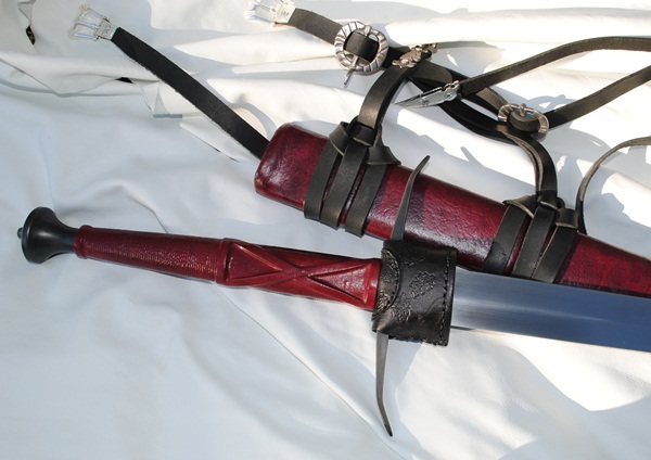

PostPosted: Tue 05 Jan, 2010 9:08 am    Post subject:         Reply with quote
A couple of my more recent attempts at making the tubular type:
 Attachment: 167.57 KB
 Attachment: 214 KB

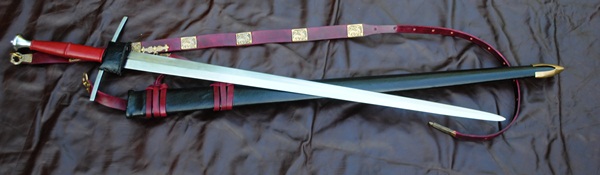

Mark T

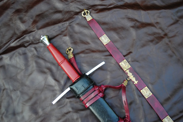

PostPosted: Wed 24 Nov, 2010 1:44 am    Post subject: 'Rain guard' / chappe by Russ Ellis         Reply with quote
I'll post full pics of this in the 'Show us your scabbards' thread soon, but I just wanted to show some photos of a 'rain guard' / chappe that Russ Ellis of Tritonworks made for me recently.
This was Russ's first chappe, and I was happy for this ATrim 1520 XVIIIb to be the guinea pig. Russ did a great job of tracking down historical sources and playing with a couple of prototypes ... I'm not sure if he's about to advertise widely that he can make them, but the process can't have been too bad: I'm just about to commission him to make another one. (When it's done, I'll post pics of that here too.)
You'll notice that he sized the chappe to fit perfectly over the scabbard mouth, and built in a riser in the scabbard that the chappe sits flush against. The black chappe on oxblood grip was my request: I wanted the chappe to 'disappear' slightly into the scabbard when sheathed, and for there to be a nice distinction when unsheathed.
 Attachment: 92.25 KB
 Attachment: 82.44 KB
 Attachment: 44.25 KB

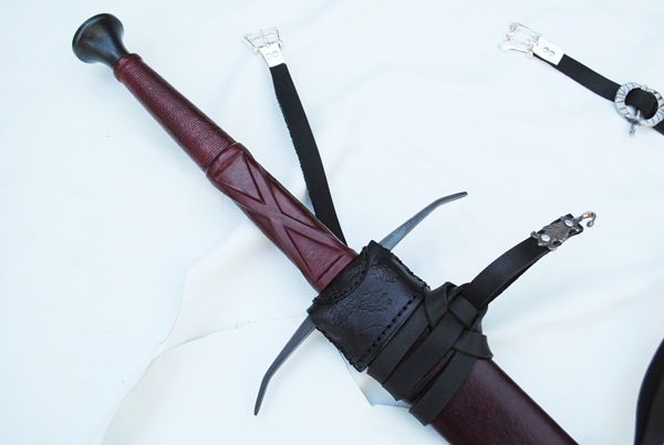

Here's another to add to what seems to have become our 'chappe imagebank' - this is the second that I had Russ Ellis make, on another ATrim, also as a 'guinea pig' piece, to allow him to refine his technique. I think you'll be able to notice some differences between this and his first, above.
(I also have two coming from Brian at DBK soon, so will post those when they're complete ... can't wait to see more scabbard makers offering chappes! These days, 15th C swords without them just seem ... naked.)
 Attachment: 52.13 KB
 Attachment: 80.5 KB
 Attachment: 143.51 KB

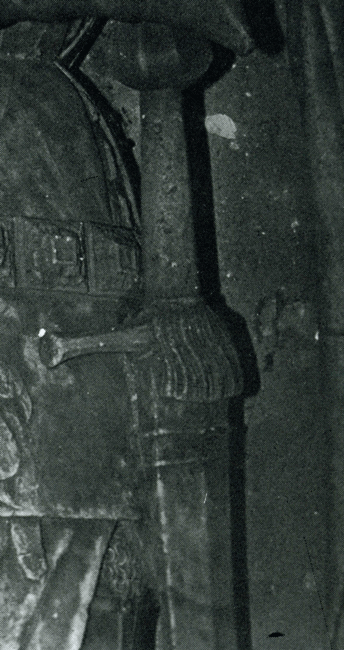

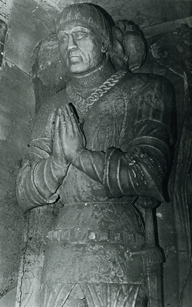

Our first chappe effigy image! This from Turnbull's The book of the medieval knight (London: Arms and Armour Press, 1995):
Monumental effigy of Lionel, Lord Welles, a Lancastrian knight who was killed at the Battle of Towton in 1461. His body was conveyed in secret to this tomb in Methley, West Yorkshire. The sculpture is very striking, showing clearly the fashionable hairstyle of the period, and is very detailed in its representation of a contemporary style of armour.
This chappe appears to be of the 'flap' rather than 'tubular' construction.
 Attachment: 249.19 KB
 Attachment: 229.02 KB

PostPosted: Sat 24 Dec, 2011 4:54 pm    Post subject:         Reply with quote
i'd say that effigy shows a tassle rather than a flap.

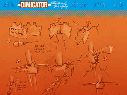

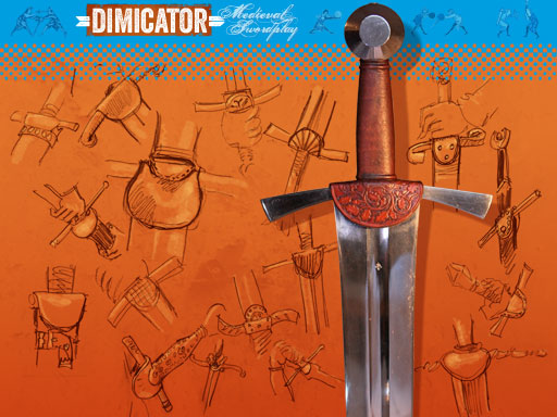

I have reconstructed two crossguard chapes and mounted them on two of my swords.
In addition, I have published a brief tutorial on how to make your own.
Find the pictures below in a higher resolution here and here.
