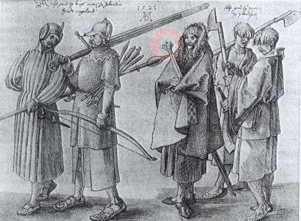

I have often wondered about one sword in particular in Durer's portrait of Irish mercenaries. I enclose the picture with the relevant weapon highlighted-- does anyone have any thoughts?
It seems to me that the guard may have quatrefoil terminals, (in common with many Scottish and Irish swords) but that is not clear on the pic I have. Also, there may be some slope to on the cross, but it appears to be quite straight to my eyes.
The pommel (which I have drawn particular attention to on the jpeg) is what caught my attention first. It isn't of a type that I am familiar with and doesn't seem to be very "Irish" in style.
So:
1) Does anyone know how such a pommel might be classified-- is it a variant of a 'V' pommel?
2) Is it likely an Irish sword (as per the cross) or a sword purchased/looted on the European mainland?
In asking this question I am assuming that Durer portrayed the arms carried accurately-- he did with the other weapons and clothing (as far as we know), so I have assumed this sword wasn't a whimsey thrown in.
Thanks in advance,
David

I'm not entirely sure what you mean by the pommel not looking "Irish". The pommel is a ring with the tang bisecting it- about as Irish as a sword can possibly get. Museum replicas makes a "Gallowglass" sword with a ring pommel. Assuming that model is designed after that sword in Durer's portrait, the quillons actually end in tips that are shaped like a thistle.
You can also take a look at the Irish sword that Arms and Armor makes to get a better view of a ring pommel.

Thanks for the reply. I am familiar with the standard Irish sword (commmonly referred to as a "ring-hilt"). Durer, De Heere, and others show this type as being almost universal amongst the Irish of the time.
The pommel I have highlighted is actually not an Irish "ring-hilt"-- the gallowglass on the left is holding the standard Irish weapon, but the kern(?) standing immediately to his right is holding the sword I was referring to (it is possible that the reddish colour I used is a bit too pale, but it has a coloured ring around the pommel).
It was that sword that peaked my curiosity.
David

I'm really sorry about that, I missed the fact that you highlighted it- I guess my focus went immediately to the biggest sword in the picture.
Yeah, the pommel you highlighted kinda looks vaguely like a type V, or "Fishtail" and I've never seen anything like that on an Irish sword.
Now I'm rather curious to hear what some more experienced folks have to say about it.
Again, I apologize for my previous post.

The only other idea I have come up with is a variant of the Type T pommels-- but am not sure. When I look at it I have the feeling that I have seen it somewhere, but it might just be a memory of having seen the picture a long time ago. It's quite an attractive sword, I think-- and the pommel, together with the Gaelic looking cross, suggests an interesting hybrid possibly.
David

Having looked at it again, a few more observations (and questions) come to mind.
I described it in the subject heading as a "Gallowglass sword", and then suggested that it was a kerne that was holding the sword in question. Having looked again, I suspect the two on the left are gallowglass, the two on the right are kerne, and the centre figure is an officer/chieftain. It's a guess, but his sword (again) is unique and looks to be of a different type than those often shown... but more on that in a moment.
Unlike the two kernes, his cloak seems to be of finer make (note the inside lining-- also the trim, which may be "shag" or possibly even fur). He also has footwear. While it is hard to make anything else out, it seems he could be a higher status warrior.
Now... the Irish sword on the left is a big two-hander-- if it fits within the typology Oakeshott has given us, would it be a Type XX? The sword mentioned earlier could be Type XXa (using the redefinition of that type given in "Records..."), but it is difficult to know for sure given the angle at which it is held. Any ideas?
Lastly, the gallowglass helms. I'm not very "up" on later medieval helms, but it looks like one may be a type of bascinet? Would it be a pig (or dog) faced bascinet? The other helm is like nothing am familiar with-- does nayone recognise it?
Sorry for pouring on the questions-- I just figured that if I could get an answer anywhere it would be here.
Thanks,
David

The central gallowglass' helmet is a variant of a burgonet, I think. The neckguard is in lames, as far as I can tell, and is not as big as in some typical burgonets. On the other hand, the visor can be separate, but in this case is much bigger than usual. If you look at the Albion Mercenary's Tailor Casquetel, it vaguely resembles Durer's piece. Oakeshott's European Weapons and Armour shows somewhat similar burgonets.
I am working on the other helmet - but it is rather odd.

It occurs to me that the second, "other" helmet may be only part of a helmet - i.e. missing a visor. The hook at the middle of the forehead looks pretty useless, except as a way for the helmet to get caught in something (for example, an enemy polearm). However, if there was a missing bit, the hook may have been part of a clasp or hinge. We know that may fighters preferred the better ventilation and peripheral vision that came with wearing a helmet with the visor up. This is reflected in the stories of men killed by being struck in the face, which are more common than men being killed through their breastplates and the like. Perhaps the visor was permanently removed.
The "rosette" things on the side of this helmet are also a bit strange. The nearest thing I can find to them, in a cursory search, are the elaborate hinges that some visors had (see attached). I know the picture is of parade / tournament armor, but the principle might be the same. (?)

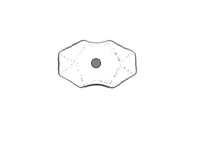

Edit: I had posted a digitally altered pic to try and visualise what I thought the pommel might look like, but after looking again, I realised it didn't work... This sketch done in paint might do more justice, but I suspect it would look better if I had paid more attention in geometry when I was in school Happy
I'd be interested to know if it looks like a reasonable representation of the shape. (The reason why I'm bothering, by the way, is that I really like this sword-- some day in the far future I may even think about getting a custom job done if I can figure it out).
David

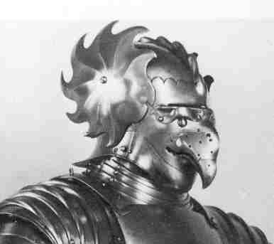

PostPosted: Sat 12 Jun, 2004 6:38 pm    Post subject: More ear muffs         Reply with quote
Detail of Pieter Bruegel the Elder's The Adoration of the Kings from Web Gallery of Art:
 Attachment: 14.99 KB
