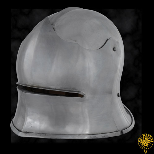

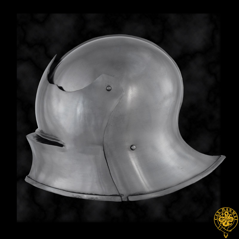

I was looking into purchasing a german sallet helm from GDFB and wanting to see whats peoples thought of it were.
Iv read that they are mass produced and that a few pieces sometimes come out wrong
Eek! But I thought i can always tweek it myself if it were to come to that.
Has anyone had any issues with this helm? Was the quality pretty good for the price?
Also some other photos would be greatly appreciated

I can't speak for this exact helm , but I did recently purchase the hounskull bascinet (AB0424). My experience is that you must purchase the largest size of the helm they offer in order to insert proper padding (unless you have a really tiny head). You will have to tweak the helm to get the components to play well together. You will have to sew in a proper liner. You will have to make minor modifications to make it work.
What do you expect for a few hundred bucks?
If you're handy with a hammer, it's a good bargain. If you want something to fit perfectly out of the box, look elsewhere.

I've just bought the helmet shown above. $159 shipped from KOA. I consider this a project piece, and it appears to be a good start. I like that it isn't drilled for lining rivets. I'll do that myself and install a proper liner after ripping, prying, burning or otherwise removing the strange full-leather GDFB lining. Needs new straps, too. Maybe slight reshaping of the top lip of the sight. New pivots. New polish.
FWIW: I've been looking for a German sallet project, and the choice was between this, the GDFB "Jaw Bone" variants and the Windlass sallet. Yes, this has more of an Italian export look about it, but the type is all over Austrian artwork of the period. I like that it's 14 ga. I think the Windlass is probably too light at 18 ga. I also don't like the very large sight and flimsy-looking visor "arms" of the Windlass. The GDFB "jaw bone" variants look good (see the Churburg sallets,) but the full, cusped visor appears to be the most common type in the artwork I'm looking at.

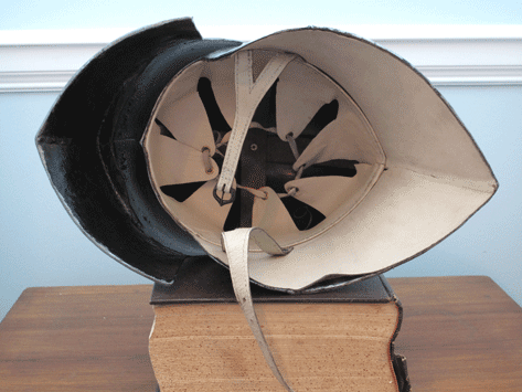

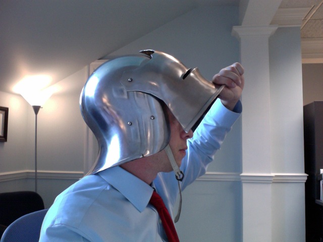

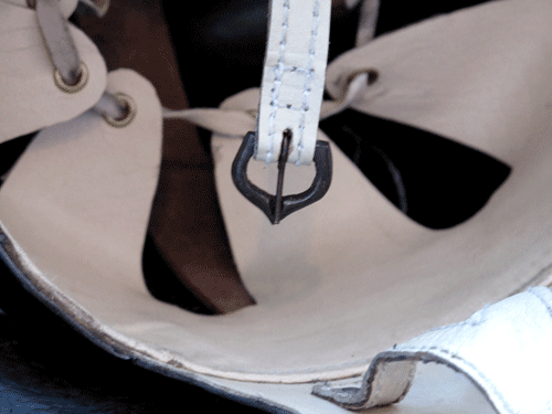

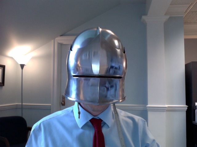

I just got mine. Here's a mini-review to help out folks eager to try this product. Bear in mind that I view this as an unfinished "kit" project.
The Good: I'd say it's good overall, and may be the best $159 (shipped, from KOA) I've spent on arms and armour. Big Grin As remarked above, the side profile is nice. The visor profile--which is a part where most manufacturers fail badly--looks good to me. Surprisingly, the front view is more complex than I expected from product photos. Perhaps they've responded to complaints. It's slightly more hourglass shaped. The lines overall are excellent, I think.The sight is neatly done and isn't too large, which is one of the reasons I chose this piece over the Windlass sallet and GDFB "jawbone" sallet. The size is as advertised for a "medium" (~24.5",) which still swallows my wee noggin (~22). BUT although the thin, strange liner makes my head feel like a pea in a can, a properly made and attached liner should be almost perfect. The weight is 8.5 lbs, lighter than advertised (a good thing) but still 14 ga. throughout (another attraction over the 18 ga. Windlass). Another selling point--No lining rivets. That's bad for folks who want something historical-looking off-the-shelf, but great for those of us who don't want the manufacturer standing between us and doing it right. Some other GDFB sallets have riveted liners, and those are non-starters because the rivets are out of place.
The Bad: The liner...oh, my, what a problem! I'm going to be generous and assume that this is a cost-saver. Marking and drilling the bowl for lining rivets, driling, riveting, etc. takes time and eats drill bits. But how do you include a liner without rivets? Glue. How do you provide enough leather surface area to support a glued liner? Extend the liner all the way to the bottom of the bowl. The good news is that this liner lets go with some tugging. I'll be making an entirely new liner and placing the rivets properly. I don't know if I'll go for handmade octagonal rivets this time, though. Big Grin Been there, done that. The straps are junk but he brass buckle is of historical form and should be salvaged to use on the scabbard belt of your 15th c. German longsword project (if you have one--I do!Happy )
The raised-visor image below indicates the max height. The hand holding the visor indicates that it will not stay up on its own. 14 ga. ain't lightweight, and the visor cant get high enough to be past the tipping point. Visor doesn't stay fully closed, either, which is pretty simple to fix, especially if you want to add a late 15th c.-style spring pin.The visor pivots look more like temporary assembly rivets--they're lining rivets, actually, and much too small. Again, better too small than too large. I'll experiment to get a tight fit and improve articulation of the visor. One other visor issue, which I'm not sure is a-historical: The visor covers one of the strap rivets. I'm not sure I've seen that on any historical sallets. If I can't find an historical example of that I might want to make that edge of the visor deeper to expose that rivet. The top edge of the visor could be a bit deeper, too, so I'll look into that as well.
The polish is even but not as high as it would have been historically. On a scale of 1-10 in terms of historical finish, with 10 being an historical mirror polish, I'd say this finish is an 8. Not bad, by any means, and excellent for most purposes. The edges of the visor are cut square and bit rough in places, so I'll be smoothing those and beveling them. The "arms" of the visor are of historical shape, but slightly crude. I'll reshape those a bit.
Verdict: Excellent display piece. Wearable off-the-shelf if your head fits the thin liner, but probably not very comfortable, and not able to pass the 6' visual test due to the lack of lining rivets. Potential to be much more accurate, much more wearable and worth much more than the $146 KOA is charging.
The photos tell the rest. Hopefully, this is enough info to help you decide.

Sean, thank you so much for the review and pictures! After looking at you're photos and reading you're review I placed my order with KOA Happy

I have the Jaw Bone: Odd non historical name here I think but justified by the visor being rather deep while some sallets visors are narrower.
Funny but I don't find the liner so bad as to comfort or usability, at least for casual costume wear.
One thing though is that the buckle and strap seem badly angled and there aren't enough holes in it to tighten it properly below the chin. The trap also become too wide to fit thought the buckle if one added holes in the right place at least for me.
All of the GDFB straps are split into two branches before becoming one strap that goes through the buckle, as a quick fix to make it more functional I would just cut off the strap below the " V " parts of the " Y " cutting off the end and use a leather lace as a tie.

The visor on my " Jaw Bone " version is that the visor can be pushed up higher and does seem to stay up unless I jump up and down hard ! It would benefit from having a spring pin to keep it down although gravity seems to be enough. Wink Laughing Out Loud More to keep it from being pushed up too easily by and opponent in battle I would guess.

Yeah, the "Y" strap is the right type for this sallet but it's hard to get it right. If it's even a little bit off angle, there will be more tension on one arm of the "Y," which defeats the purpose. This sallet's straps do seem to be a bit off. The little things that seem so simple sometimes prove to be some of the most challenging.

Oh, and yes the " Y " straps are badly positioned or just not angled optimally to go under the chin.
