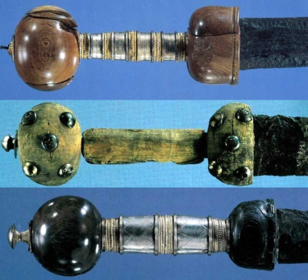

 Attachment: 225.5 KB
three 3rd century spathae from Illerup

The swords with hilts on them are very nice, I didn't know them until now.
I don't really understand this one:
http://www.rmo.nl/collectie/zoeken?object=VF+536
Is there a closeup of the hilt? Anyway, it would have had the roman style semiglobular lower guard and globular pommel configuration.
The other one is a normal roman style lobed grip. There would have been disk shaped guards below and above it.

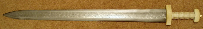

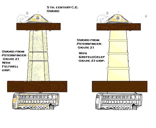

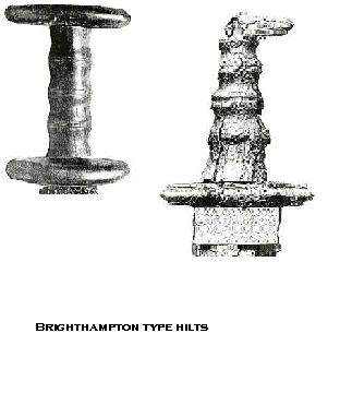

what about the feltwell sword, a little known one found with most of its hilt under a roman floor in suffolk (my home)
 Attachment: 15.96 KB
 Attachment: 9.87 KB
not sure if this is the same
 Attachment: 34.79 KB
 Attachment: 28.31 KB
replica(ish)
I do not think that these swords would be suitable for the period stated in the OP (100bc - 200ad), though they are very interesting if you have any more information I would appreciate it greatly if you could share.

That Feltwood sword replica looks impressive especially its blade. Why does the hilt look like unfinished?
