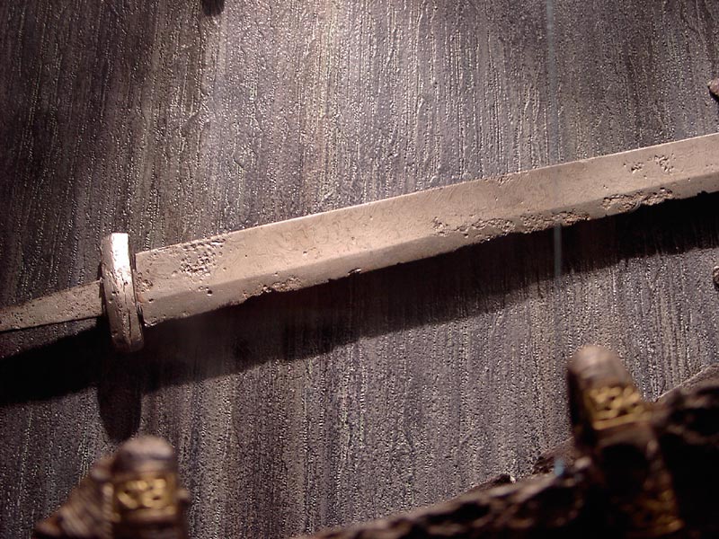

North Arhus Farm find preserved in the Kulturhistorisk (Cultural History) Museum, Oslo Norway. Image compiled from "Swords of the Viking Age" by Ian Pierce

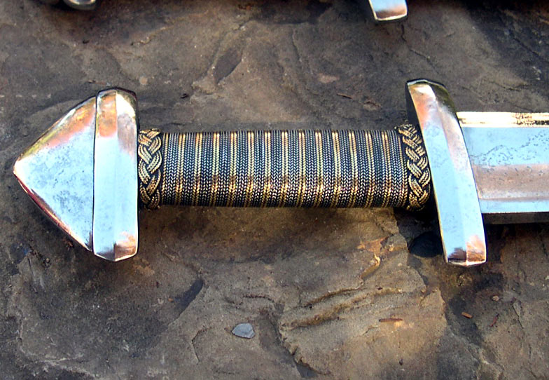

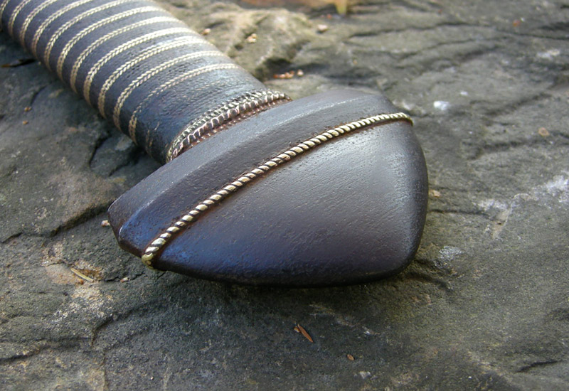

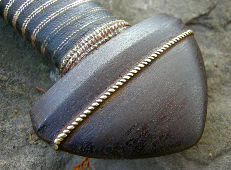

Since the review, I have been doing some changes. I reshaped the upper and lower guard and pommel… mainly making the width of the pommel smaller. I also cut in twisted copper wire between the pommel and upper guard. Then I browned the hilt components with cold browning solution and polished with steel wool.
The Turkish Knot ferrules were replaced with copper and bronze wire shaped with my Dremel tool to look like an engraved metal plate ferrule. The twisted wire grip was also sanded down and blued to make it appear it had been well worn over the years. This is the look I try to achieve… the look of an heirloom weapon that has been through at least one lifetime of burnishing in use and periodic care. For instance on the hilt I have identified pressure points when the sword is griped or as the hand would naturally lay upon the hilt as it hangs at its owners side. In these areas, I have done a little extra grinding and polishing.

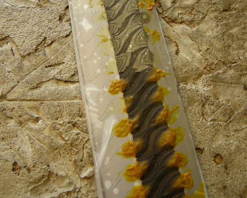

I kept the blade profile shape much the same. However, I did file down the spine a bit from the COP to the tip to give a slight drop to the point seen on many of the single edged Viking originals such as the Arhus Farm find. Most of the reshaping of the blade occurred in the fuller. I did a good bit of grinding in the top of the fuller to take it right up to the spine.
Once the fullers were shaped, I began to experiment with ways of duplicating the surface phenomena (topography and the slight discolorations) of pattern welding.
When I started the process, I was not trying to replicate the patterns of the Arhus Farm pattern welding. I wanted to do a chevron like pattern instead. My first attempts were with small pools of warm vinegar trying to generate the pattern in the deep etched lines along the outer edge of the vinegar. However it was too fluid for very good control. It created and interesting patterns, but not anything like the look of true pattern welding. Also I didn’t like the look of a chevron pattern on a single edged blade. So I sanded it all off. Sad
On my next attempt I used mustard. It etched like vinegar but was thick and sticky enough to draw or blot patterns with it. I started with the innermost circle of the concentric circles, layering each drop of mustard, allowing each drop to cut along the edges before the next drop of mustard was placed over it to cut the next concentric circle. If the mustard was warm, it cut even better, especially along the edges. So I put warm mustard on the blade in concentric rings to try and duplicate a pattern similar to torsion pattern welding. This time the pattern was not chevron (imitating billets twisted in opposite directions). This time I moved a little closer to the Arhus Farm find in that the twist patterns on both “billets” were in the same direction. The look of the etch was a little more convincing, but was still not satisfactory to me. Plus warm mustard made the house smell really strange. Razz So… I sanded it all down. Cry

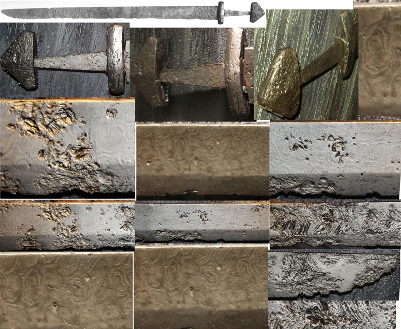

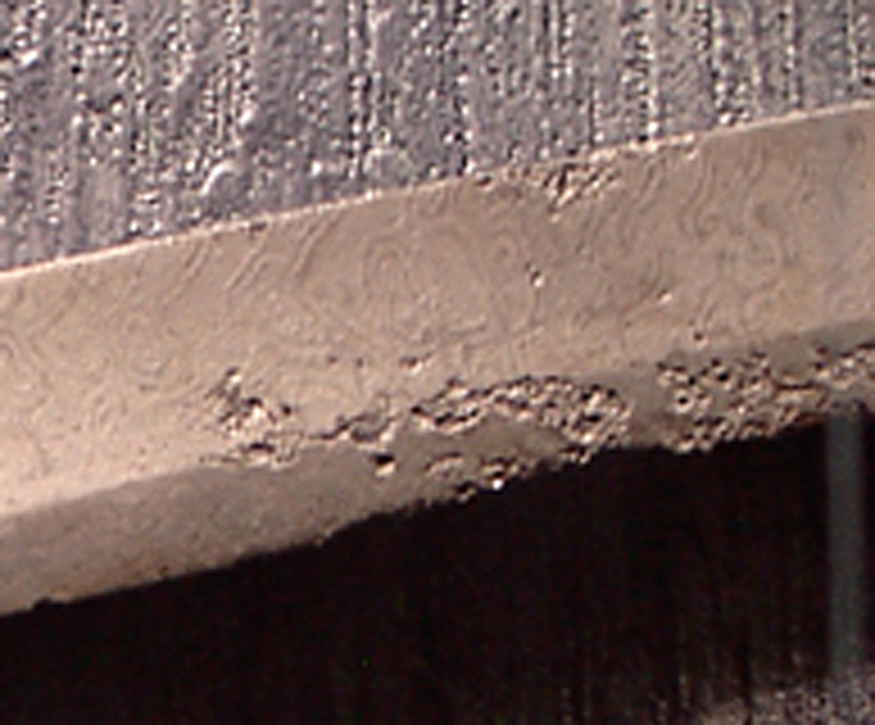

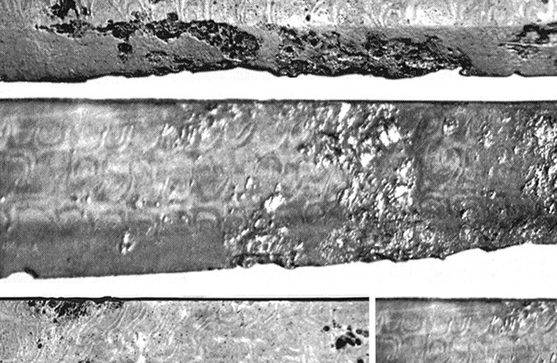

I was happy with the technique, but the pattern was just too darn even. It just didn’t have the organic look of the Arhus Farm find. It was about this time that I found another picture of the Arhus Farm find. I was able to enlarge the image to begin to get a better idea of what (I thought) was the other side of the blade from that shown in “Swords of the Viking Age,” by Ian Pierce. Since then I am convinced that one of the pictures of the pattern welding in Pierce’s book has been reversed. But at the time, I thought I had images of portions of both sides. It was either this discovery or my growing dissatisfaction (or both together), that led me to take up the coarse sandpaper and, once again, sand away all my work. Eek! Both fullers were sanded smooth. Cry
With the better images of the details of the Arhus Farm find’s pattern welding, I decided to try and duplicate the actual pattern of the original (or at least the parts exposed).
Since this time even better images have been made available on this excellent website:
http://www.vikverir.no/ressurser.html
I have posted some compiled images of closer views of the patterns in the Arhus Farm find.
I started near the forte and, as I looked closely at the images and try to draw the patterns, I began to notice how irregular the width of the billets and what I interpreted as the twist pattern reversing every few inches, especially in the billet closest to the edge. As I began to draw these patterns it looked a little too organic. It does not show up that clearly in pictures of the corroded blade at a distance but on a clean blade these features looked a little too obvious to my eye. So I sat the sword aside for awhile until I was more certain about the pattern. I wanted "organic," but not too organic. Not too even.
Maybe something with a theme. Eek! Big Grin Wink
ks
 Attachment: 147.39 KB
Detail of Arhus Farm find. Image modified from VIKVERIR website linked above
 Attachment: 138.72 KB
Mosaic of images of Arhus Farm find. Image modified from VIKVERIR website linked above

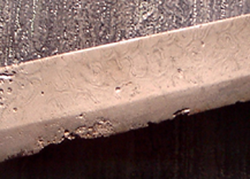

The “theme” came to me when I noticed that the billet nearest the edge at the tip of the Arhus Farm find looks like teeth… It is fascinating that grinding into the twisted billet to form distal taper (or thinning of the blade) produces a surface pattern that looks like teeth in an open mouth. I mean, it is the part of the sword that “bites.” Wink
And the strait untwisted layers at the very tip-end could be a tongue or fire coming out of the mouth. To top it all off, up the blade on the Arhus Farm find, there is a section where two of the large “blood eddy” like circles come together on either side of the two billets and looks like a big eye. Eek!

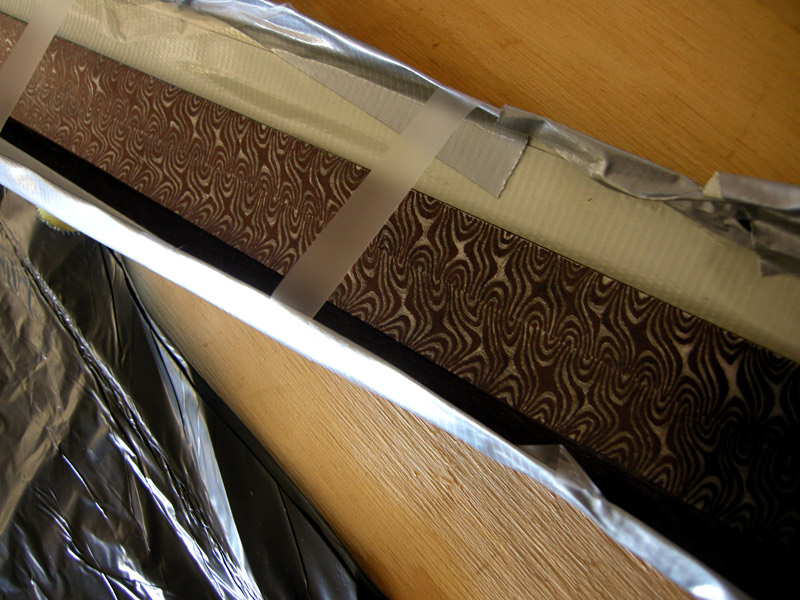

PostPosted: Tue 14 Dec, 2010 8:00 am    Post subject:         Reply with quote

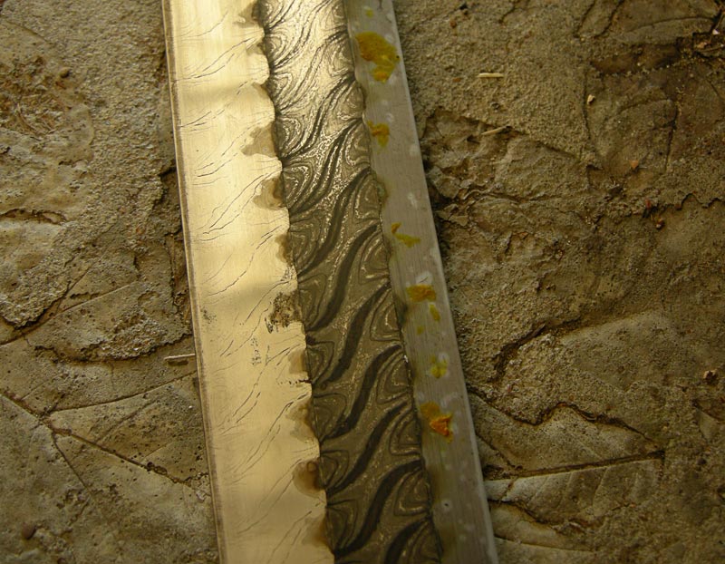

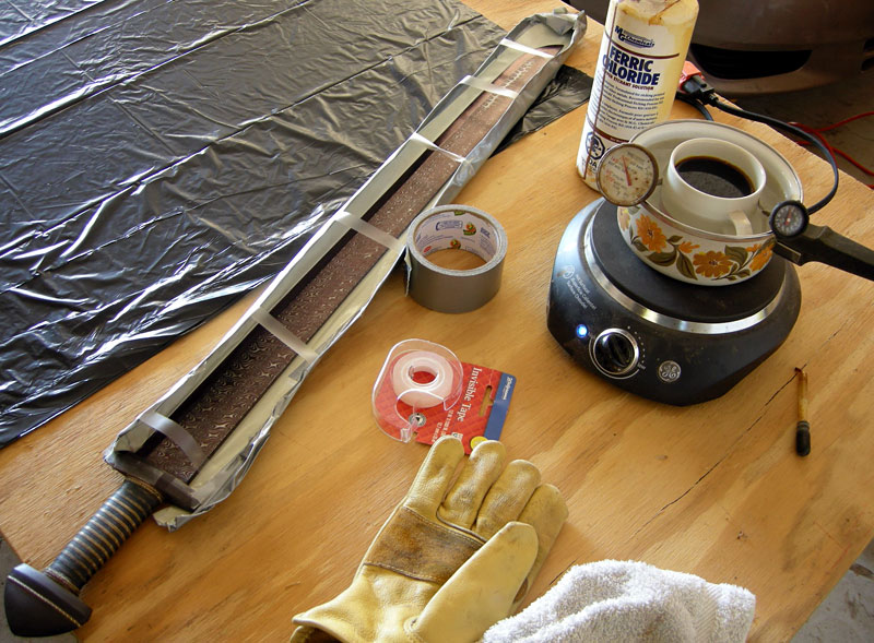

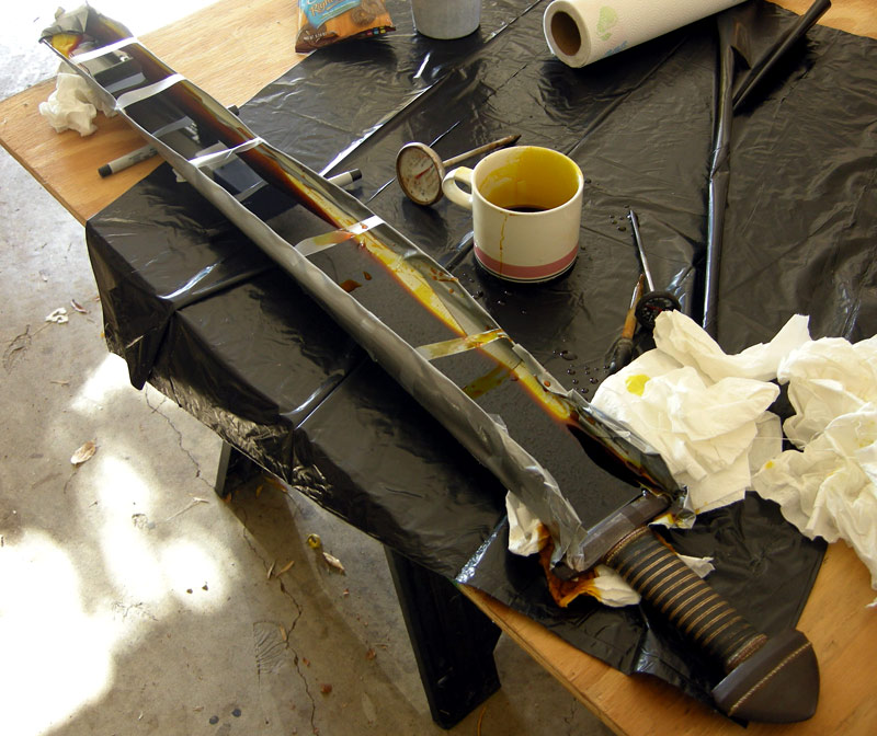

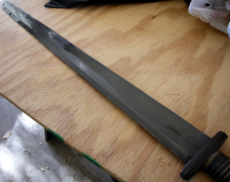

So once again, I began inking the fullers with surface patterns similar to the Arhus Farm find... This time with the theme of producing a “Fire Worm.” I felt this was appropriate considering that hidden zoomorphic forms are a long standing tradition in the European Iron Age art design. This time I wanted an organic look but not too organic. I wanted patterns similar to the Arhus Farm find but a little more regular, but not too regular.
In the first few attempts at etching, I tried to etch each “billet” separately using scotch tape to isolate each “billet” form. The problem was that the edge of the scotch tape was too straight. It also produced a deep etched line along the boundary. It did appear to be a weld line, but when the billet on the other side of the fuller was etched this line got larger and deeper. In the latter attempts to try and deepen the topography of the etch, I produced the patterns over the whole fuller and etched it all at once. With this the line between the billet was not as pronounced. Also etching the whole fuller at one time seemed to produce a deeper etch, maybe because of the large amount of etchant used to fill the duct tape reservoir I created around the blade.
I made a reservoir out of duct tape around the blade and filled it with warm ferric chloride. After about 15 minutes I took the blade out and washed it with Windex. Then I sanded the high parts of the etching very lightly with dulled extra fine emery cloth.
ks
 Attachment: 146.44 KB
Close-up of tip with "teeth" in the duct tape reservoir.
 Attachment: 139.85 KB
Blade center in duct tape reservoir.
 Attachment: 144.18 KB
Duct tape reservoir and set up for warming the ferric choride.
 Attachment: 134.23 KB
Reservoir filled with ferric chloride. Allowed to set for 15 minutes.
 Attachment: 124.49 KB
Blade after taken out of ferric chloride and sprayed with windex... before cleaning.

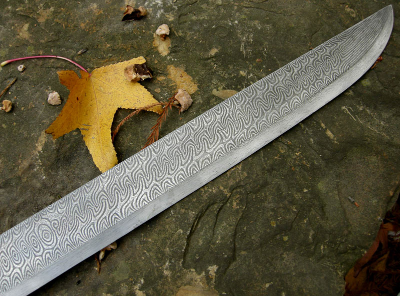

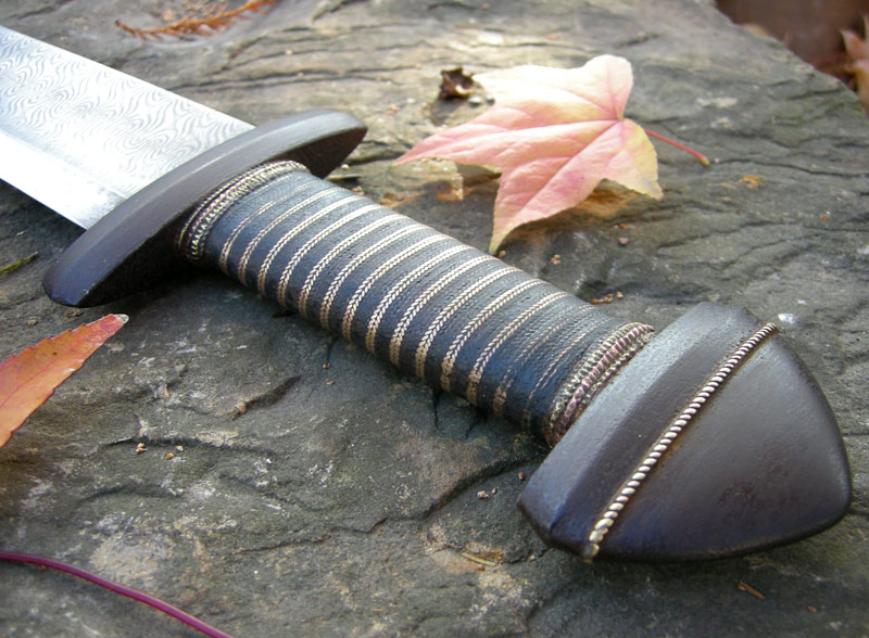

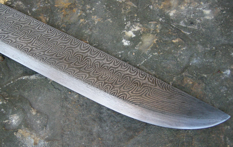

PostPosted: Tue 14 Dec, 2010 8:09 am    Post subject:         Reply with quote

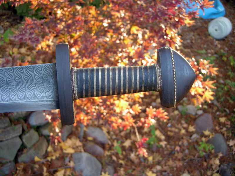

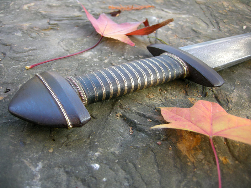

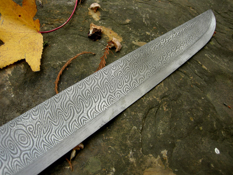

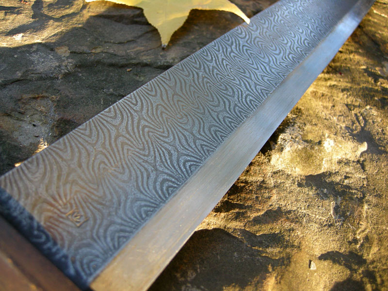

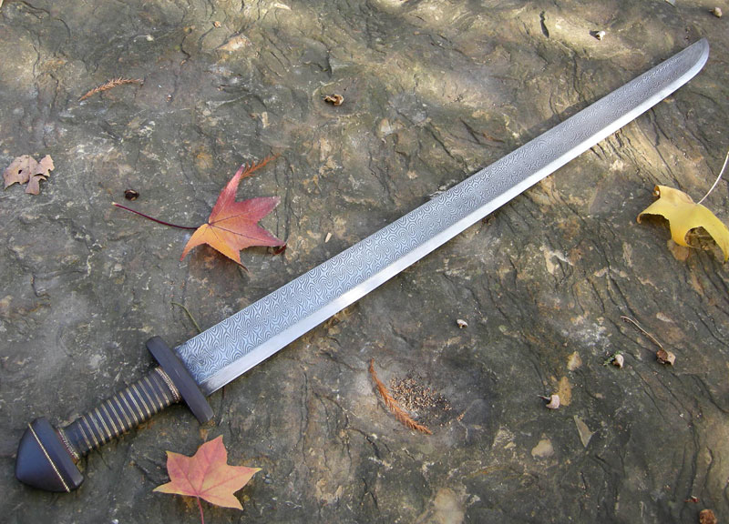

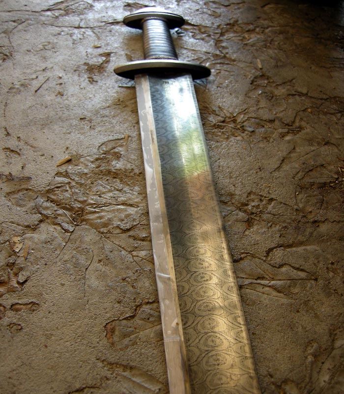

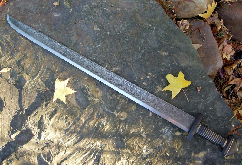

Here are some pictures of the finished project...
ks
 Attachment: 143.16 KB
 Attachment: 138.43 KB
 Attachment: 145.99 KB
 Attachment: 147.63 KB
 Attachment: 122.16 KB
 Attachment: 117.98 KB
Two swords
Lit in Eden’s flame
One of iron and one of ink
To place within a bloody hand
One of God or one of man
Our souls to one of
Two eternities
Kirk Lee Spencer
Location: Texas
Joined: 24 Oct 2003
Spotlight topics: 6
Posts: 820

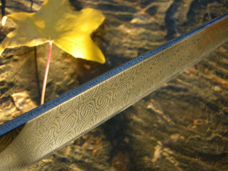

PostPosted: Tue 14 Dec, 2010 8:14 am    Post subject:         Reply with quote

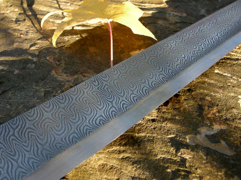

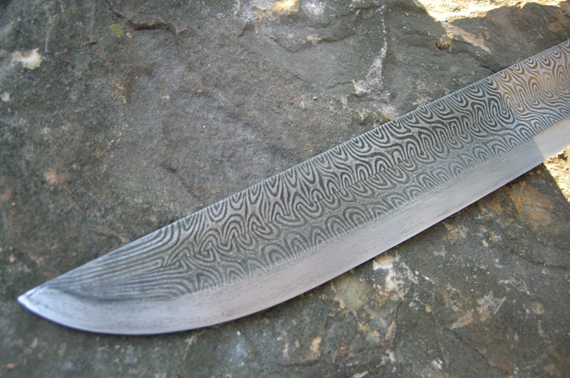

Throughout the inking with resist and etching process I learned a few things… such as:
1. One layer of Sharpie ink is not enough. The etchant eats through the ink too quickly. So apply two or three layers of Sharpie ink. This means drawing the pattern and then going over it again.
2. Use a toothpick to clean up the edges of the pattern, especially in areas of very fine lines. Move the tooth pick in your fingers to find where the wood grain will cut away the ink best.
3. Etchant cuts better when warm 110 to 140 degrees.
4. Less than five minutes in the etchant does not cut very deep more than 15 minutes and the sharpie ink begins to wear away.
5. Make sure the blade is polished very smoothly before you begin drawing the pattern, because any scratch will grow deeper and more obvious with the etching.
6. When drawing patterns, don’t make everything too even. One of the nice things about this technique is that you can make any pattern you want. You could even recreate very specific original pattern welded patterns if you had pictures of them.
7. Make the “weld” line between billets a little wavy and not perfectly straight.
8. Don’t make the edge of the pattern welding follow the fuller edge perfectly but let it wander in and out of the fuller a little in places.
Now a few more pictures of the finished blade.
take care,
ks

Impressive and very attractive work and the results look very very real: Which I guess is the point or it wouldn't be worth doing.
I tend to like using lemon juice but I also like mustard as it's more controllable and doesn't flow randomly as much.
Your project are always fascinating to follow. Big Grin Cool

Carl W. wrote:
Kirk - Thank you for sharing! Your how-to's always get bookmarked. Thanks for spine pic. Questions...
The Vladimir Cervenka blade was not pattern welded? Didn't find it stated in review & I can't get review enlargements to work. Just trying to clarify - you created the entire pw effect on a monosteel blade?
You said scotch tape per billet method didn't work too good, but then what did you use instead to achieve the (fainter) weld lines? (fwiw I also vote for wavy imperfect lines.)
When you're done with this (or your "pw gladius") do you ever cut with? How does/would your deep etching hold up to cutting & cleaning up?
Gutsy making big changes to such a nice sword. Well done! Thanks again.
Hi Carl...
Thanks for the kind words.
And great questions!
The major goal of the project was to find a way to produce a pattern-weld surface effect on a mono-steel blade.
Vlad's blade was not pattern welded. He can do pattern welding, but I'm not sure if he has worked up to sword size blades yet. Vlad did age the blade with an acid treatment that gave some character to the surface of the steel.
When I used the scotch tape, it put down a very straight weld line that remained through the whole project. In the second etch, I did not use the scotch tape but inked over the design on the whole fuller at once. On the edge "billet" I just covered the whole edge with ink. You can see all of this on the images I posted before the etch.
Here is the link to a Gladius I did during this whole process.
http://www.myArmoury.com/talk/viewtopic.php?t...ht=gladius
It gives more info and shows how I etched one side at a time with the scotch tape.
On the next blade I will not use scotch tape at all. I will probably just use the ultra-fine Sharpie and draw the "weld" line very faintly down the blade making it a little wavy and then draw the patterns to this line. Once I have finished inking the blade, just before the etch, I will take the toothpick and clear any places where the line showed where the un-inked "eddies" matched across the "weld" line. This is to be sure that it did not show as a raised area (rather than a etched line) after the etch. (not sure if that is clear) I just don't want the weld line to show as clearly as it does in the current project.
I have not cut with the Gladius as it it some kind of zinc alloy and it is not sharp because I use it as part of my teaching collection.
Now, the Cervenka Viking sword is very very sharp... dangerously sharp. There is just something about the brutal nature of this sword's design and the way the blade just pulls forward when you hold it... I "wants" to cut. Eek! As a matter of fact, I was out in the back yard taking pictures for this thread and noticed an offending branch hanging a little to low... I could hear the sword wispering to me... It just had to be cut. Wink I started with tip cuts and gradually worked down the blade closer to the forte. You could really feel the difference as you reached the middle of the blade. The extra mass behind the edge really began to bite deepter into the wood. In one quick action it went though the branch, like it was warm butter and sliced a big chunk of bark off the side of the tree.
So it is a great cutting sword. It cleaned up very easily and showed no wear to the pattern welding surface. However, that being said, after I did the cutting it brought to mind that the blade would have been etched at the manufacturer and then throughout its life, at the COP, there probably would be more wear across the pattern welded surface topology. So I got out the emery cloth and polished the pattern welding in the COP a little more than the rest of the blade. (It would be interesting to see if this feature is recognizable on original finds.)
I hope my attempt to find an inexpensive way to make a monosteel blade look pattern welded is not seen as disrespecting the amount of time and skill needed to produce a pattern welded blade. I have tremendous respect for these artists. Somethimes I have pipedreams of becomeing such a bladesmith. It is just that I do not have the time, skill-set and equipment to make a pattern welded blade or the money (with four kids at home) to commission pattern welded blades. And, to tell the truth, even if I did, I would have trouble going out and cutting with such an expensive blade. This method allows me to make the surface phenomena of a pattern welded blade and though it takes time.. not as much time as actually making the blade. Also, as mentioned above, if gives complete control over the pattern that appears. And I really like the theme idea... I even have a project in mind of a pattern weld that looks like viking ships...
hope this all makes sense... if not, let me know and I will give it another try.
take care
ks
Holy crap!!!! Eek!
That is one of the better "pattern welded" patterns I've seen. I got about half way through your posts just looking at the pictures before it dawned on me that this was a mono-steel blade. i guess maybe I should have been focusing more on the words rather than the pretty pictures Big Grin I had no idea this was possible on a mono-steel blade. Outstanding work.
If I ever get brave enough I may have to try this on some of my swords.

PostPosted: Tue 14 Dec, 2010 2:37 pm    Post subject:         Reply with quote
That is a fantastic piece of work Big Grin
I realy like that you put so much time into making it look realistic, with all its imperfections... done the right way Big Grin
It is something that is realy hard to do, and most people don't get it right...
Also... it means to go against our modern symetrical and "perfect" visual rules/guidelines... which needs some guts Happy
For a better picture of the Arhus sword (15mb):
http://www.vikverir.no/ressurser/extreme_hd_swords/sword_5.jpg
This was original ment to be for a later update of Vikverirs museum gallery, and I am sorry that I did not post it earlier. I gues the sword ha been cleaned by the musem since it does not have any rust on it.
Also thanks for the in depth description of your experience with it Happy
I realy have to try that out one day (a blunt wma/re-enactment sword?)...
Nils
