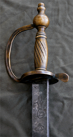

The fit and finish of this replica are very fine. Starting at the top:
* Overall, the hilt is neatly finished and very tight, with no play at all in the furniture or blade. The hilt assembly is secured by a brass capstan nut.
*Original 18th century hangers typically have a hole near the base of the pommel that corresponds to a pin on the terminus of the knucklebow. I assumed Windlass would eliminate this detail because it requires precise alignment and the time-intensive work of drilling and machining small parts. I was pleasantly surprised to find that the replica does include this feature, perfectly executed and aligned. In fact, with one exception, all hilt components are perfectly cast and aligned with one another and with the blade. The only exception was the quillon, which had been bent about 10 degrees away from a slight ding in the guard. This clearly was the result of some accident between factory floor and purchaser, and not the result of sloppy casting. The quillon was easily realigned with padded pliers. Many original hangers of this type are missing their quillons, so this may represent a weakness in the historic design. "Historically accurate" doesn't necessarily mean "good".

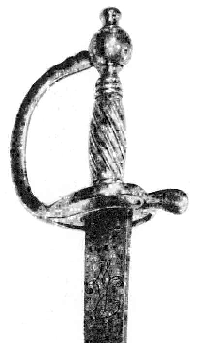

* Unlike most published examples of this weapon type, only the outboard side of the replica’s grip is fluted. I can't tell from published examples whether this is true to the type on which this particular replica is based, but it would seem strange for Windlass to overlook the accuracy of the cast grip when they've given so much attention to less obvious details of their replica. In any case, the grip of the Windlass hanger closely matches at least the outboard side of the grip of the original shown here(#E-69 in Warren Moore's Weapons of the American Revolution), and is very comfortable in the hand.
* The etching of the blade is exceptionally well executed for such an inexpensive replica, and appears to exactly match the engravings of the original shown here.
* Windlass has paid great attention to the distinctively German details of the weapon's scabbard, which features an internal brass throat, brass clip extending through the front of the scabbard, and leather extending down to cover the entire tip up to its ball finial. I don't know if any original German hanger scabbards are so complete in their coverage of the tip, but the example shown by Neumann covers only half its tip. I chose to modify the replica scabbard to match that example. I found that the tip of the blade tends to catch the edge of the internal scabbard tip. I solved the problem by bending the scabbard a bit in the direction of the blade's curvature. In retrospect, when I modified the scabbard I should have slit the leather at the tip end and inserted the tip between the two resulting layers. That would keep the leather covering of the tip and prevent the blade catching the inside edge of the tip. I'd like to know how German craftsmen solved that problem.
* The blade is perfectly finished, and oiled rather than lacquered. The flawless brass hilt does have a light coat of lacquer, and I recommend stripping the lacquer even if you don't plan to abuse and antique the hilt as I have. The lacquered finish looks cheap to me while the brass is beautiful-almost silver- if cleaned and polished with military thoroughness.
* A faux antique finish, including abuse of the hilt to produce a few pits and scratches, is satisfying because it creates a weapon that looks antique. If the antiquing is done with conscientious reference to originals, it also provides an education about those weapons, the processes of decay, and techniques of modern replication and forgery. An 18th c. British infantry sergeant might not stand for the battered finish I favor, but I much prefer its richness and depth to the look of lacquered brass. Follow this link for a discussion of the antiquing process: http://www.myArmoury.com/talk/viewtopic.php?t=1278
