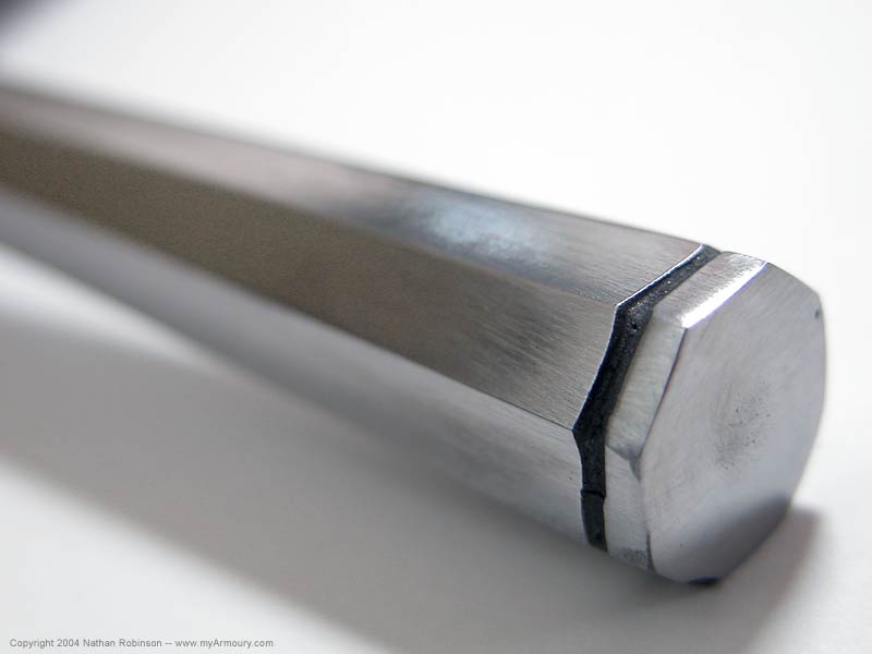

Pommel Detail

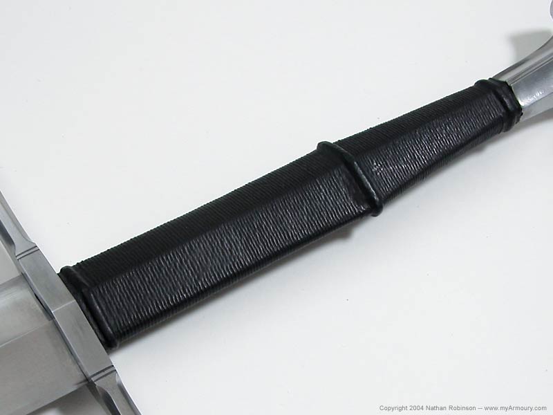

Close-up of Grip

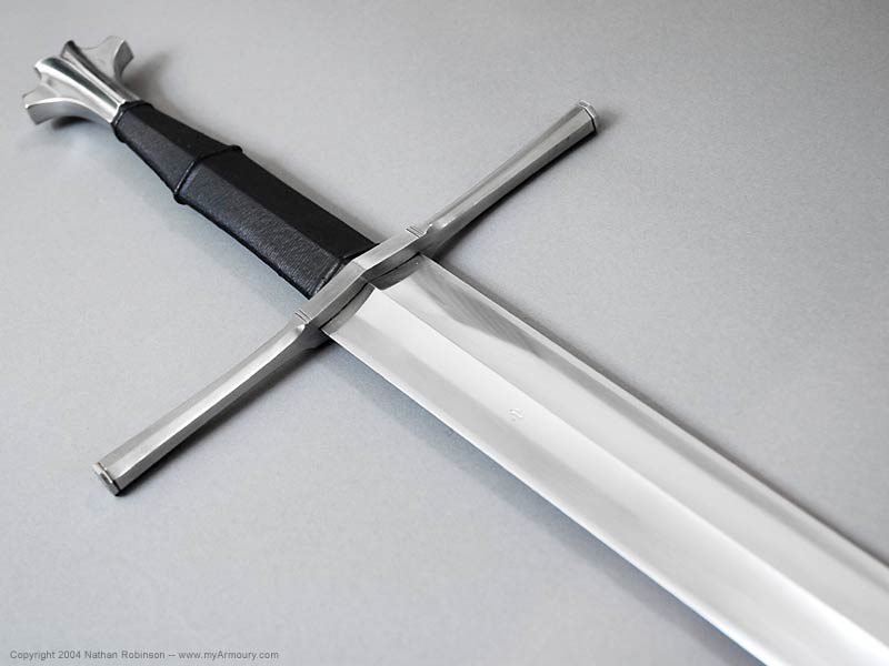

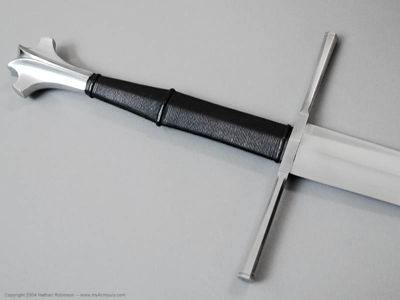

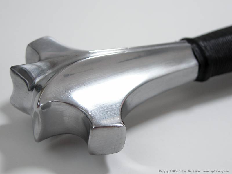

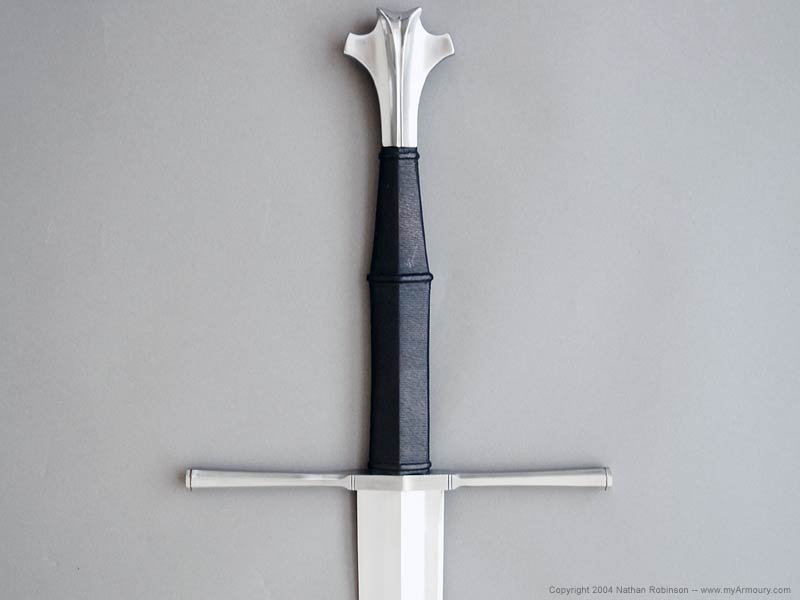

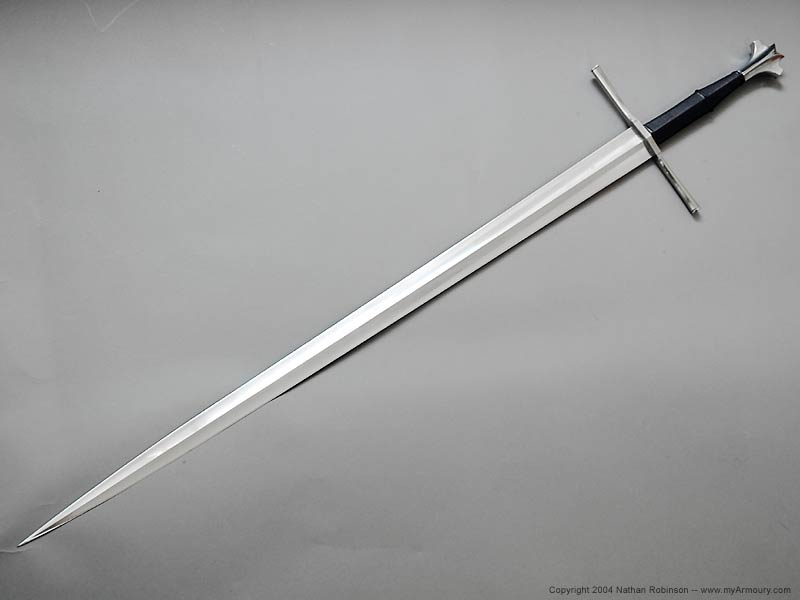

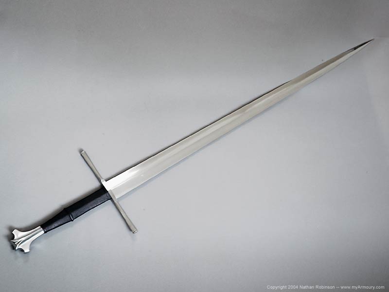

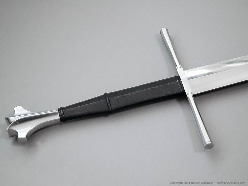

Visually, the Regent is a very striking sword. The sword's sleek lines give it an aesthetic grace that is underpinned by its brutal efficiency. The Regent's hilt components are investment cast from mild steel. The casting is very cleanly executed with only a few minor pits here and there that do not affect the piece aesthetically. Albion has made a good choice in choosing a foundry to do their casting, as these are some of the cleanest castings that I have encountered in a production sword. The Regent's pommel is of the classic "fish-tail" design. While this pommel design is somewhat rare in surviving antiques, it is quite common in contemporary artwork. Not only is this pommel design quite attractive, it is also very functional as well. The design provides for a grip that is comfortable and secure during handling. The Regent's guard is octagonal in cross-section, with slightly trumpeted ends. The guard is also decorated with pairs of simple geometric lines on its center block as well as on the tips of the guard. The sword's grip is fashioned from two halves of stabilized birch that has been hollowed out to fit over the tang. The grip has also been shaped into a hexagonal cross-section, with cord risers at both ends and in the middle of the grip. The finishing touch is supplied by a covering of black leather. The completed assembly results in a grip that is very comfortable and secure, yet at the same time quite attractive and visually pleasing.

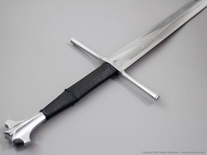

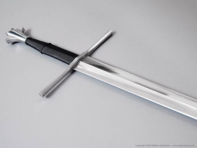

Thus far I have been impressed by the hilt construction of Albion's Next Generation line. In the case of the Regent, while the hilt is impressive, the most exciting feature is the blade, because the blade is hollow-ground. Hollow-grinding is nothing new in the field of production swords, but I believe that Albion Armorers is the only company that is doing it correctly. Several lower cost sword makers use a manufacturing process that results in a hollow-ground blade. In this case, however, the hollow-grinding is a by-product of the technique not an intentional design detail. On the other hand, the Regent is a sword that has been designed from the ground up to feature an accurately constructed blade of this type. When viewed in cross-section, the Regent's blade exhibits a distinct hollow-grind that curves deeply from the blade's central ridge. As this curvature nears the edge it begins to slope upward until it comes to within .156 inch of the edge terminus. The edge then slopes downward to its terminus, thereby creating a secondary bevel. This is the key aspect that sets the Regent apart.
While we have come to consider a secondary edge bevel to be an undesirable feature in European edge geometry, it is a key and important feature of the Regent's blade. Other hollow-ground production blades will feature a continuous slope downward from the central ridge with no secondary bevel. In terms of edge geometry, this results in a blade that is weak in terms of edge structure. This may be fine in knife design; however, this will result in a sword that lacks the needed material to support the blade's edge. The edge will then be weak, and will buckle or chip during use. The secondary bevel present on the Regent's blade provides an edge geometry that is as strong as that found on other non-hollow-ground blades. According to Albion's Master Cutler Eric McHugh, all medieval hollow-ground blades exhibit this feature. The only difference lies in the fact that the ridge defining the secondary bevel would be smoothed out on more expensive blades. For reasons of cost, Albion chose to leave this ridge visible on the Regent. I actually prefer this, as the ridge is evenly machined for the entire length of the blade. This results in a nice bit of visual detail. The blade terminates in a point that is very acute, yet at the same time adequately reinforced for use against fully armored opponents.
The blade is very evenly machined throughout its entire length. The central ridge is very straight and precise, with no wobbles or curves whatsoever. Finally, the entire sword is finished in Albion's signature satin finish. I have come to prefer this finish on all of my swords, as it is very attractive yet highly practical as well. The Regent's components of blade, guard, grip, and pommel all flow together in a beautiful harmony of design and proportion. This is a sword that looks "fast" just sitting still.
