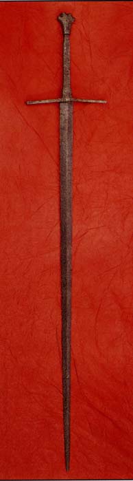

Hi all,
I am lucky enough to have filtered up on Peter Lyon's waiting list and have been discussing an XVIII.b longsword with him. Having hit a bit of a personal block deciding what exactly I want to go for, I'd like some input from the collective wisdom of myArmoury on the combination of certain styles of components.
I'm not getting a recreation of a specific historical example but I do want to end up with a sword that is accurate to the third quarter of the 15th century. Ultimately period accuracy is more important to me than any one feature of the sword so I'll flex on features if they aren't documentable.
I've settled on three things I'd really like the sword to have, a lobed fishtail pommel like the one in the attached picture, a blade like the one on the gorgeous Bayerisches Nationalmuseum XVIII.b (the Munich Sword), and a leather rain guard. The problem is that I really don't like the style of quillons that usually accompany fishtail pommels on historical examples. I don't know the Oakeshott guard styles, but they're the ones with the knobby bits on the ends, as per the attached picture and can also be seen in a non-corroded state on Albion's Tallhoffer. I dislike these enough that I'll go for a different pommel style before going with the.
This has left me at a bit of a loss as to what sort of guard might be both correct and attrative for an XVIII.b of the 3rd quarter of the 15th century that would also reasonably accompany a fishtail pommel. A flared octagonal guard with a rectangular block at the blade would work well with a rain guard, but then the finished sword would be stylistically near identical to an Albion Regent and I'd rather avoid that. Not because the're anything wrong with the Regent, I think it's a beautiful sword and I want to buy one one day, just because I wan't something different to it.
I initially wasn't particularly enamoured of "S" guards, but as I look at more examples I'm becoming more attracted to them in their simpler forms and they have the advantage of having space to engrave on which is good because I would like to get a couple of lines from the book of Ruth engraved on the guard if there's space.
The other style of straight guard I really like are the ones with the downturned tips like the "Black Prince" sword and the Bresica Spadona (though perhaps not as wide as that one). There is an example in Records of the Medieval Sword without the downturned point over the blade that might work well under a rain guard. All the examples I've seen have been no later than the 1st quarter of the 15th century, though it does look like the executioner in Memling's St John altarpiece (1474-1479) appears to be using a sword with that style of guard.
Does anyone know whether either guard type would be consistent with a sword of the period I'm looking at and stylistically consistent with a fishtail pommel, or have any suggestions for other styles that would work well?
Does anyone have pictures of extant examples of fishtail pommelled longswords with quillons other than the knobby-ended style I don't like?
Thanks.

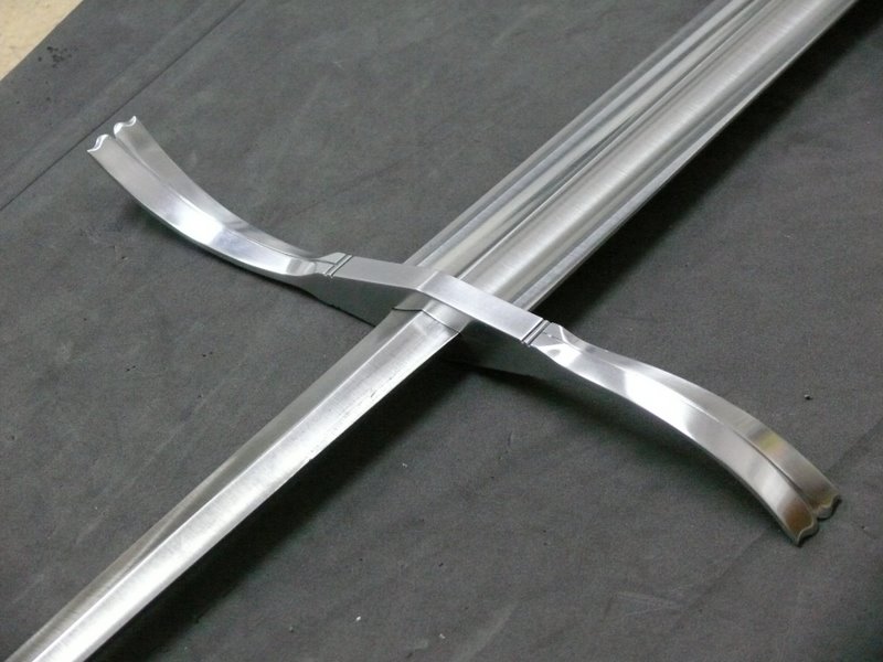

PostPosted: Tue 17 Aug, 2010 1:34 am    Post subject:         Reply with quote
And here's the finished sword. Thanks everyone for your input Happy
More pictures and stats of the sword are here:
http://www.myArmoury.com/talk/viewtopic.php?p=199222
 Attachment: 84.96 KB
Al.
http://wherearetheelves.net
Julien M
Location: Philadelphia
Joined: 14 Sep 2005
Posts: 1,093
PostPosted: Tue 17 Aug, 2010 1:44 am    Post subject:         Reply with quote
This cross guard is magnificient...congrats to both the future owner and to the Peter. The previous fishtail by Peter (the copy from the Wallace) was a splendid piece as well, so I'm looking really forward to see the final sword.
