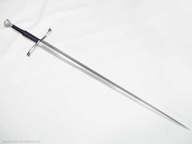

The Earl utilizes a version of the Regent's hollow-ground blade and adds a new S-shaped guard and scent stopper pommel. The blade itself is an innovative production design which took collectors by surprise when originally introduced, as hollow-grinding had previously been seen only in custom work. It is worth noting that the Earl in this review sports a revised and improved blade. Its tip is significantly reinforced, a trait that appears to make it more robust than the original Regent blade, while maintaining desirable aesthetic and handling qualities.
Click to enlarge
Weight:3 pounds, 4 ounces
Overall length:48 inches
Blade length:37 3/8 inches
Blade width:2 inches at base
Grip length:7 3/4 inches
Guard width:8 1/2 inches
Point of Balance:5 inches from guard
Center of Percussion:~22 1/4 inches from guard

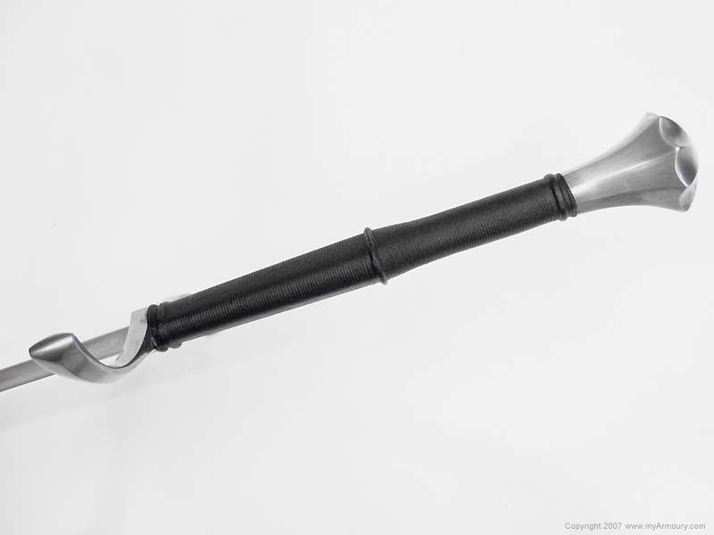

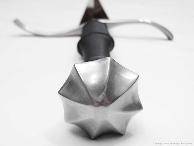

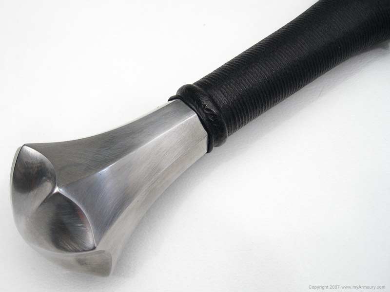

Pommel Detail
The Earl examined in this review is a bit lighter than the Regents I have been able to access, although it might not be lighter than all Regents (there has been variation from one example to the next). I feel that I can work the Earl with a single hand slightly better than I can the Regent, but not well enough to use it primarily as a single-handed weapon. When I do handle the Earl with one hand I really amplify any mistakes I make, and I'm a poor enough swordsman that I make my share of them. For me the Earl really comes alive when I use two hands.
When using a two-handed grip on the Earl, I find I'm a much better cutter than I am with the Regent, which is arguably the same blade. Perhaps it's a mental effect, but I am inclined to attribute this difference to the Earl's pommel, which is much more comfortable to grasp in my estimation. The curve of the Earl's guard also seems to allow me greater range of motion than most straight guards on other swords I have used for cutting.

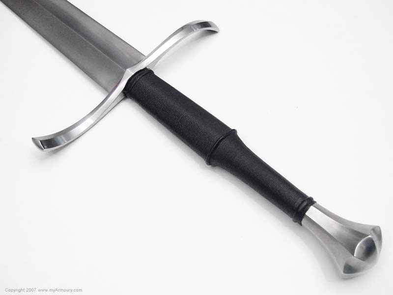

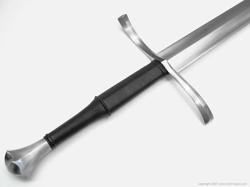

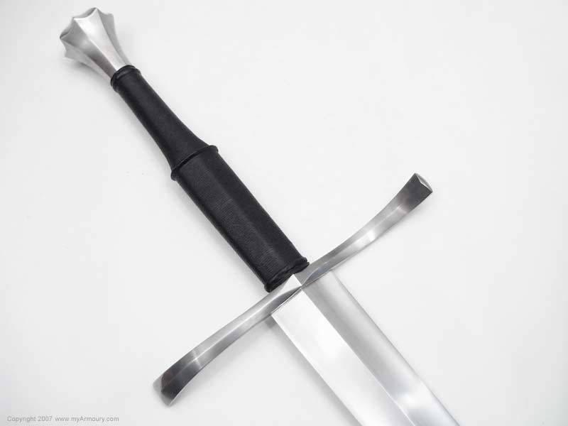

Grip and Cross

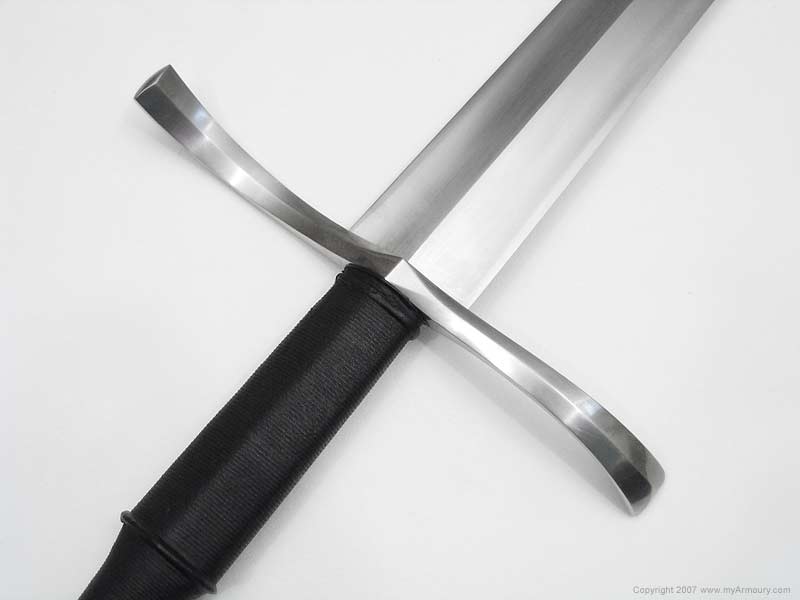

This is a very attractive and elegant weapon. At first glance the Earl seems to be a rather simple design. However, after spending some time with the Earl one begins to notice how its simple curves and surfaces are designed to complement each other, merging together to become linked design elements. They form a very elegant finished product.
The blade is evenly formed and cleanly ground along its entire length. There are no noticeable grind marks on the blade surface; the blade finish is even on all surfaces. The peen on the upper part of the pommel is neatly finished to the point of being indiscernible from the pommel proper. The guard sweeps in a gentle s-curve. Both elements exhibit a high degree of symmetry on all surfaces.
There is no noticeable pitting on any of the components. Component assembly is very tight and it has remained secure during moderate use.
